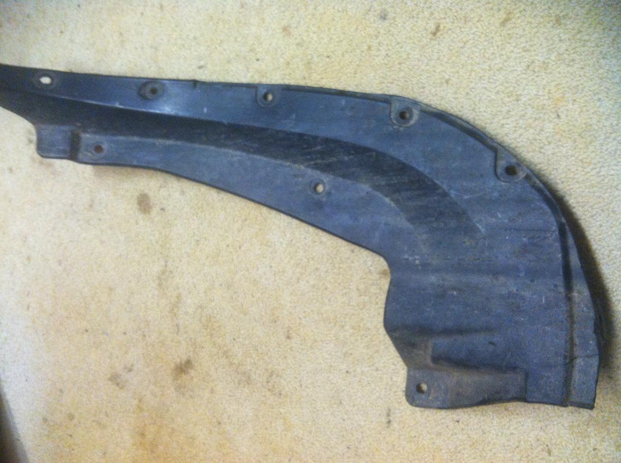

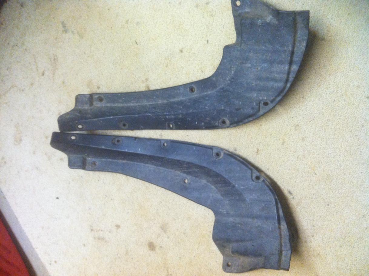

PM me your E mails, and ill send whoever wants a write up of how to trim your fenders for 285s's with a dremel
I took em off and hit them with the dremel. I spent more time than I should have but it looks amazing now. I'll post up pics in the morning!

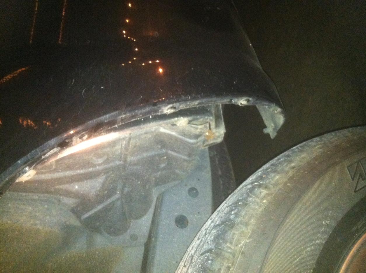

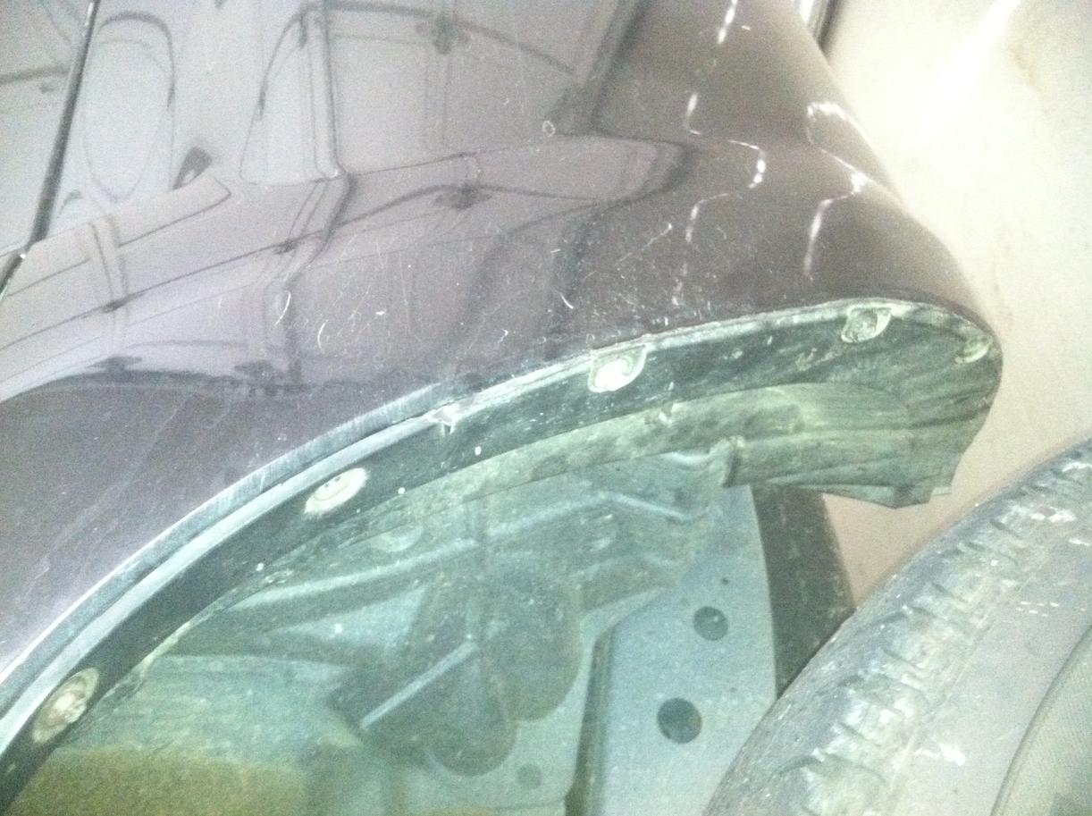

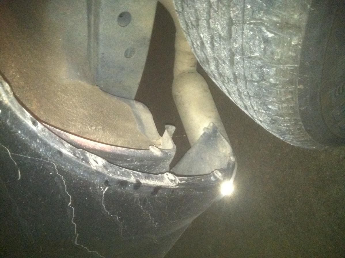

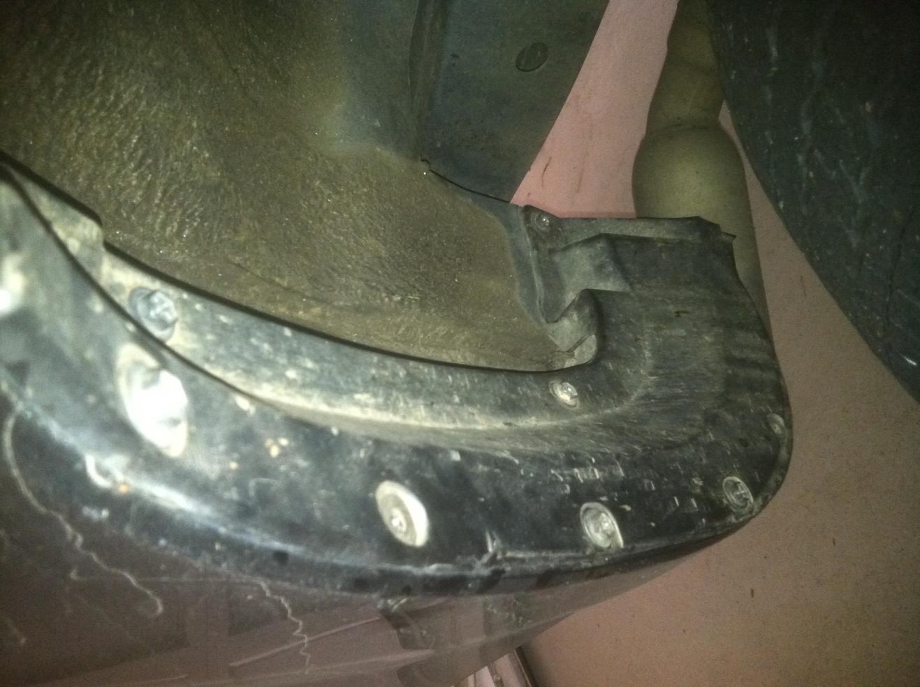

Well heres what I did, and in my opinion it looks 100 times better than not having anything there at all. it took me about 2 hours, but I wanted it to be perfect. Here they are:
