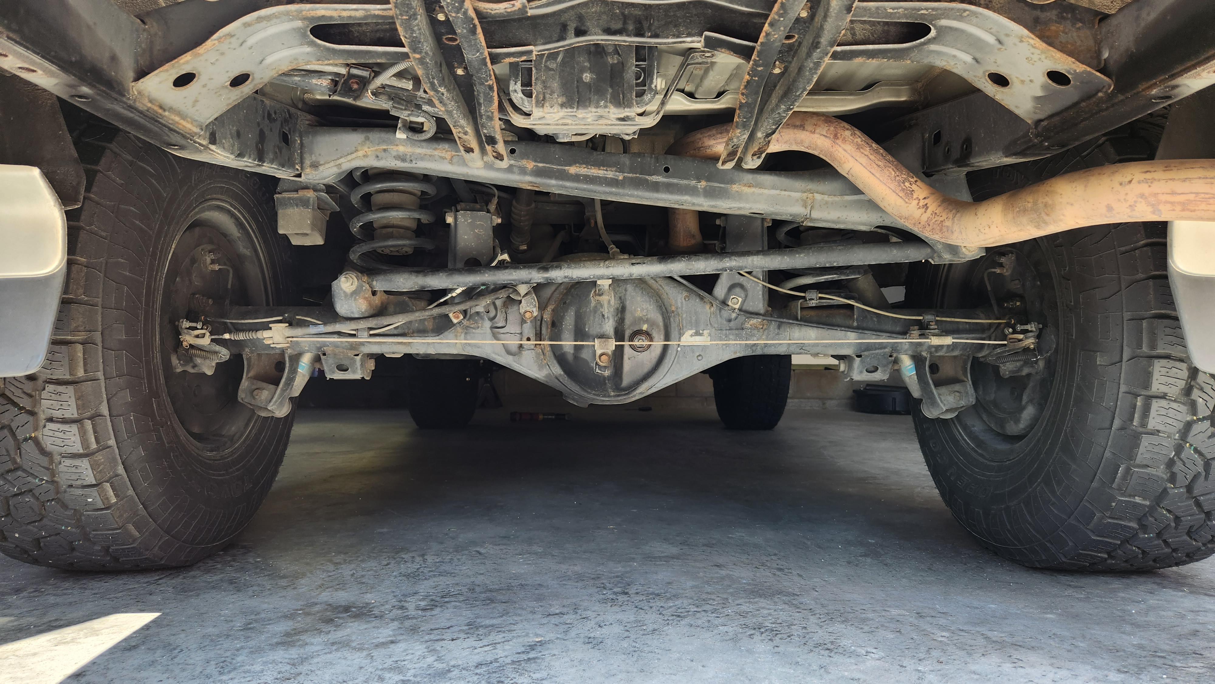

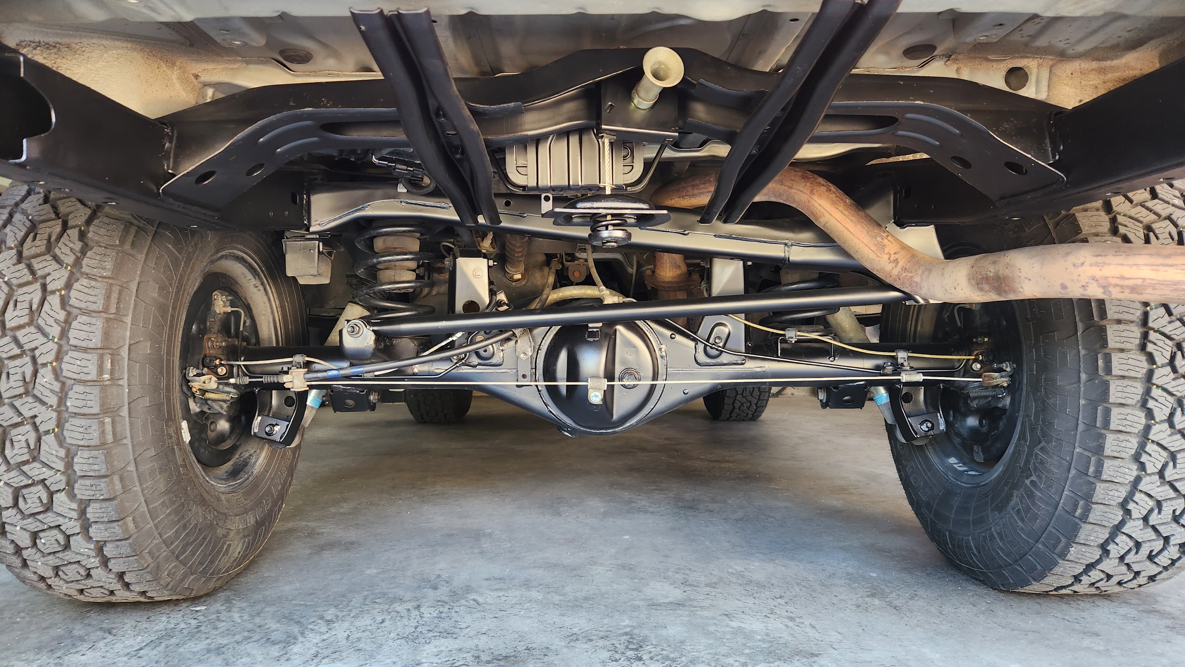

I looked like a chimney sweep when I got done with this one. Everything under the truck from skids to spare and the frame and chassis as well as all bumper bracketry have been degreased, cleaned up, and a fresh coat of satin black paint applied. It all looks brand new. Replaced any bolts that looked bad as well with brand new factory Toyota bolts and coated the threads with anti seize before I put them in. Put some Rust Reformer on the back of the chrome bumpers for the surface rust and hit that with some satin black as well.
Video in third post. To do list is getting pretty short now.
Next up will be a refresh of the interior.
Before
After
I feel better knowing it's all sealed up and protected.

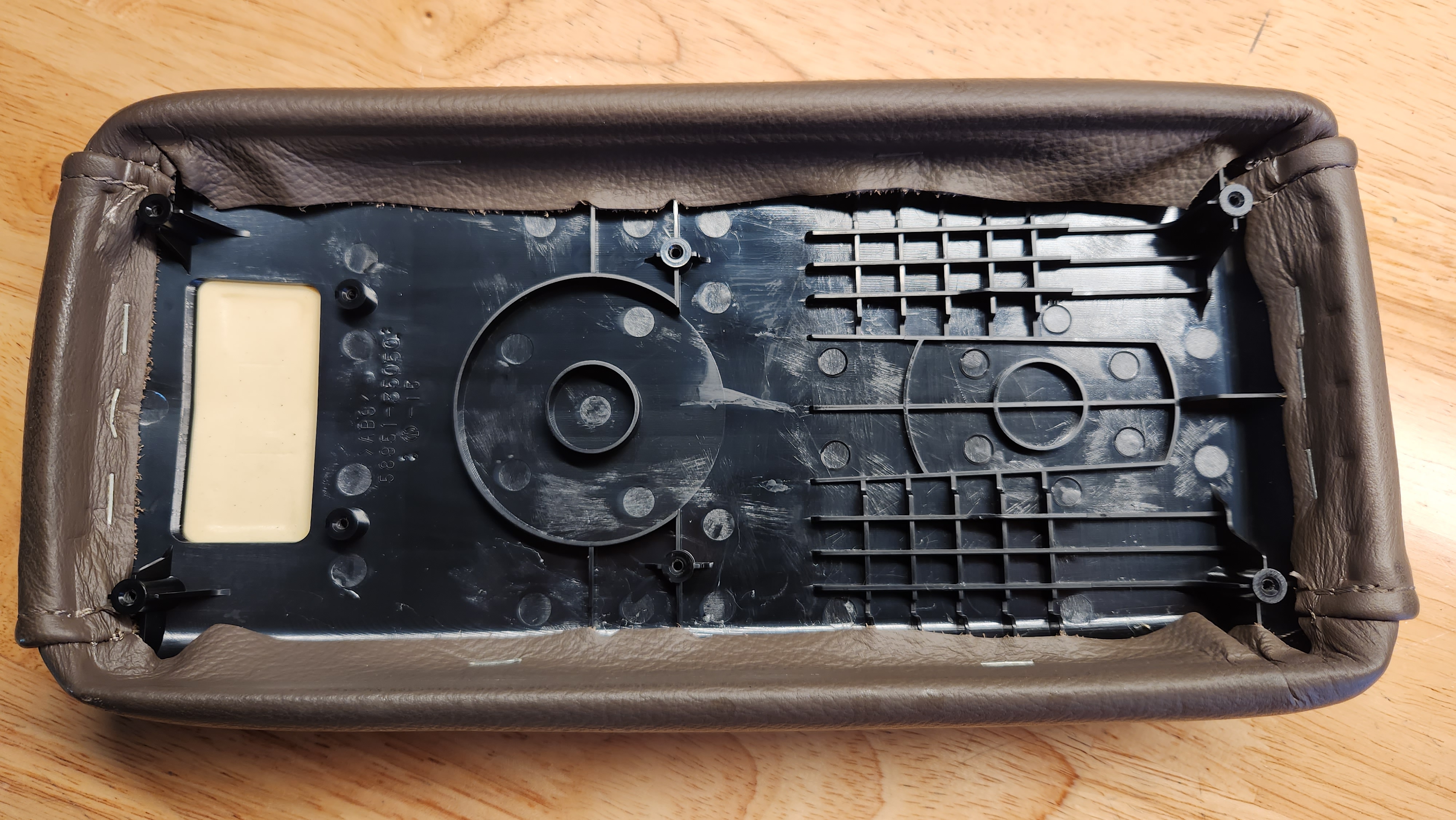

In the mean time I disassembled the console to install the new leather cover from JF Customs on Ebay. Again I HIGHLY recommend them, super good to work with and the cover is actual leather and high quality at that.
Once I got the console removed/disassembled (easy) I realized it takes a special staple with a 3mm leg. This is a very short staple to avoid going through the thin plastic when stapling the leather to the console lid and isn't a standard staple. My console also needed a bit of a beef up in padding and I planned to use some 1/4" thick neoprene for that and some spray adhesive to put it all together. Finding a pneumatic staple gun for the special staples turned into a bit of a project and cost for something I'd likely use one time. I considered adding some leather or vinyl strips to the back side of the console lid to allow for use if the 1/4" staples but meh.

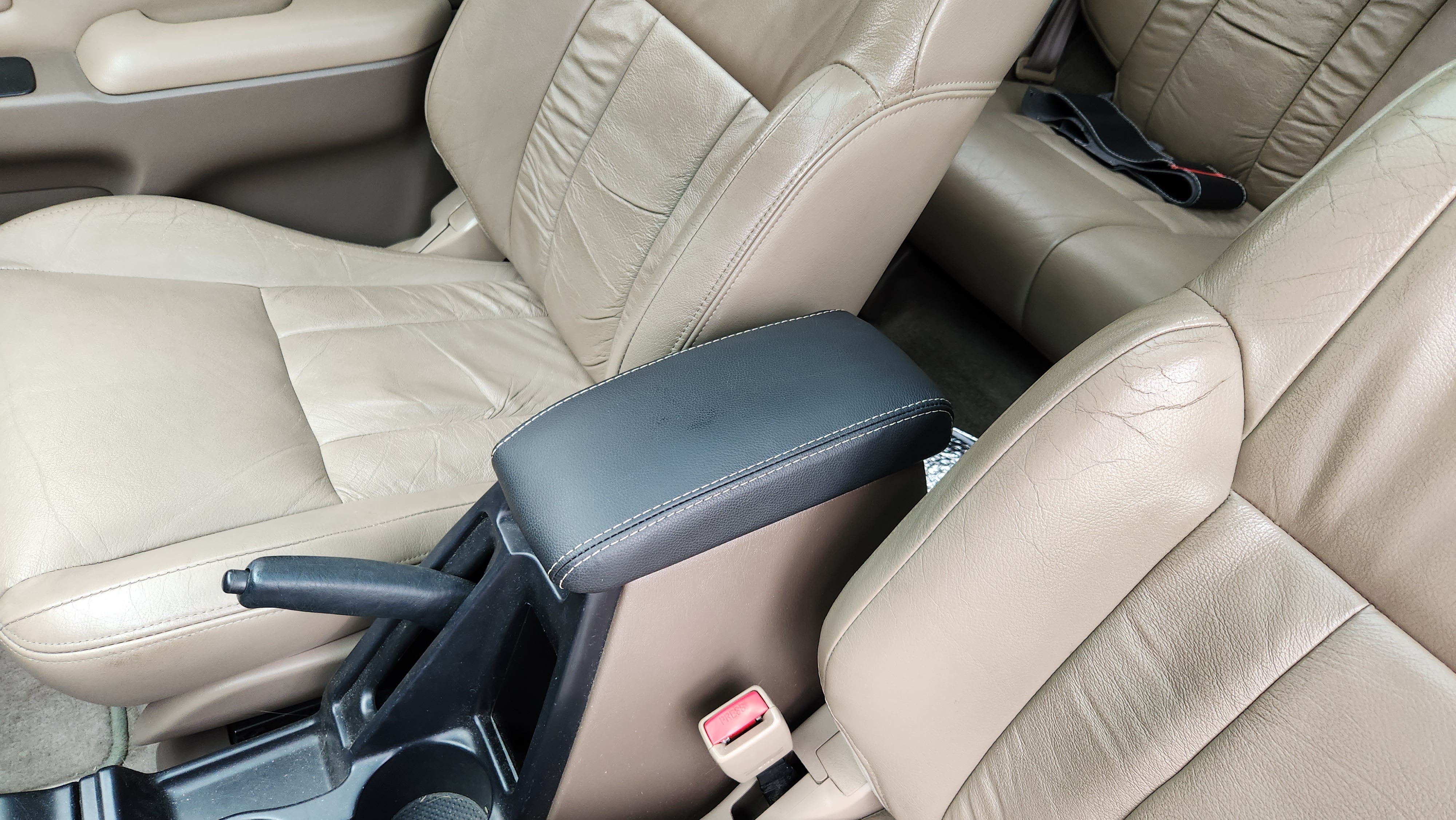

I went by the upholstery shop I'm going to have install the custom leather when it arrives to ask what they'd charge me to put the console cover on. Free was the answer since it was such a simple job and they'd add the necessary additional foam to boot. Got it back and it looks great. Can't beat free. I'll buy the guy lunch when he does the seats as a thanks.
Next up will be the new interior and I can't wait to see how it looks.
I still have extra JF Custom console covers. If you can use one lemme know, cover shipping and it's yours.
I got the JF Customs console cover black with tan stitching and I think it looks pretty good with the oak interior.

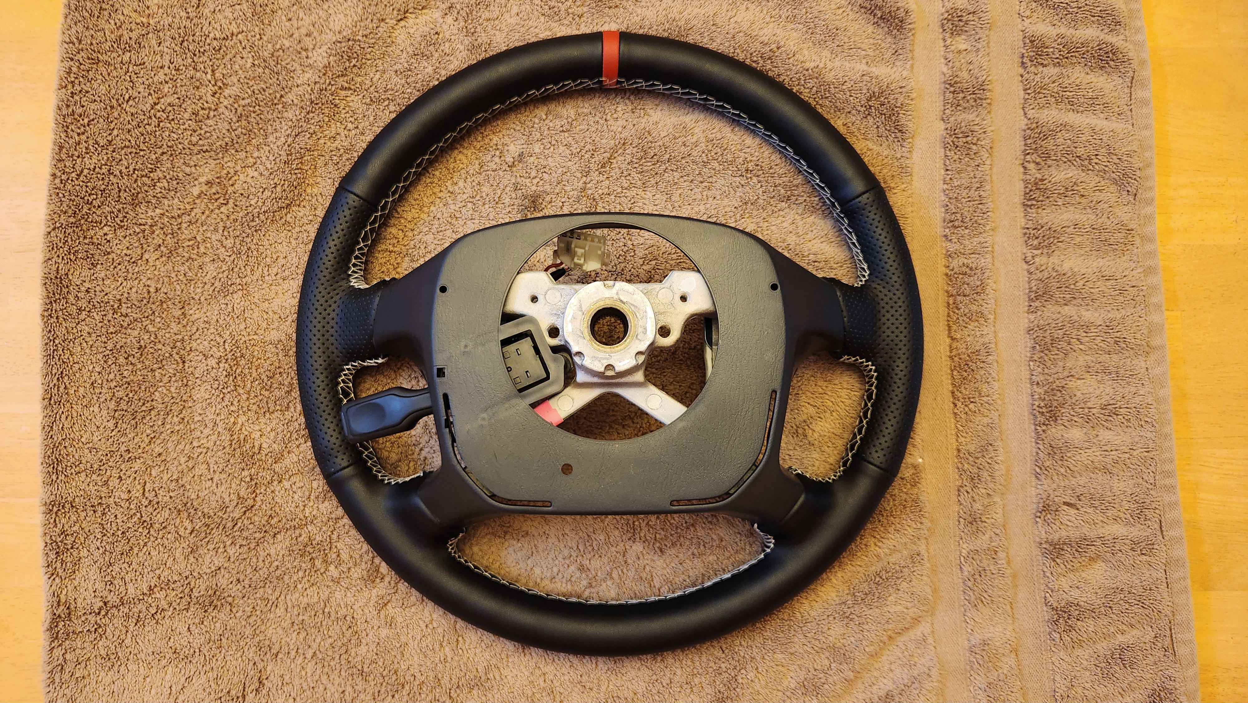

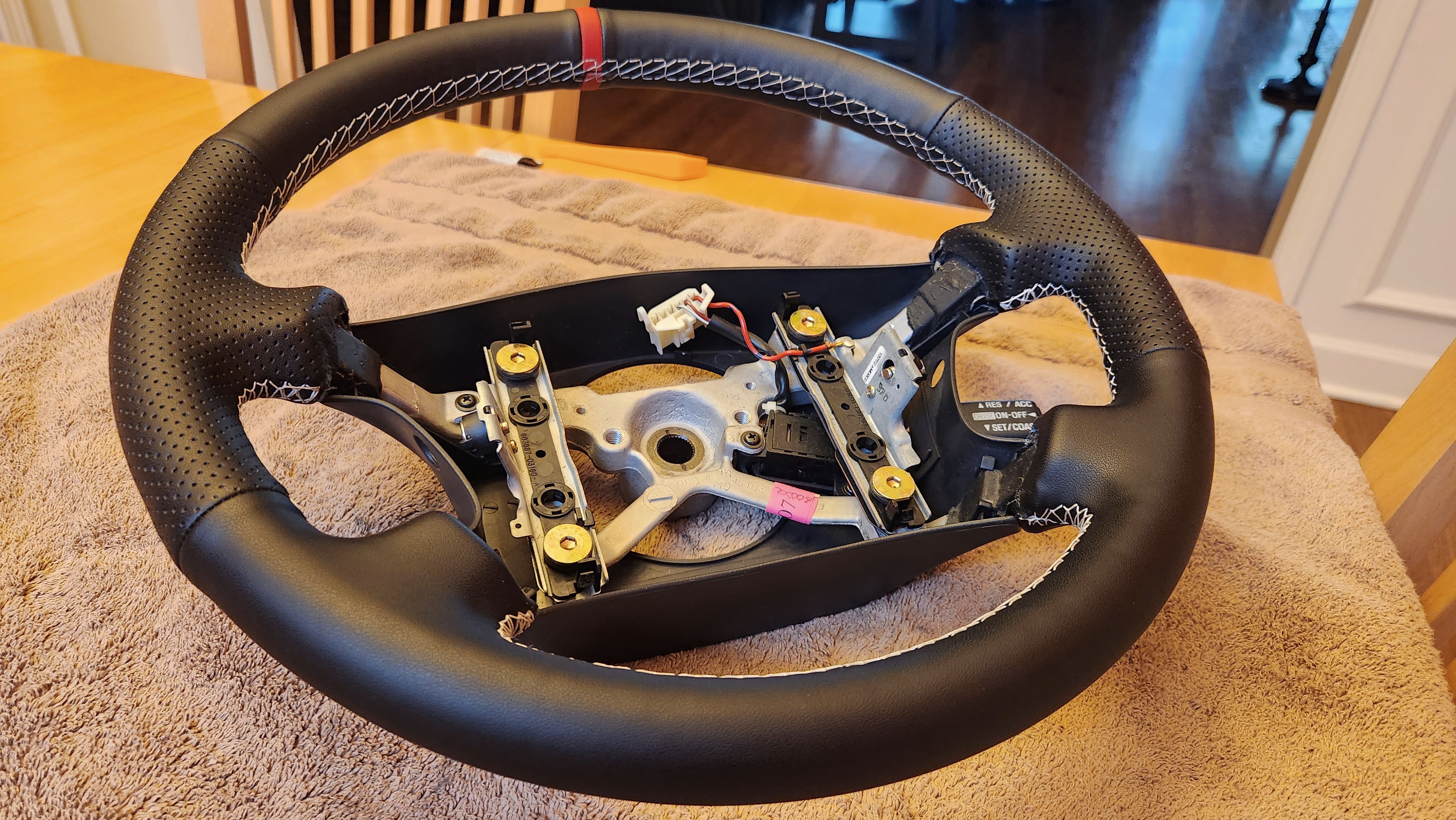

cover installed

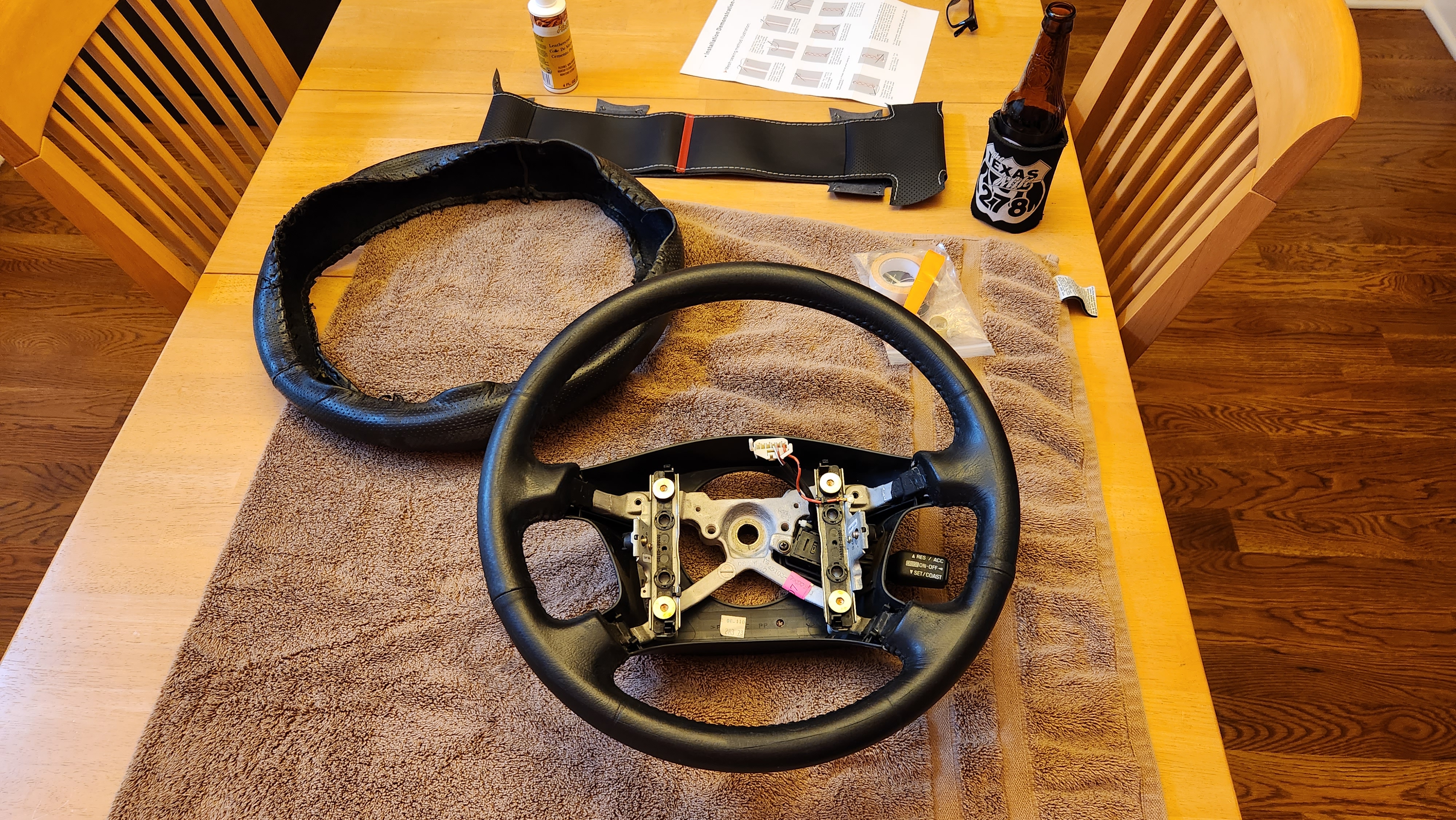

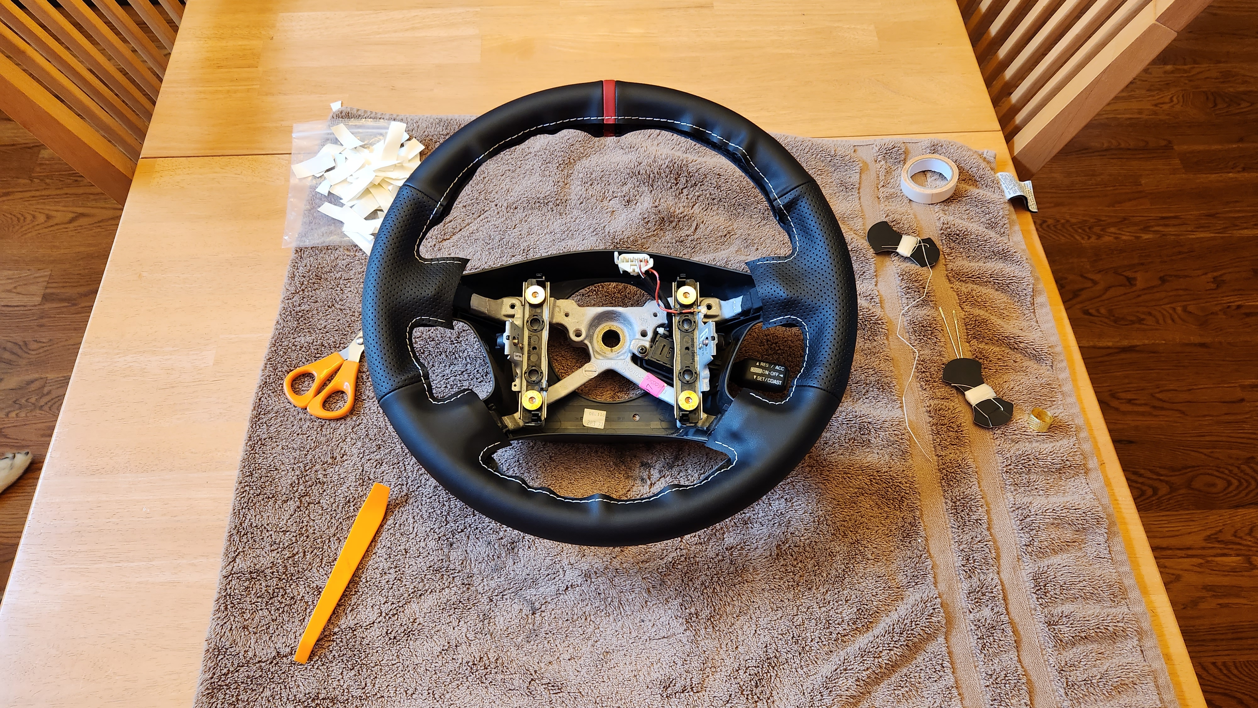

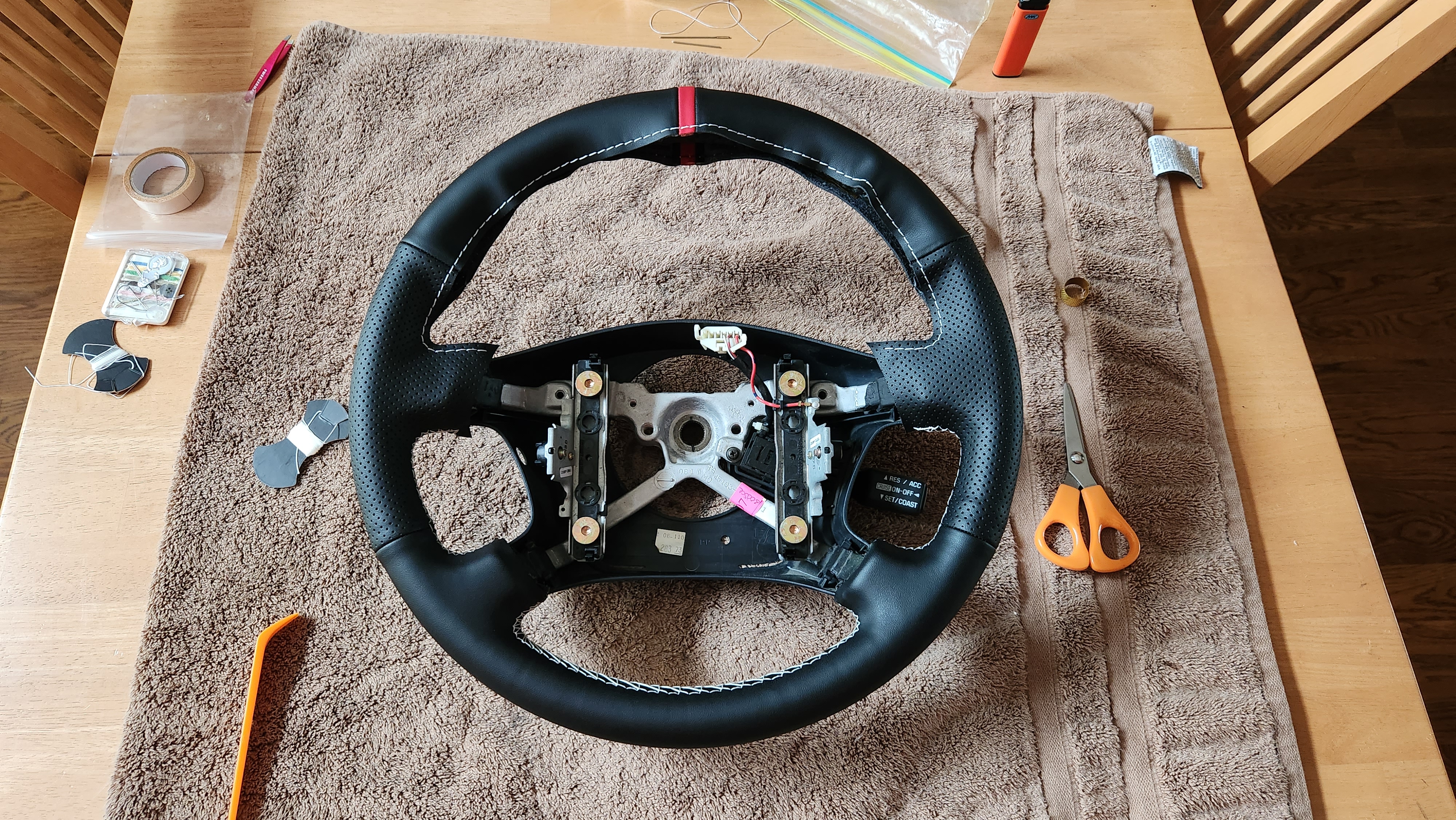

I've started installing my East Detailing cover. It's quite a bit different from yours so probably explains the price difference. Mine looks to fit a bit better especially around the spokes (goes all the way down the spoke like factory) and has a very nice contrast stitch.
I expected the install to be harder to be honest. I'm kind of enjoying it. Relaxing.
Finished up the steering wheel and it came out amazing. I highly recommend the East Detailing cover. I found this a very easy project personally. Now to check on where my new interior is. I thought it might be here this week but no dice.

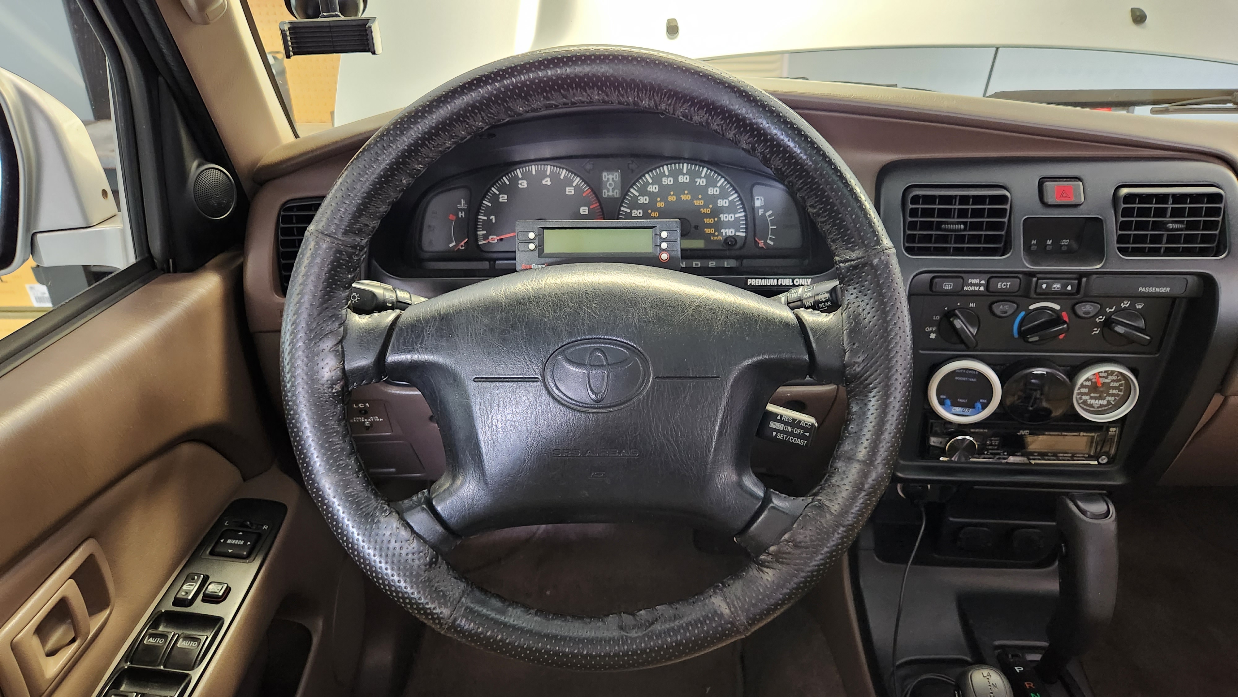

Before

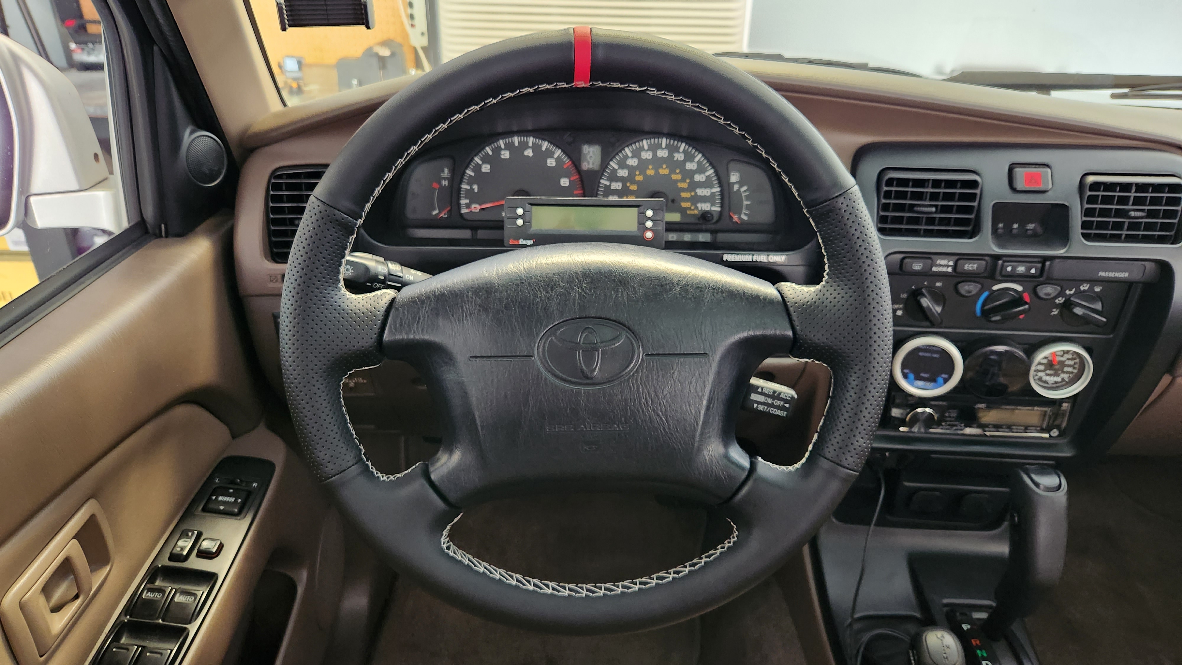

After
Fit is as good as factory.
Great job on the steering wheel cover... I am happy with none ripped covers... :D. In my repair. I will just be swapping steering wheels and calling it good...:]
