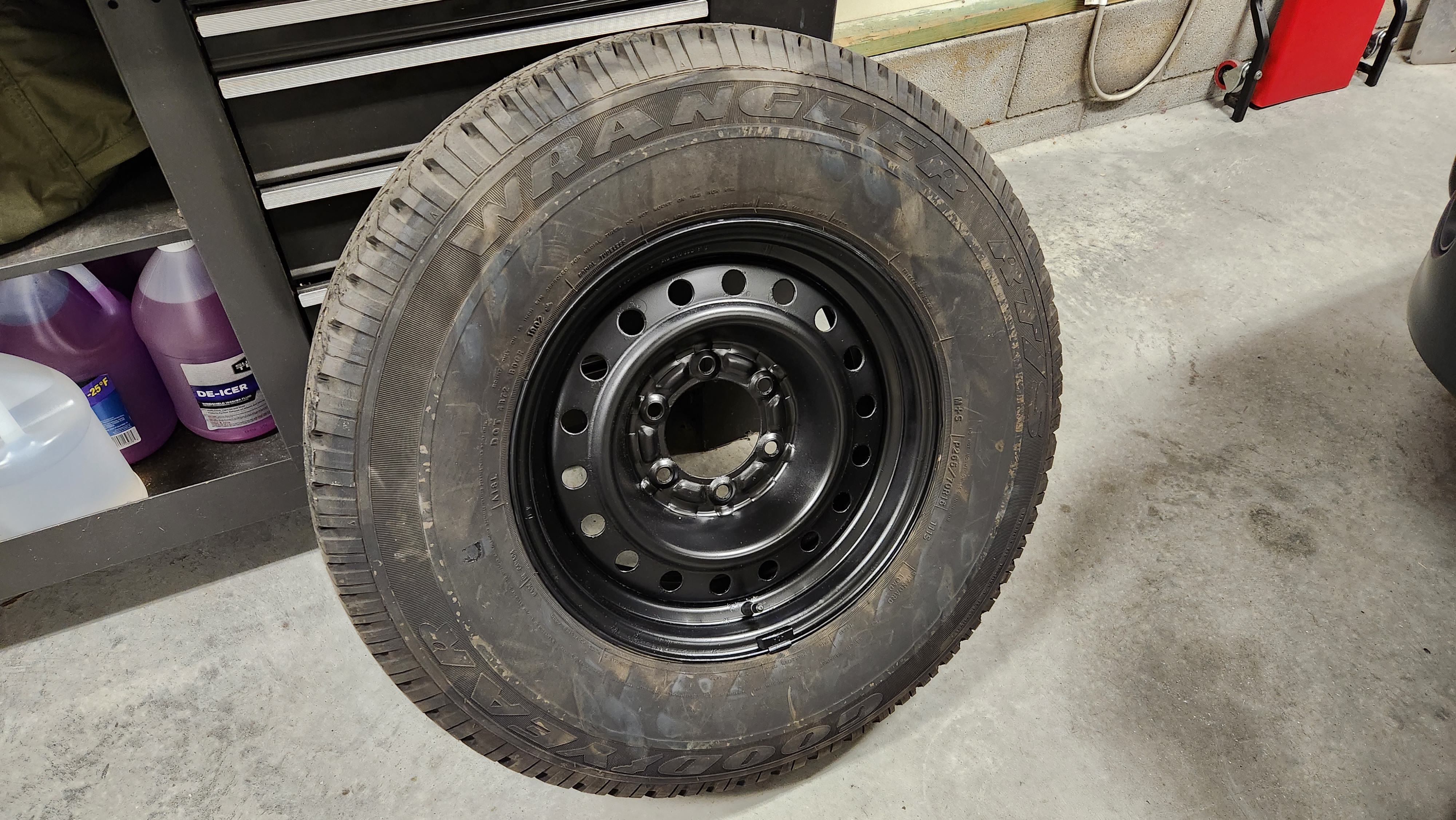

I try to verify pressure as all mine are aluminum, not original spares. So every 5 to 10k miles I drop it down and verify it good psi. :)
Sent from my SM-A536V using Tapatalk

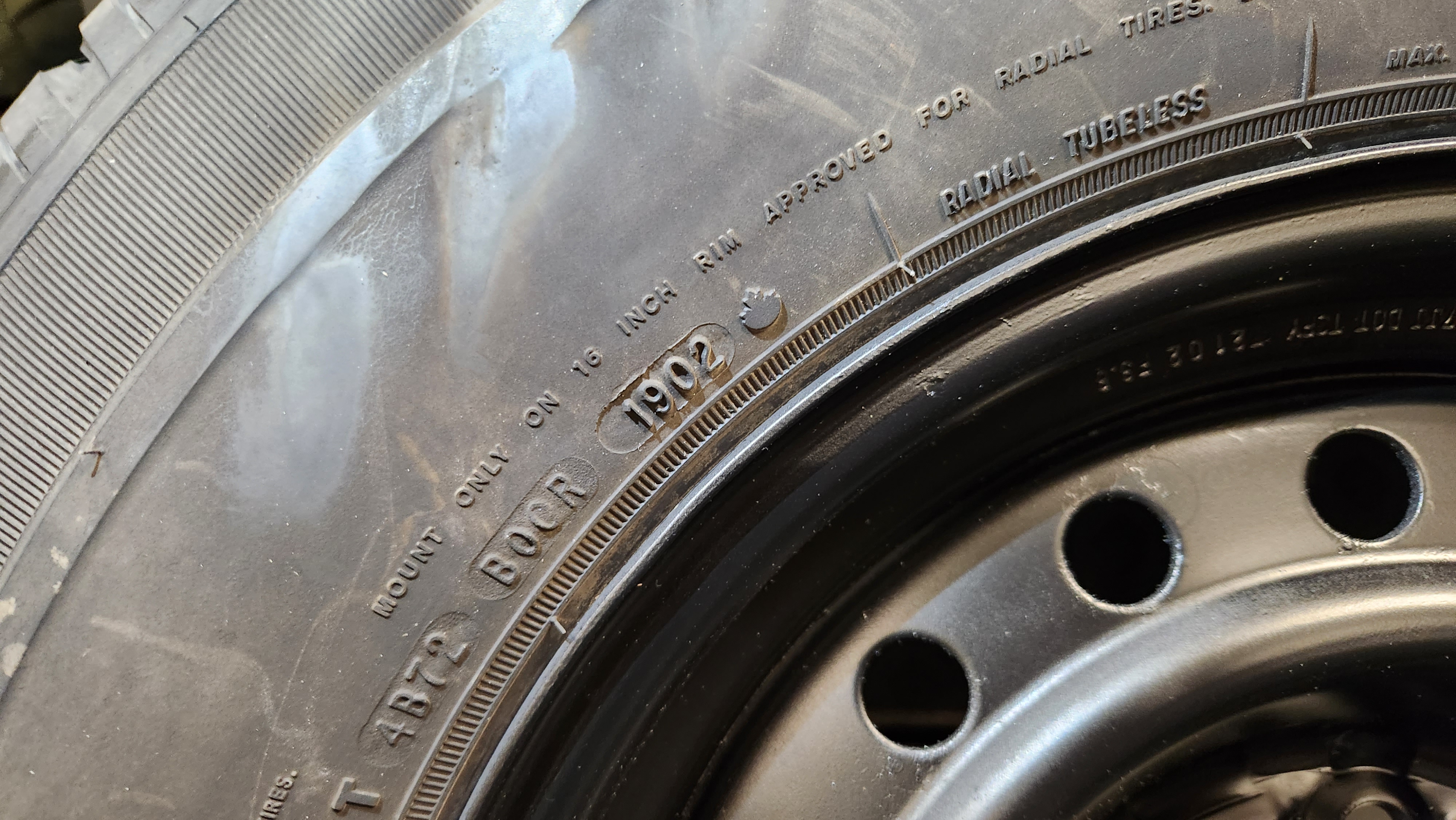

Anyone have a habit of checking their spare for air pressure? I had honestly forgotten all about it and mine was dead flat. Original tire from 2002, I may need to look at finding a used "newer" tire for that just in case scenario.
But can we just talk about how CLEAN that spare wheel is?! Good grief dude! Lol
It easy to keep things nice living where [MENTION=8729]Speedy[/MENTION] n I do, I'm +- 4 hr SSW.
Mine is untouched showing a bit of rust bubbles around hub opening.
As far as finding a newer used spare, do you really need to?
What ever gives you the fuzzy's, Mine are just there dark corner of garage mostly.
3rd Gens 400k+ plus miles 23 yrs never needed it, 10 ply MT's or ATs :)
Out of state wheeling see's light of day, it way down my list.
I'm more likely to pick up a nail and get a flat than anything. Wouldn't want my wife driving very far on a 20 year old tire.

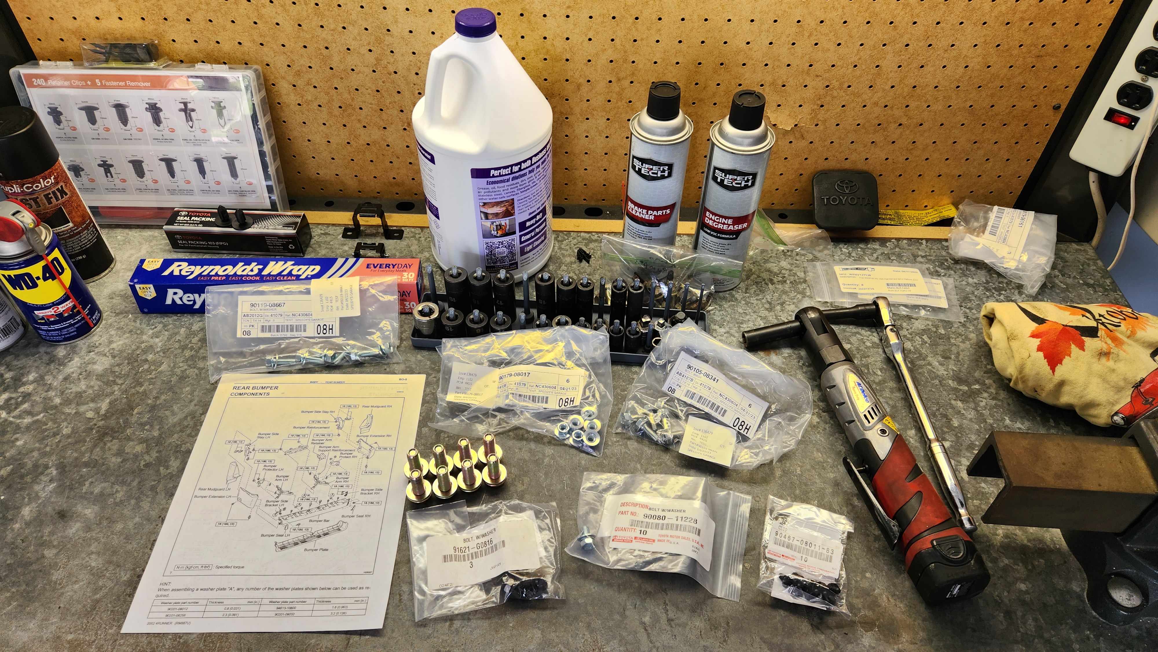

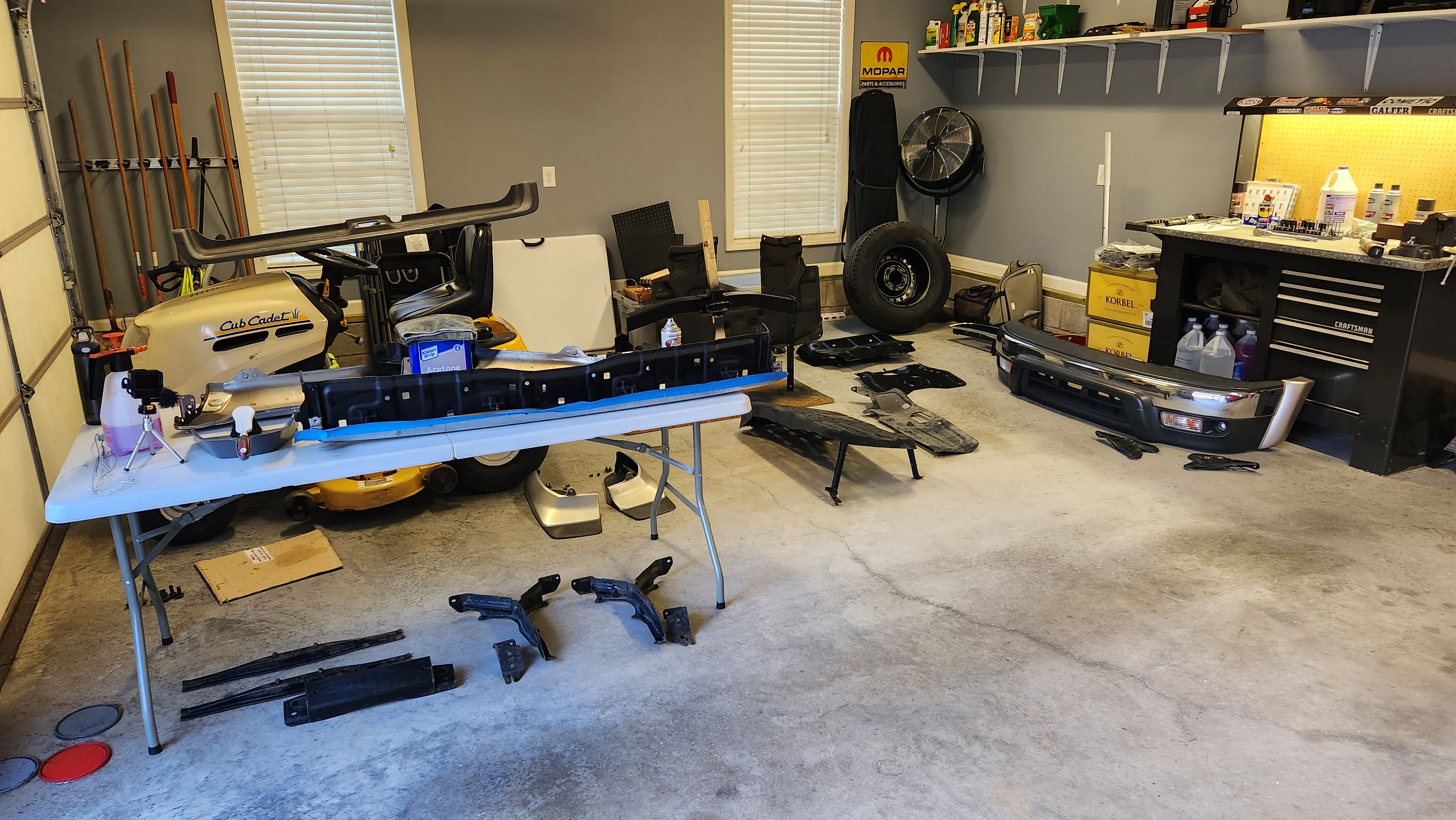

Spec sheet printed, new order inventory check, what/how many goes where with torque spec, tools at hand.
I call that ready mid TN shouldn't have problems getting old stuff off.
The hitch bolts and rear bumper area were my biggest concerns, soaked them in Liquid Wrench and so far so good.
PBblaster liqwrench all you need our neck of the woods most jobs in no problem category.

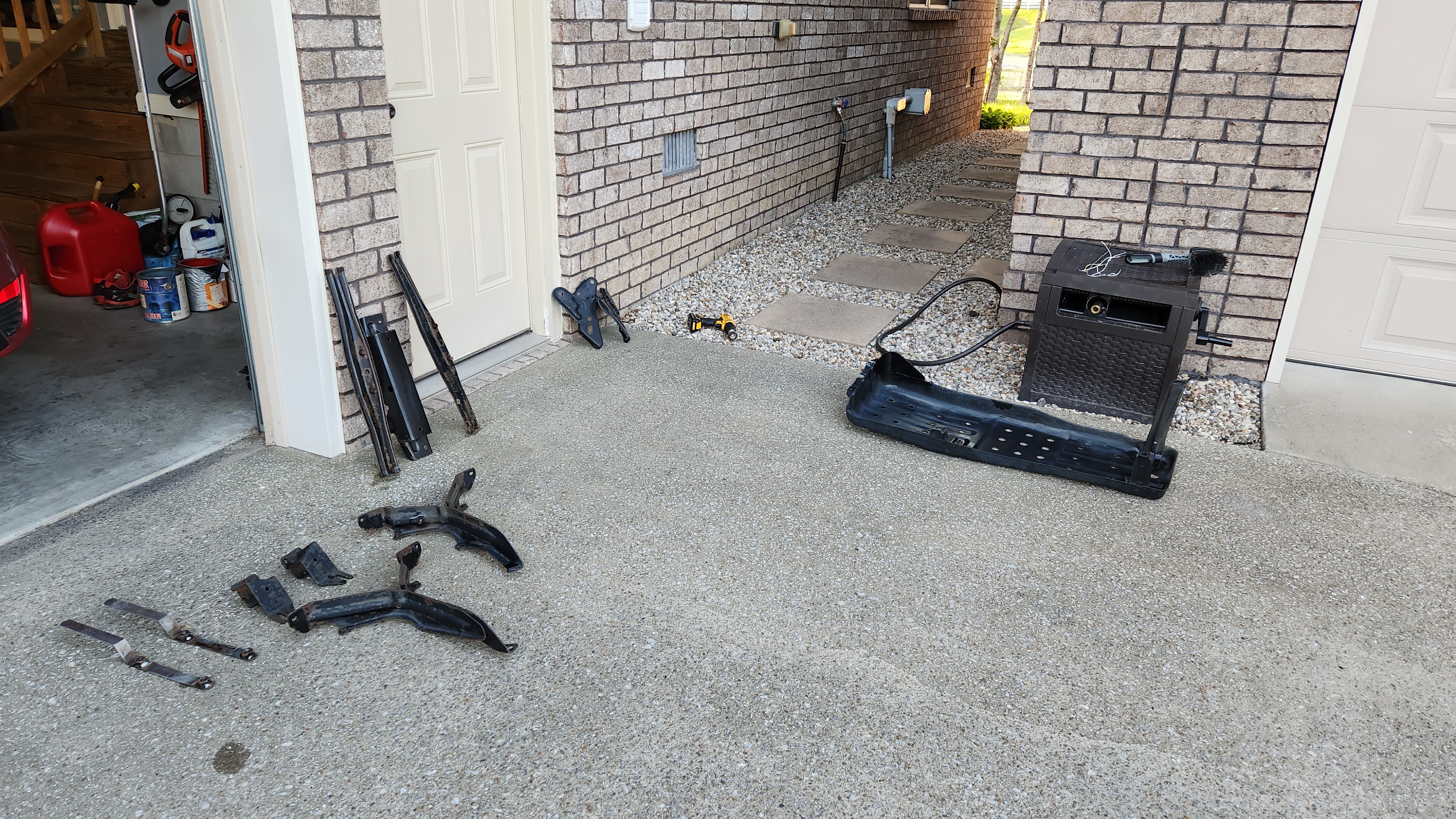

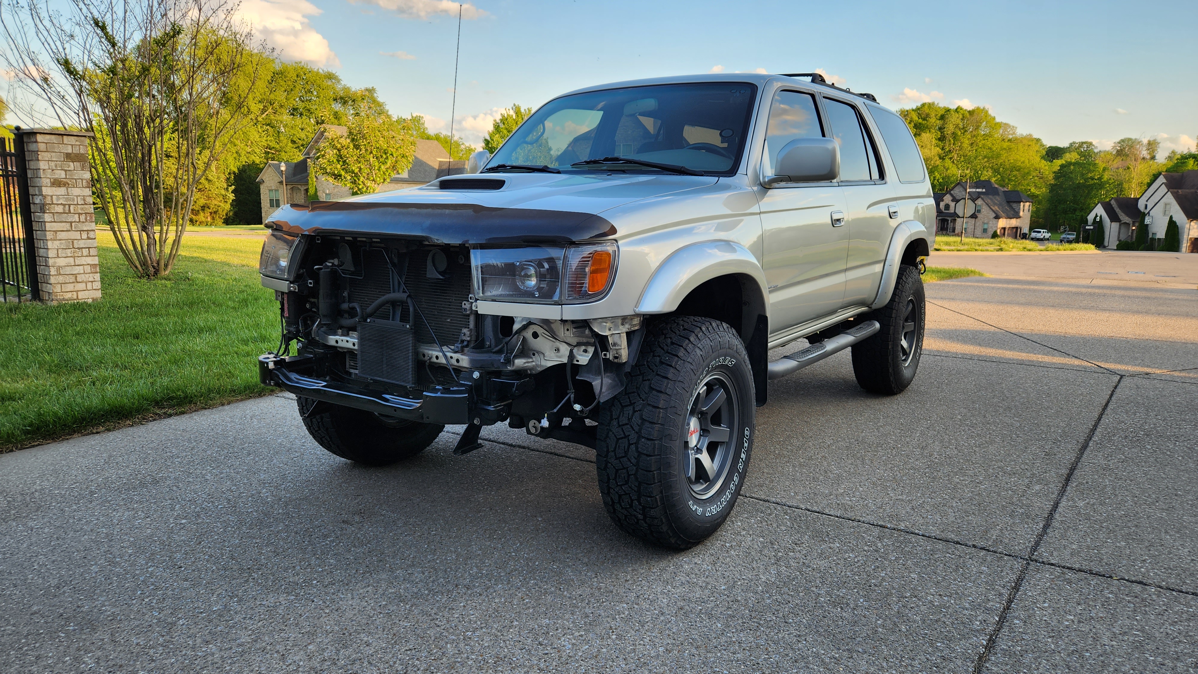

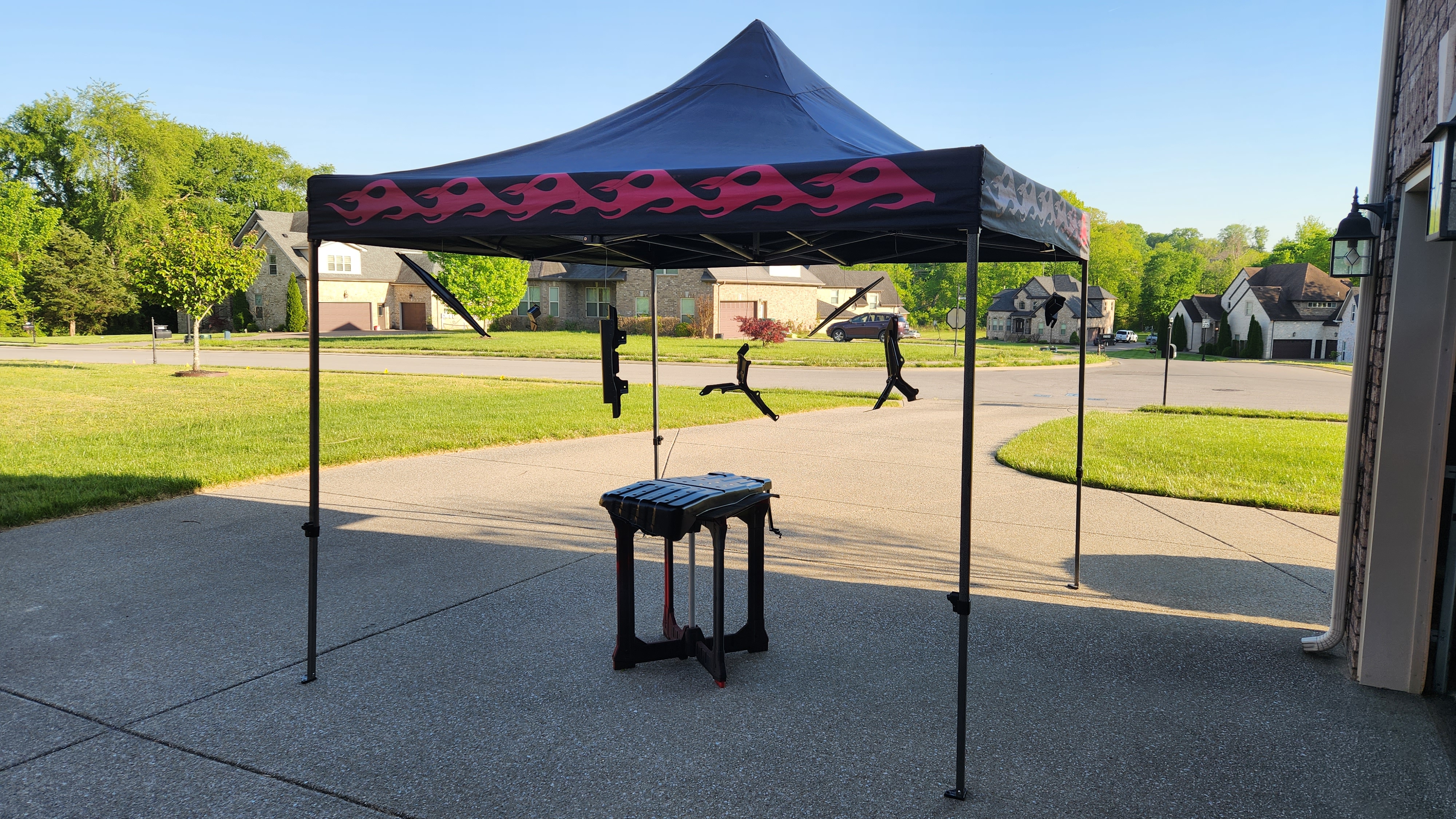

Been busy. Disassembly complete and parts cleanup and painting is in process. I'll be glad when I'm done here. Next up is the actual frame itself.

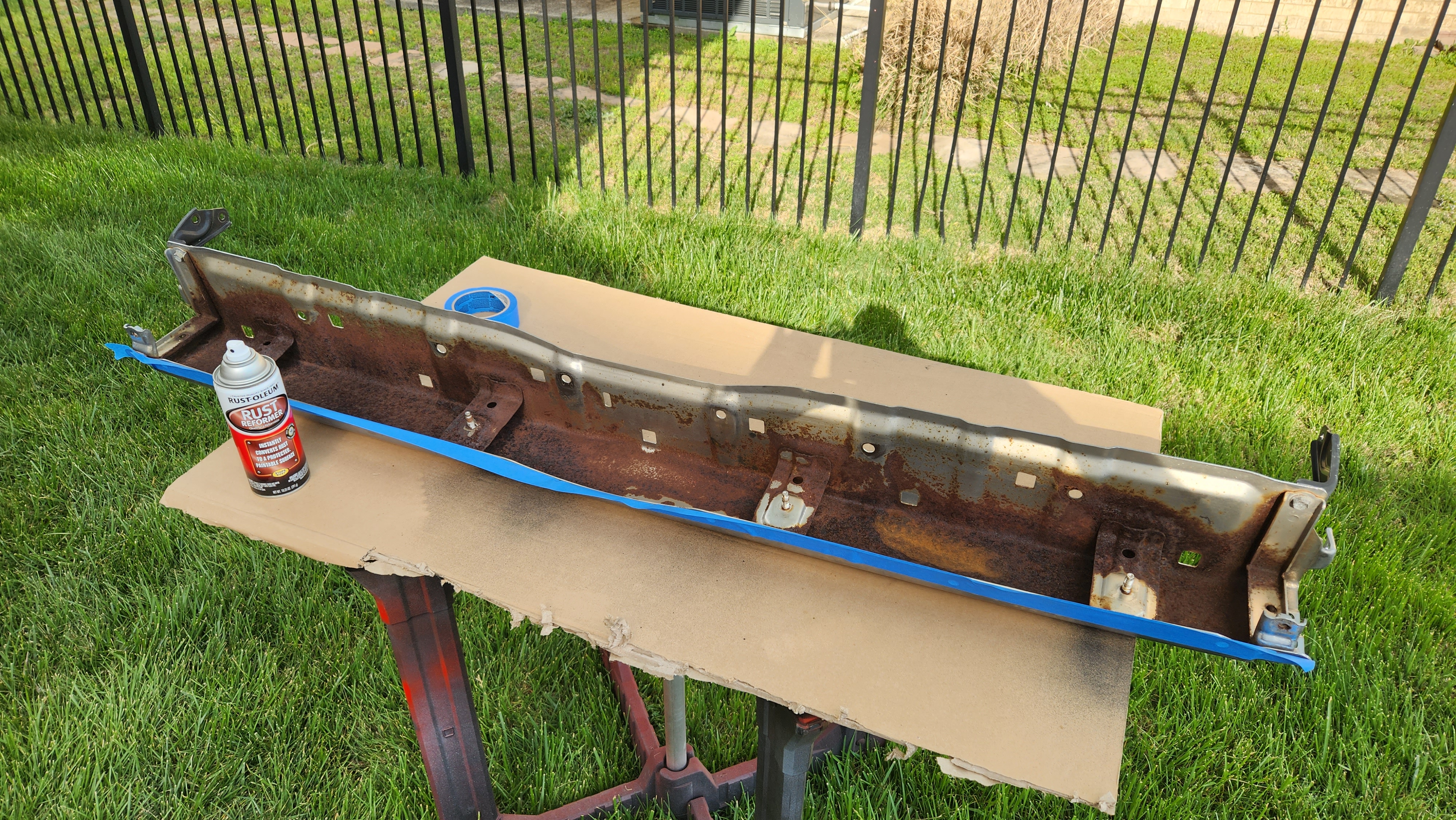

Inside the rear bumper is about the only thing that had any rust to speak of. Wire wheeled that real good and hit it with some Rust Reformer and after it dried 24 hours top coated with some Rustoleum Satin. I may end up ditching the chrome but will shore it up for now. I'd like to get some paintable bumpers and shoot them to match the wheels.
Pressure washer has been getting a work out.

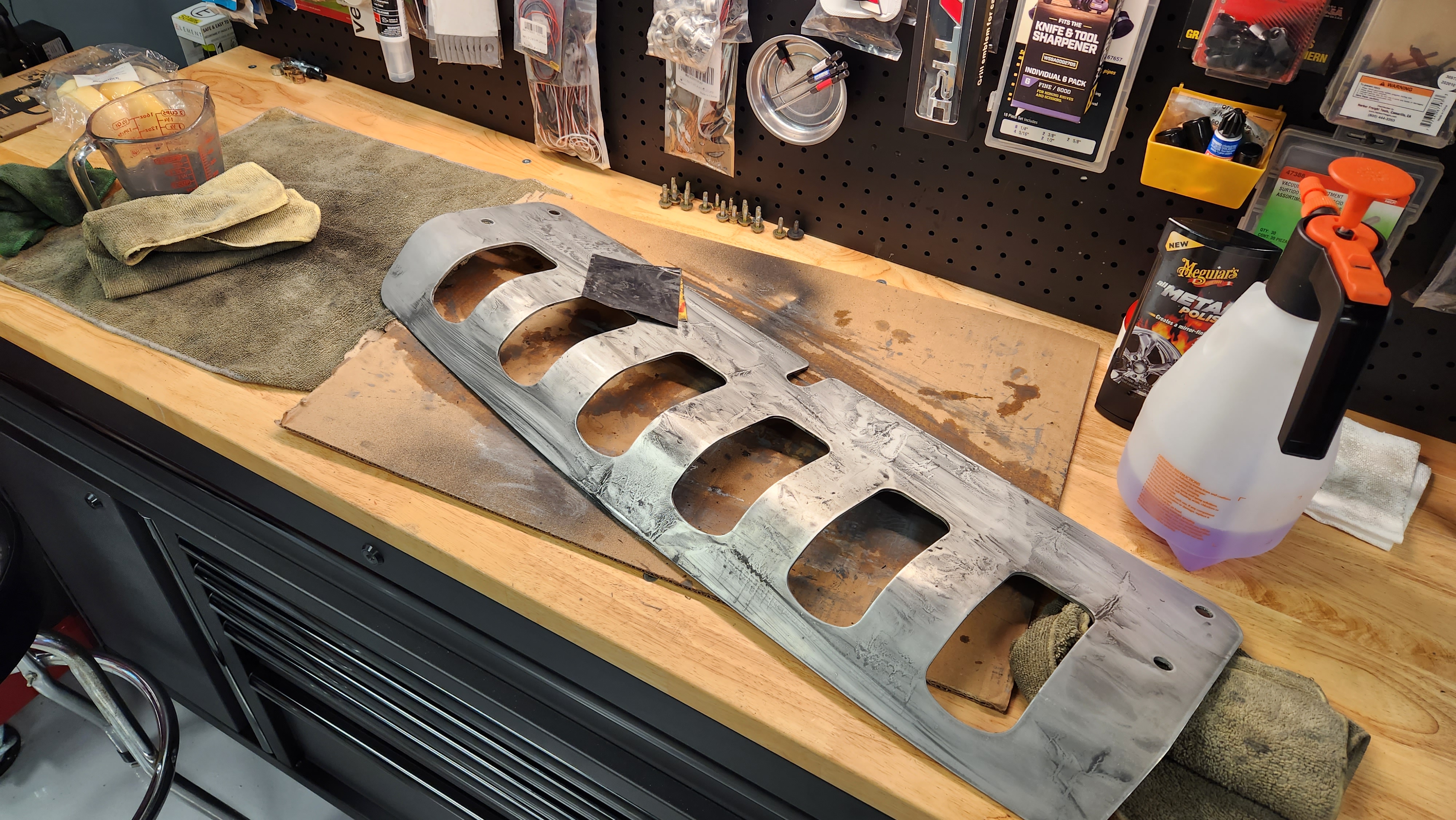

About ready to start re-assembly. Finishing up with some 400 grit wet sanding and a light polish on the sport skid plate to remove years of oxidation.
I don't want it shiny, just satin like it was originally and so far so good. Not too hard to clean it up.
