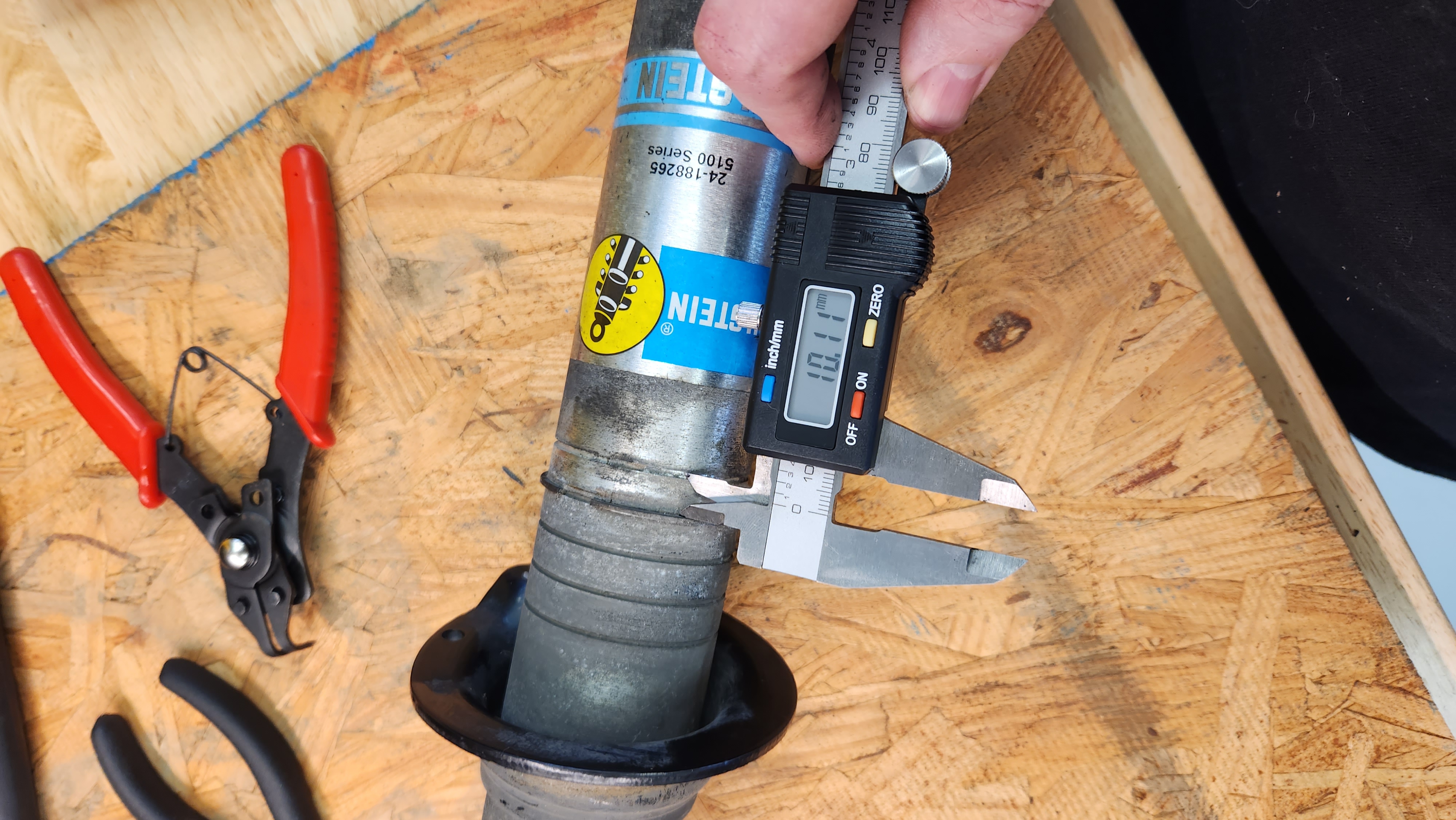

Got the Bilstein 5100 suspension adjusted this week. Moved up one perch from bottom to 2 on the shocks to level things out in the front. It was a PITA. I have to be missing something. Removing the struts took like 10 minutes, getting them back in like 90 minutes each with a lot of swearing, long pry bars, and praying something didn't slip and chop off my fingers putting in the lower shock bolt.
Third post has video. Good news is that's done, the truck is level, and it rides fine.
Didn't watch the vid. I have found the best spot for the pry bar is over the upper a-arm, then below the pivot bolt sleeve. Lots of leverage and out of the way of the rest of the suspension with little chance of slipping. One arm pulls down on the bar, the other uses a tool too align the lower bolt then insert it.

If that's the case, you should have the pivot bolts (adjusters) loose too. Then you just lift the arm up by hand...
-Charlie
That must be the missing link for me. I left the A arm pivot bolts tight on both installations and those bushings must have been in a bind.
