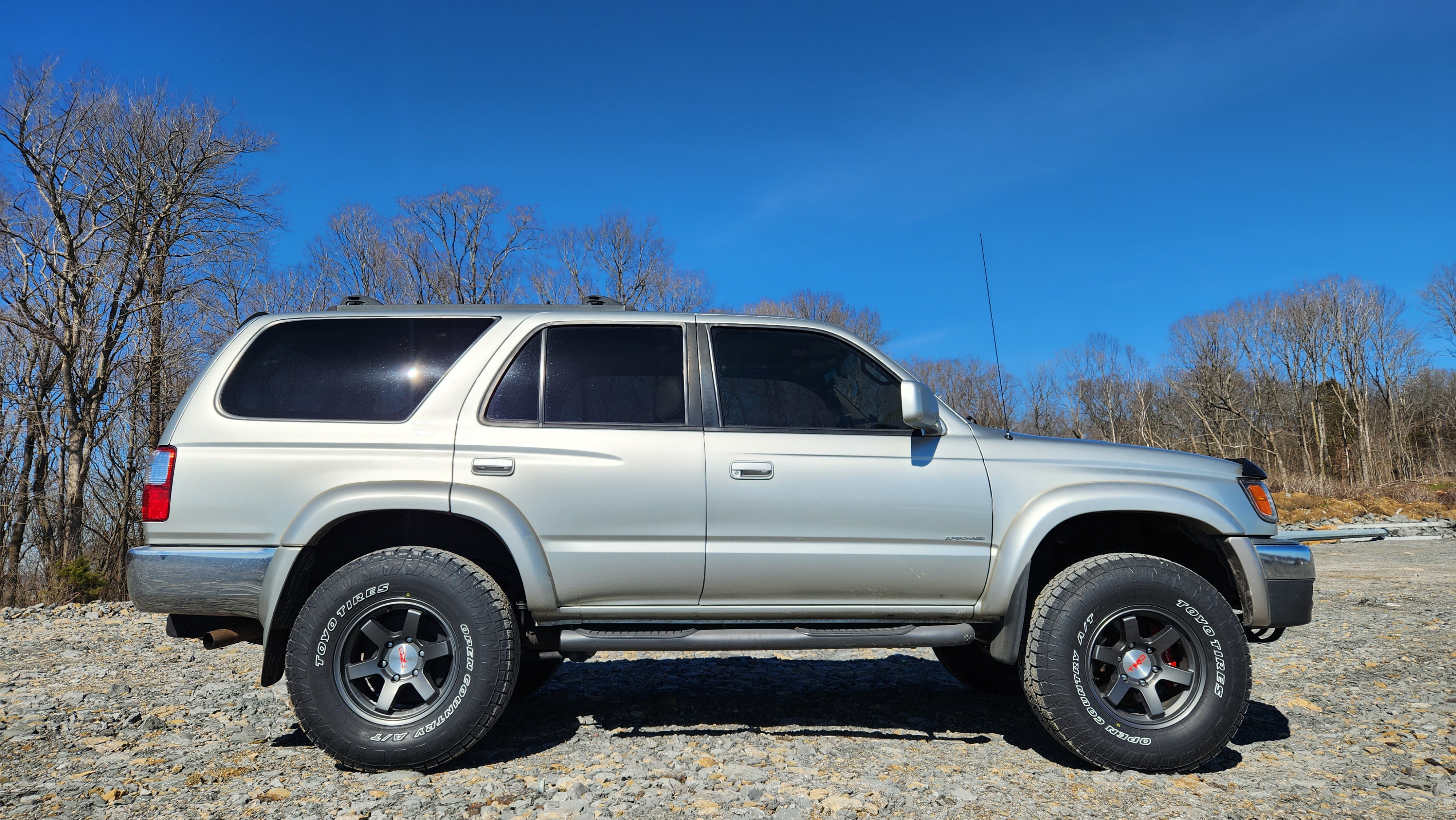

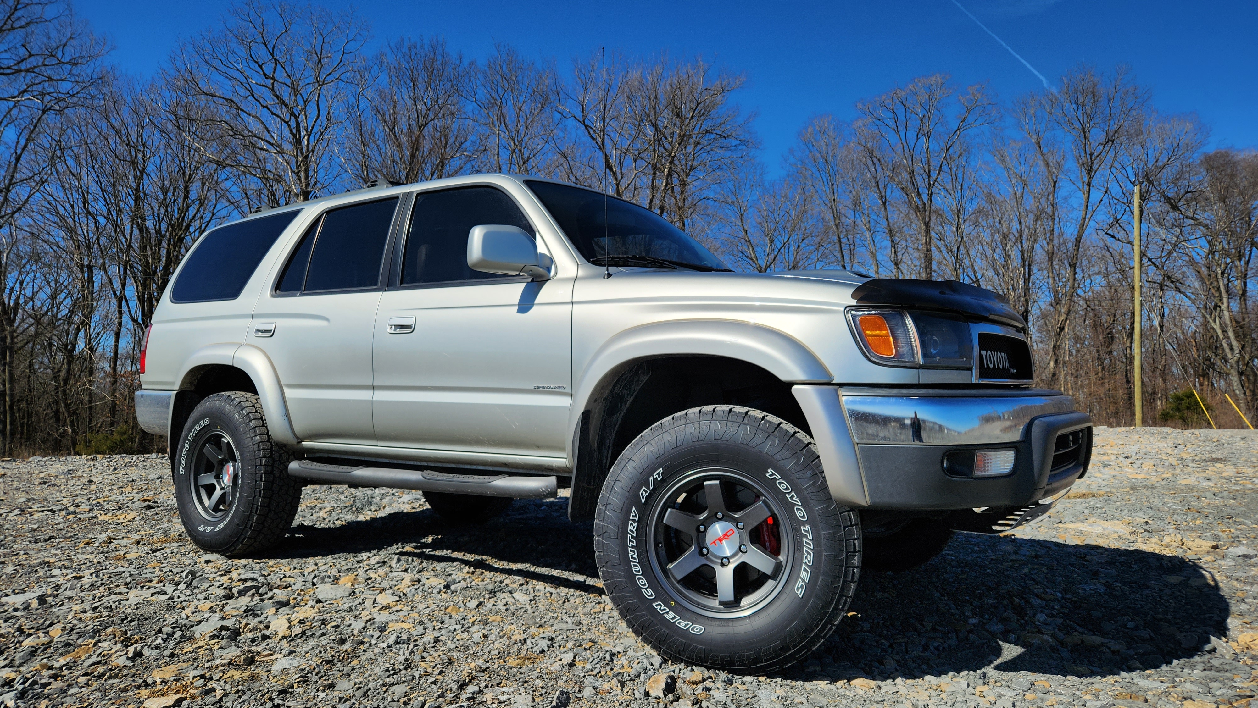

Made a decision on tires. I'll let you guess what size. I was torn between 285/75R16 and 265/75R16.
Third post updated with the deets. White letters out this time and I dig it.
They're 265's. Cmon Speedy, you gotta be quicker than that!
Sent from my SM-S908U using Tapatalk
You sure?
Well now that I've given the above image a closer examination, I've deduced that there's a 50% chance that they might be 285's... :rofl:
The wheels are turned and it's not a full on side profile. But from what I can see, with as stuffed as the rear looks to be, I might say they are actually 285's.
Don't keep us waiting!
Edit: Aha, I did guess correctly! They turned out great man. The truck looks great as always.

Yep, good guess. I was very surprised how much larger these Toyos looked than the Revo2 I had on before. The Revos were well worn so maybe that was some of the difference, but in the end I got exactly what I was "looking" for and I didn't have to lose any performance in the process. I had forgotten how quiet new tires can be.

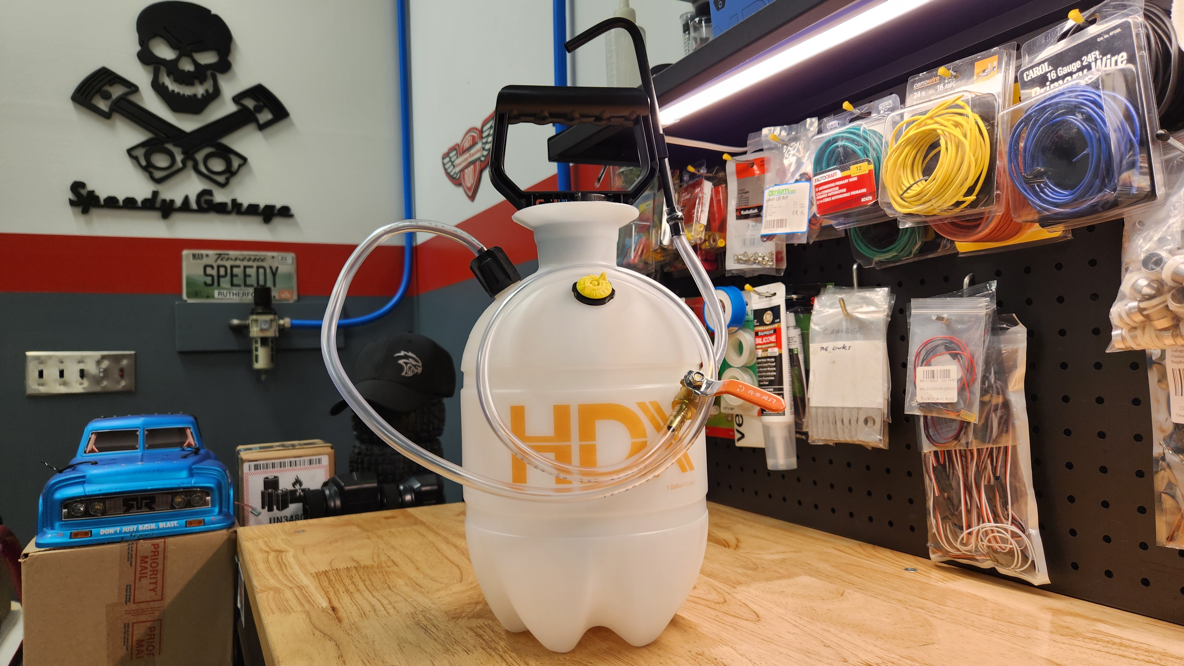

Next up are some fluid changes. I think I'm gonna build me one of those DIY pump sprayer fluid pumps.
Getting ready to do some fluids so I built a diy fluid transfer pump. Hopefully it pumps the fluid quickly.
Video in third post of this thread if you wanna see my version. Can't take credit, saw it online and here as well.
