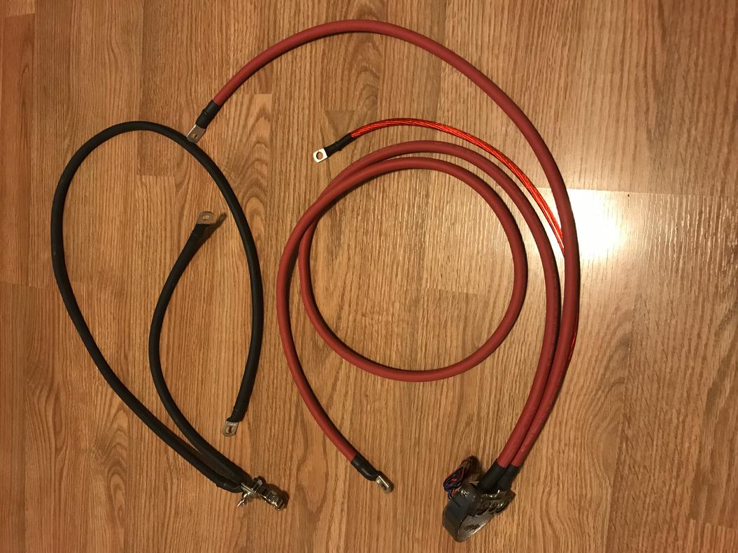

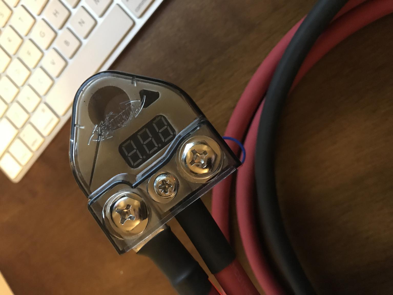

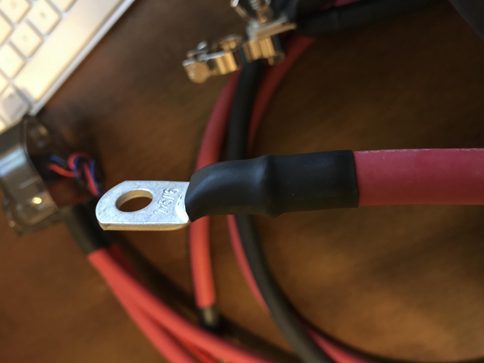

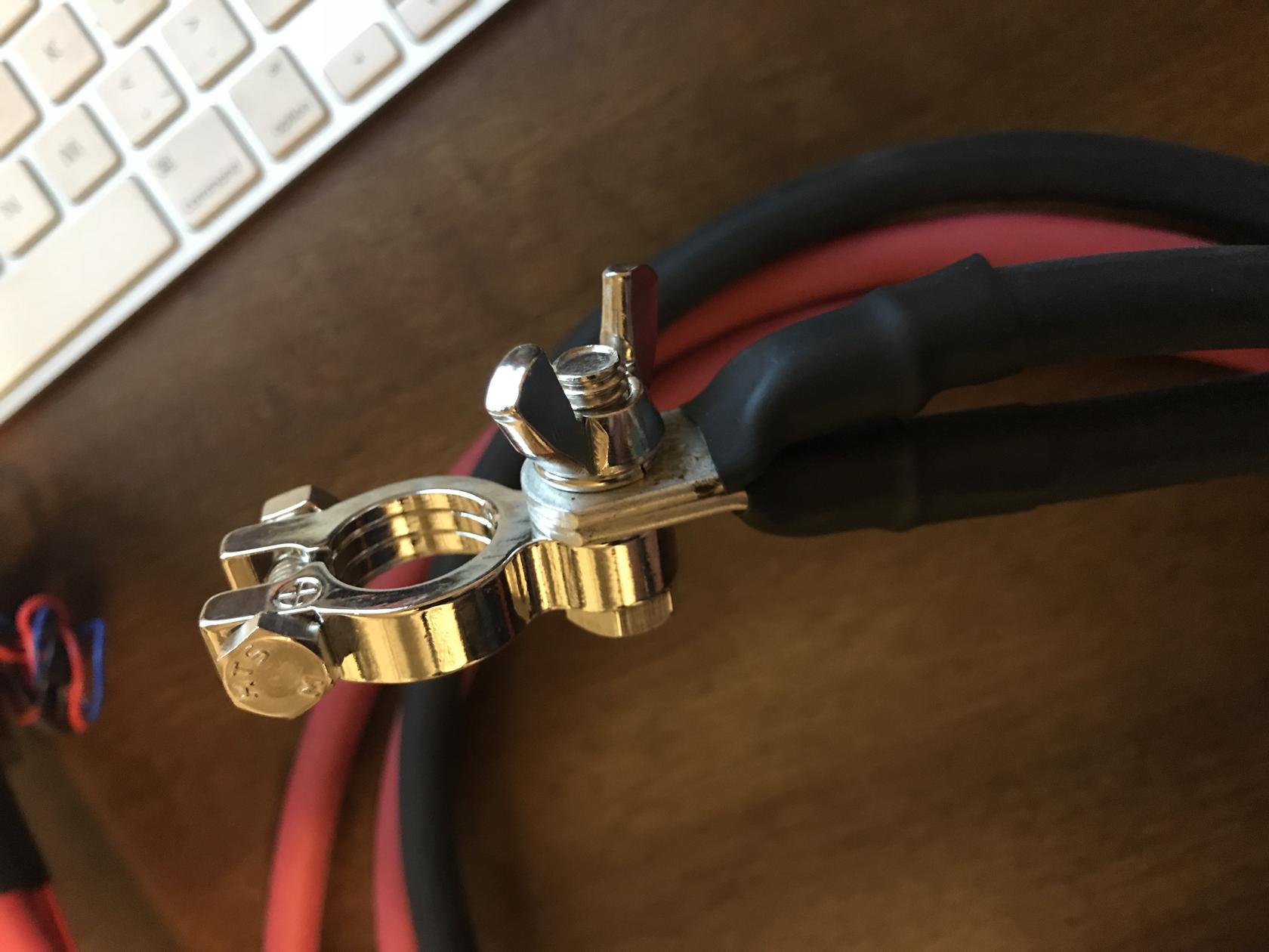

I recently purchased a Stage 1 Big 3 kit from BamaToy1997 on the Taco forum. 4Running Daily pointed me in his direction. Received the kit today, couldn't be happier. The quality is great, and he included an install sheet should I have any questions. I purchased a kit for the sake of convenience. I needed to get the mod done, but I do not have the time to sit down and make it. Now the search is on for a battery! Alternator to come soon enough, I don't see the need just yet since mine is still working just fine. If anyone out there wants to do the Big 3 upgrade but doesn't have the time or technical prowess to get it done, I would definitely recommend getting ahold of this guy to get it done. I think 4Running Daily has a post about the kit. I attached a few pictures as well. Theres a small red 8 gauge wire hidden under a 2 gauge from the positive terminal, but its there.
The kit was $140. Well worth the cost in my opinion. I waited about 3 weeks, a timeline given to me before I made the purchase. Im sure some prefer to spend less and do it on their own, but I knew I wouldn't get it done that way. Hopefully I'll be able to get it on the truck sometime in the next week or so, definitely before the snow starts to fall.

Looks clean!
I'd love to see complete pics (of the whole kit) and peek at the installation instructions
Heres a picture of the whole thing, positive and negative, as well as a PDF of the install instructions. Hope this helps! With the closeup pictures I originally had posted, as well as the whole view, it should give you a pretty good idea of the product.
What exactly came with the kit?
New terminals, positive terminal has a digital volt gauge built in, and all cables required to complete the Big 3 upgrade. Assembled and ready to go in. Quality stuff used, and the build quality itself is great. Along with the install sheet, all I have to do is put it in. This is the most basic kit, and they go up from here. High-output alternator can be added, dual battery setup, even a solar charging system. Since I only wish to do the cables, terminals, and a battery, I went with stage 1.

The instructions mention both 2 GA and 4 GA cables - the cables in your pics look to be the same gauge. Is that just an optical illusion?

All of the wiring is 2 GA except for the 8 GA wire that runs to the fuse box. I think that at some point the kit may have changed a little. This is also for a stage 2 kit that has the alternator, maybe that changes things as well, I'm not sure. Either way, the instructions are the same minus the alternator. Ive seen a little variation as the kits have progressed.

I'm running this kit and have been for about two years now and it's worked great. One thing to keep in mind though, I have had to replace the battery terminal clamps as have a few other members. The allen head bolts that tighten the clamps to the actual terminals have been known to strip out. Besides that, awesome kit and good luck with install.
What do you recommend doing, just riding it out until that happens? Also, did you do the install, and how did that go?

The voltmeter is interesting... and pics of it installed? I assume there is a switch for it? - or is it on 24/7?
The install isn't bad at all. Just make sure you have nothing going on if worst comes to worst cause you're car won't start mid install haha.
Running the new wires is the easy part. Pulling and removing the old wires is a little tedious though. I actually left the factory wiring in for some time because it's such a tedious job and I hate wiring.
As long as you don't plan on disconnecting your battery a lot, you should be good with the clamps provided. After doing the wiring, I replaced my starter, added an auxiliary fuse box, and several more accessories so my terminal clamps were being connected and disconnected quite a few times.
After several times of my 4Runner not starting and having to move the clamp around, I decided to go with these because they're pretty much dummy proof.
I just used generic battery clamps from West Marine. Also got tin plated copper lugs since they fasten differently to my new clamps. Pictures of what I used Here. I kept all the wiring in the kit when I did this as well cause it is really nice wiring, I just added the new lugs to clean everything up and make good connection.
Haven't done the install yet. Hopefully within the next week or so. Voltmeter is constant from what I understand. I suppose its interesting to see what you're running in real-time.
