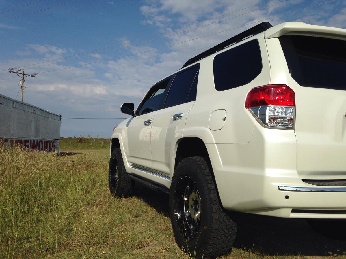

Most will say ditch the 20's and put on 17's. Listen to them!!! I have 20's on mine and tires are pricy and the selection is very limited! At the time I bought 20 I was keeping it mostly a street ride, then I went off road and loved it. Stuck with my XD Hoss 20X9 -12 offset wheels I have since run a 275/55/20 - not much rub, think I just needed the fender liner mod and had a 3/4 toytec spacer lift. Then that wasn't enough and I added 275/60/20 Cooper ATP and 5100's at the top and it rubbed like hell so I had to do the BMC, TC UCA's to push caster to +4 and was rub free after some more trimming in the fender well. Then I wanted more tire because well I wanted more tire and now think it looks like it should and I have a little more sidewall to work with. So I now am running 275/65/20 (34.1) BFG TA/KO and switched to Radflo Coil Overs and had to trim the bottom lip of the bumper cover a lot to be rub free! My ground the bottom of the fender measurement is 40.0" up front and 40.7 in the back. It really depends on what you want to do with it, just thought I would share my experiences.
