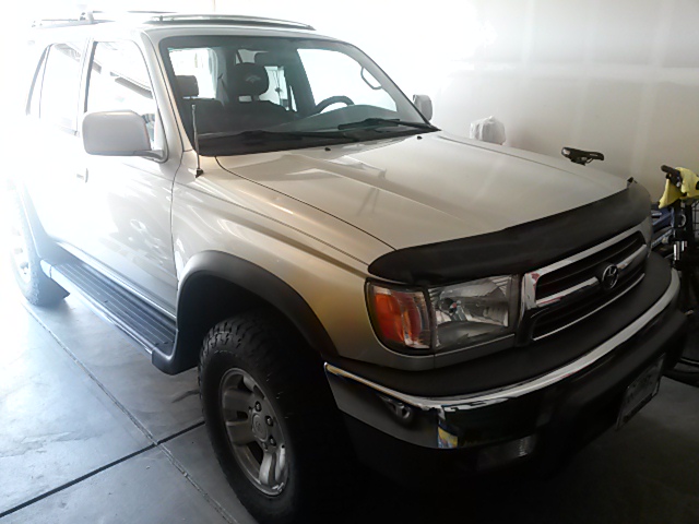

What's the biggest size tire I can run (without rubbing) with a 3" Toytec lift and no body lift. I have a 1999 T4R SR5 with black fender flares. If this topic has been discussed before, please point me to the right discussion thread. Thanks!

Probably 33s (285/75/16) comfortably with no body lift.
Will just need to pound the pinch weld on the rear of the FRONT wells and maybe trim a tiny bit of the front bumper. If you don't want to deal with any of that you can get 32s.
I think it really all depends on the type of tire if you go any bigger than 33's. I'm running a 285/70/17 on BFG A/Ts and no rub here.
