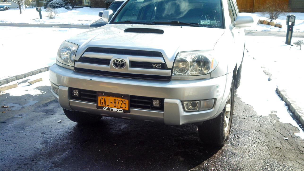

Rigid D2 Driving Lights
Rigid D2 Yellow light covers
Rigid Dually Spots on CBI ditch light brackets
Rigid Dually Flood in 3d Printed inserts stock location

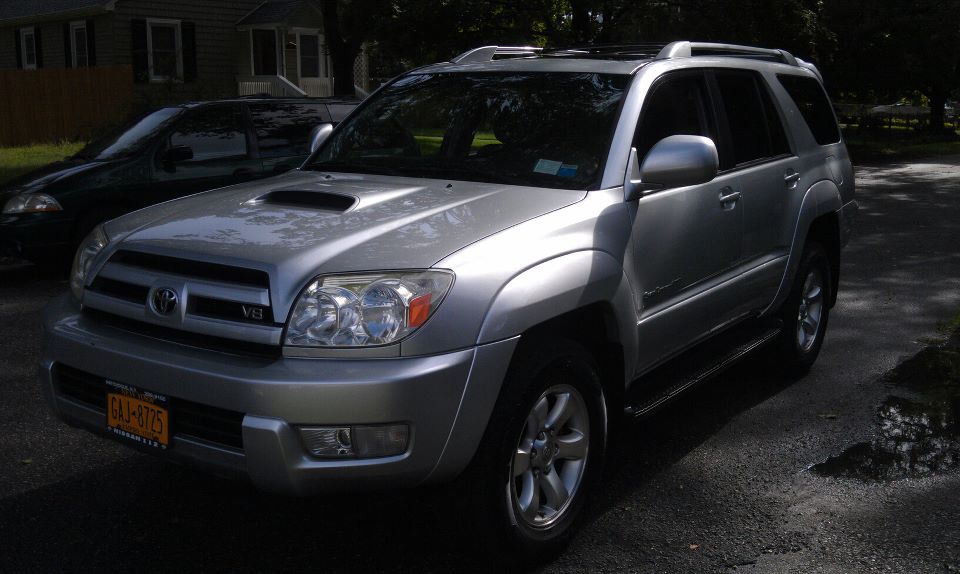

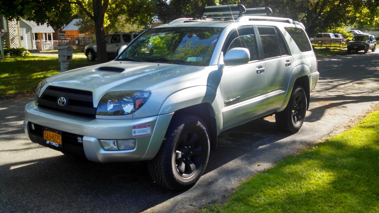

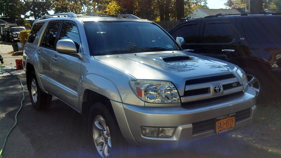

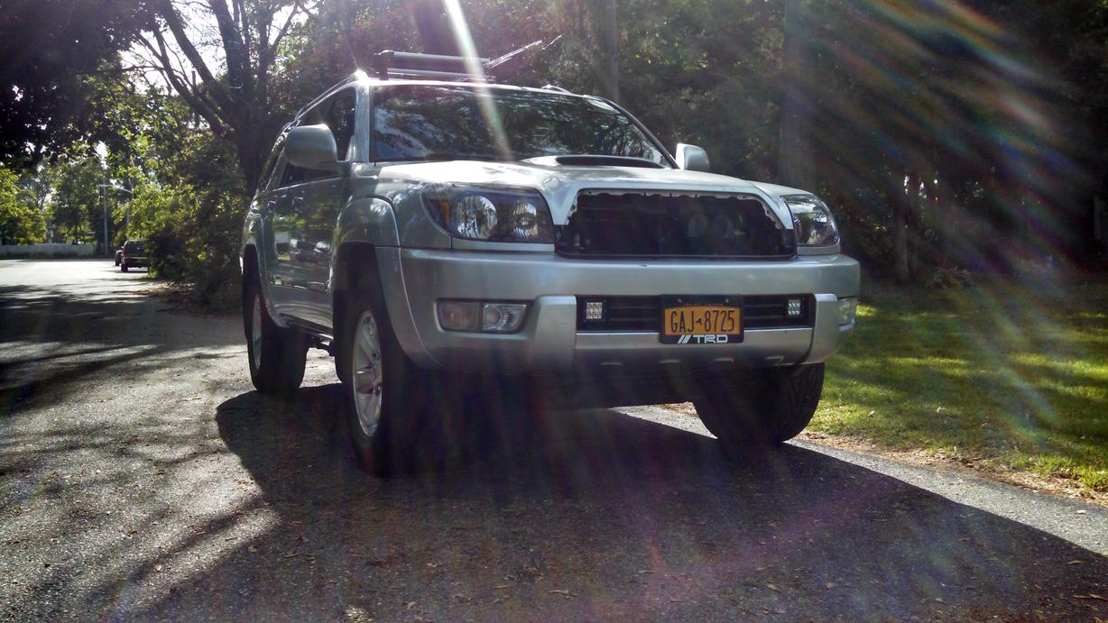

August 10th, 2012:
2005 Toyota 4Runner Sport Edition V8 with XREAS, Silver,89k, I am the second owner, Zero Rust anywhere underneath, was garage kept.. dealer-maintained.. came with 1-year free maintenance, New tires, had the windshield replaced.
The minute I got it home 8/10/12:

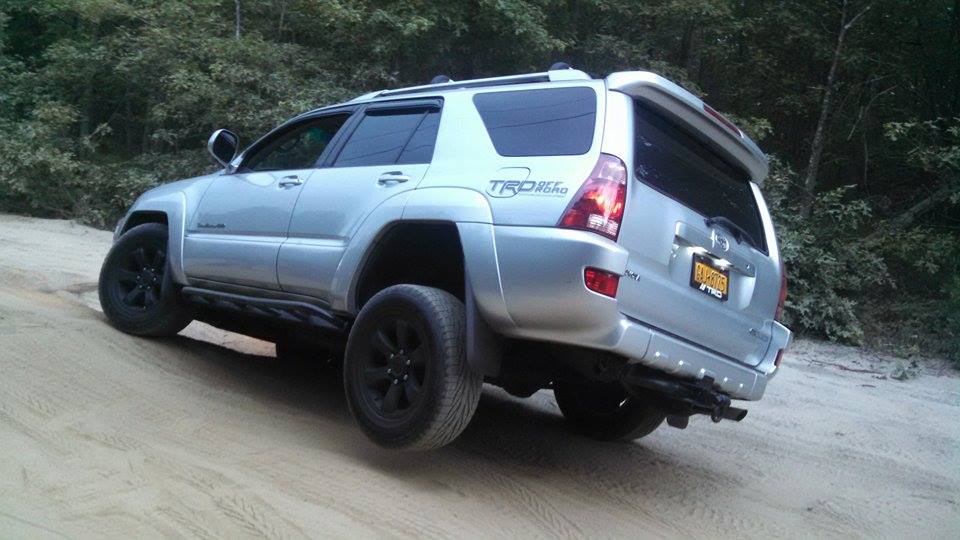

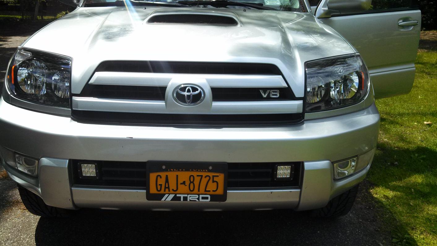

Offroading: 12/1/18 ( Rausch Creek PA)

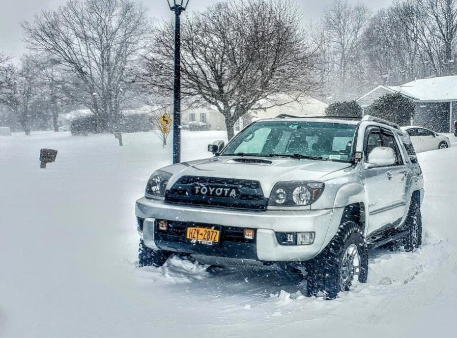

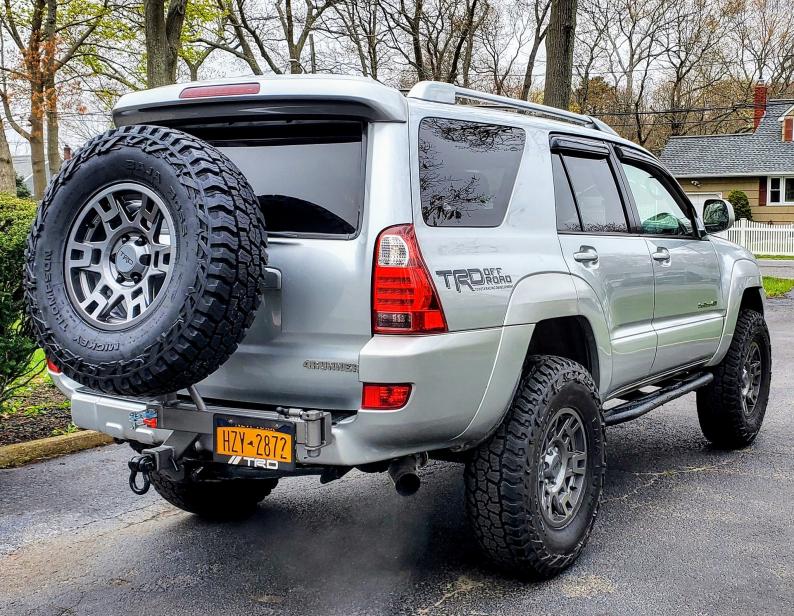

As it sits now : Feb/2022

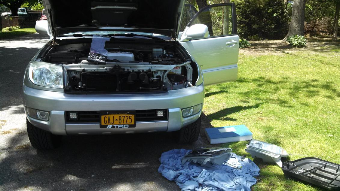

May 2014:
Black Bezel Headlight install with Sylvania ZXE Bulbs

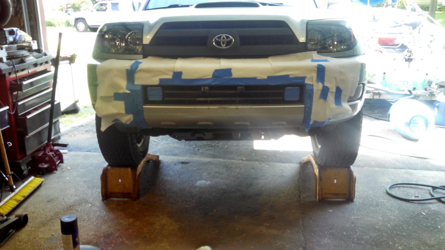

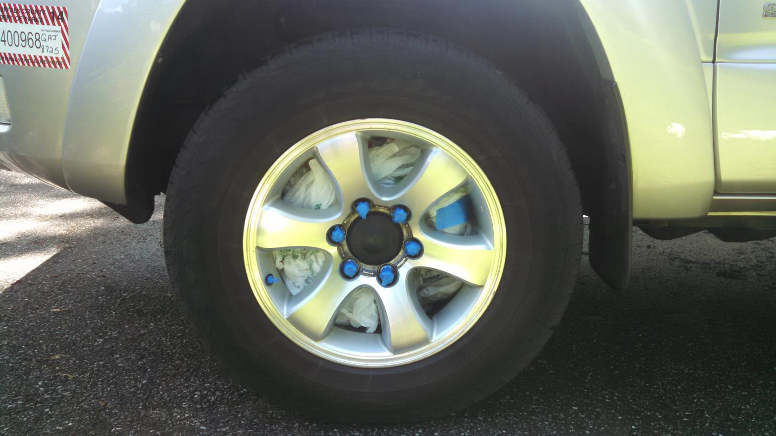

June 2014:
Plasti Dip Fever kicked in..

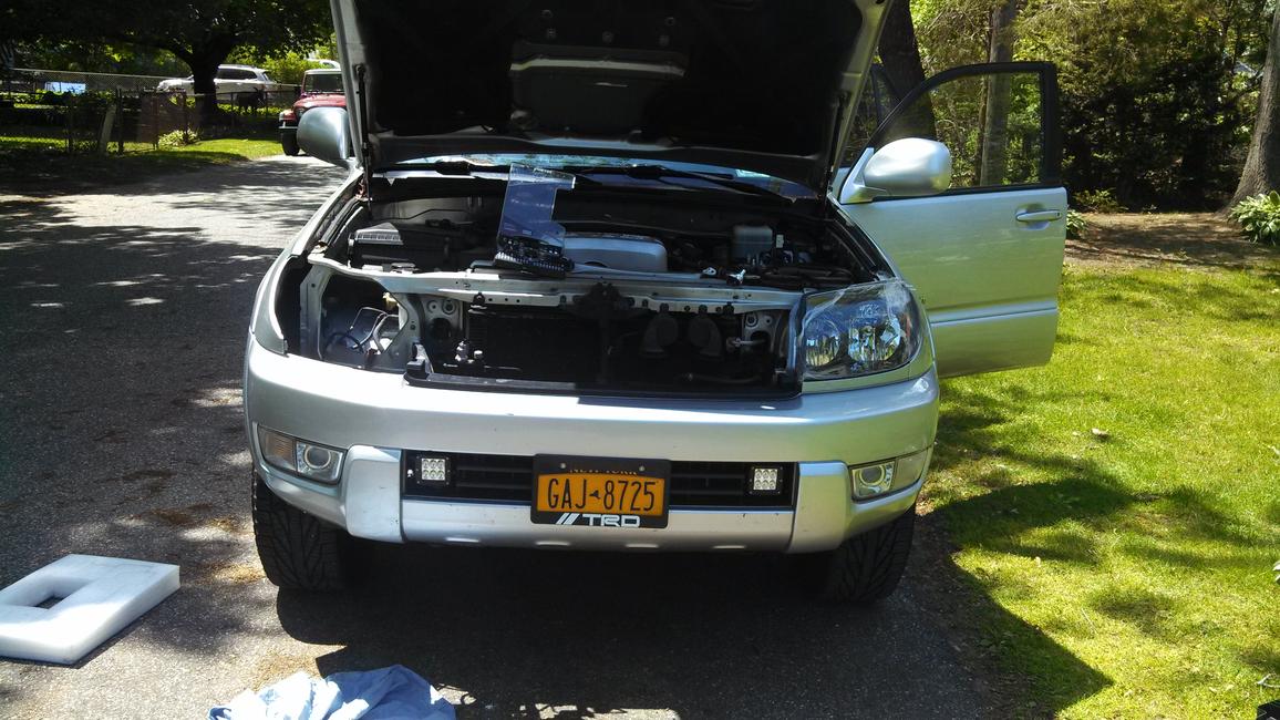

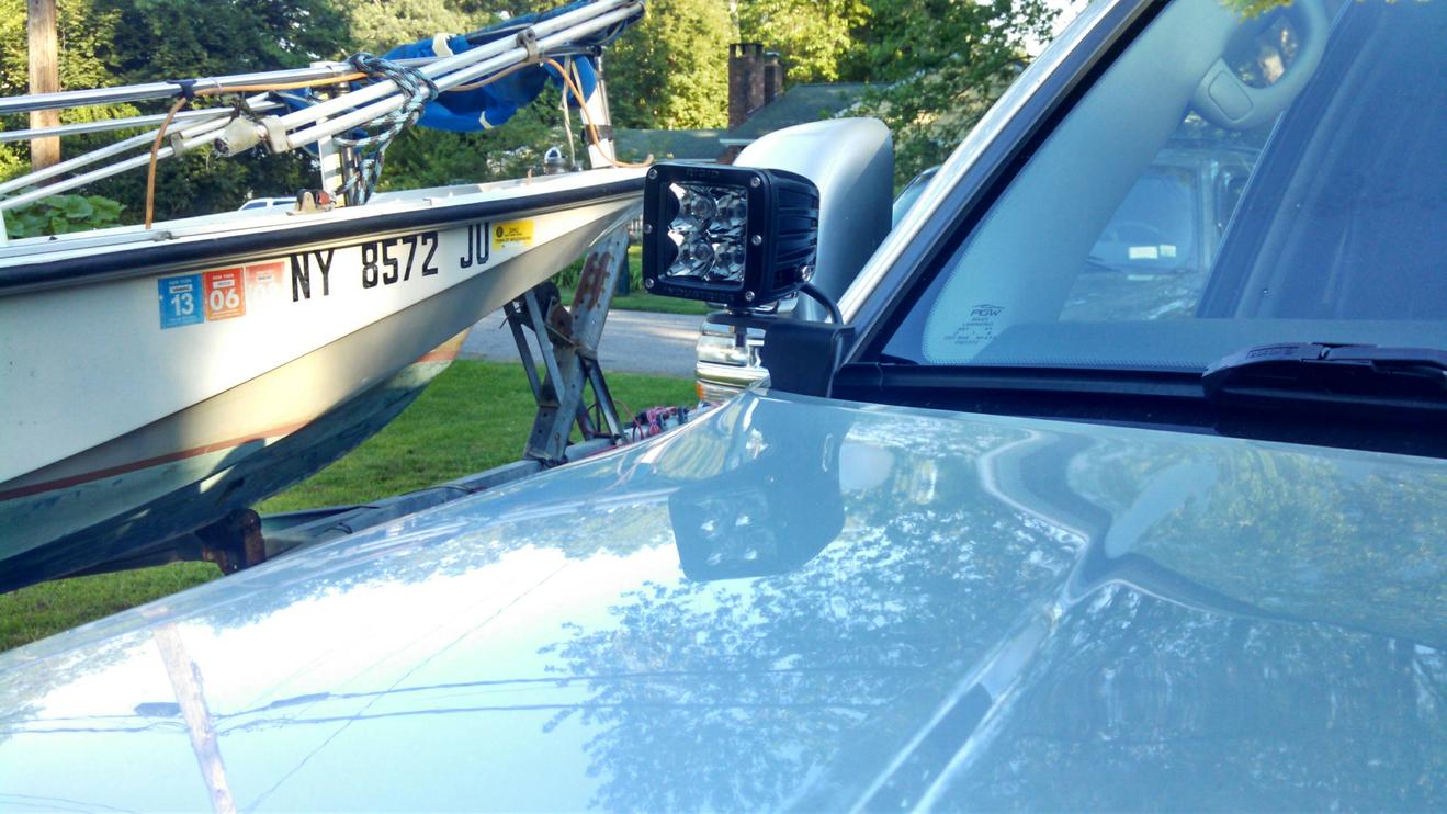

July 2014

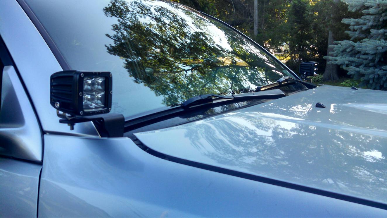

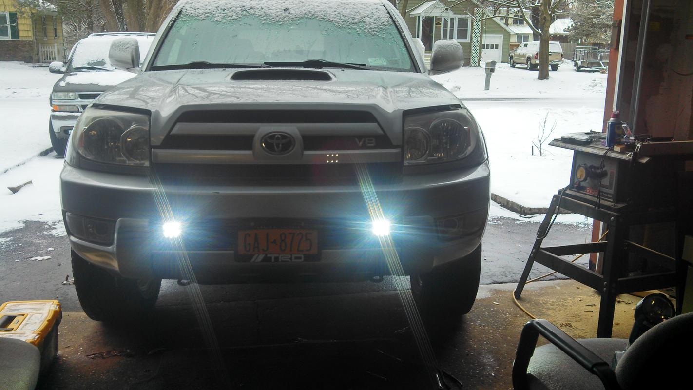

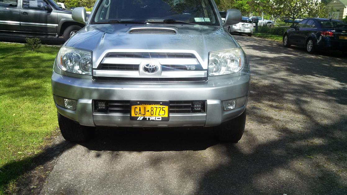

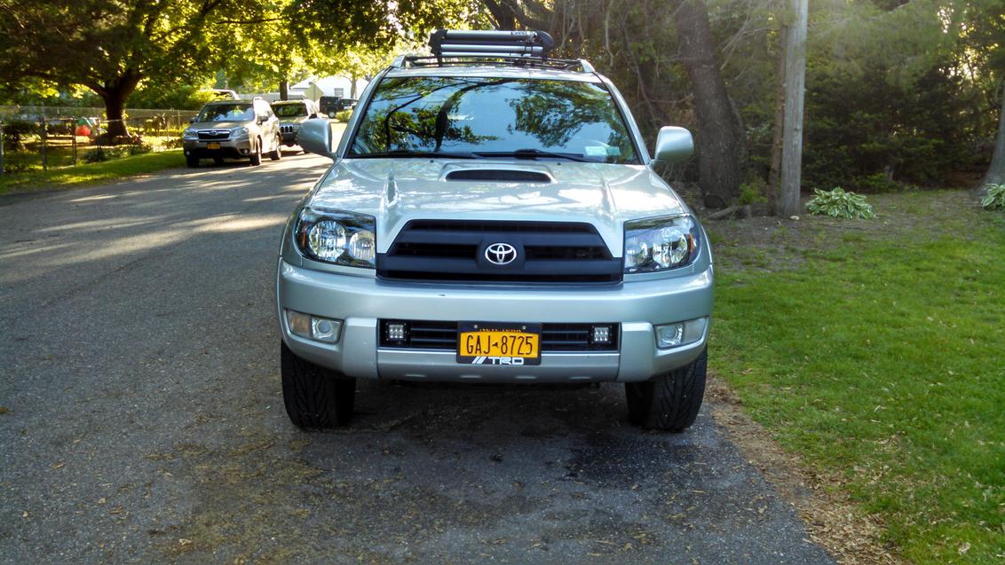

CBI ditch light brackets with Rigid Dually Spots

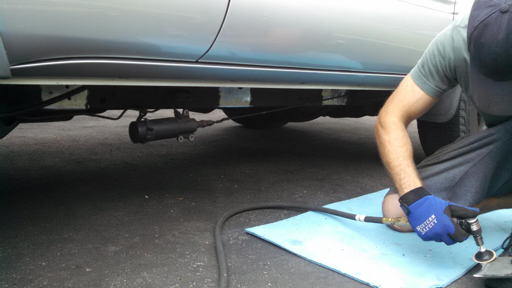

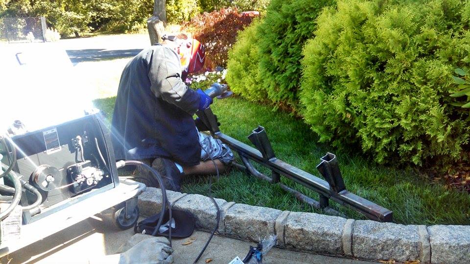

September 2014:

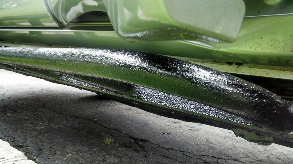

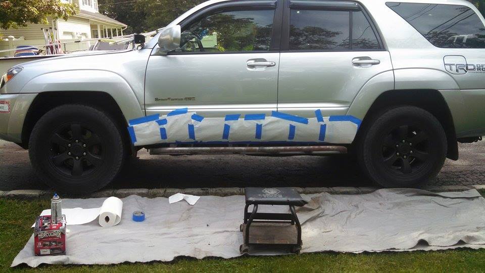

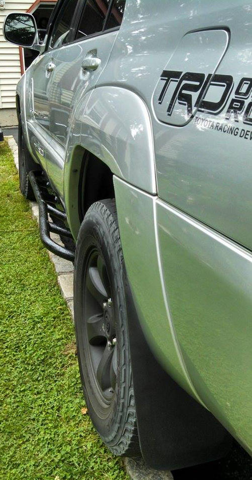

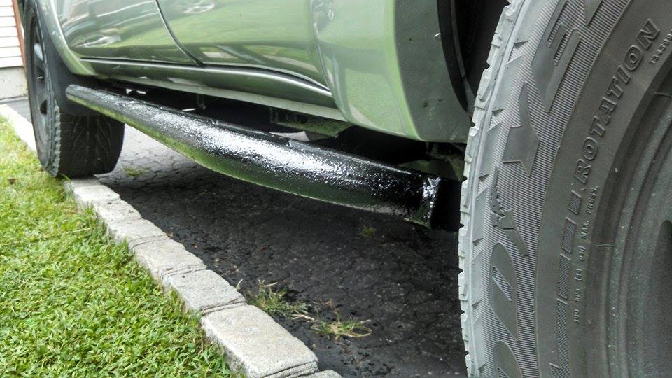

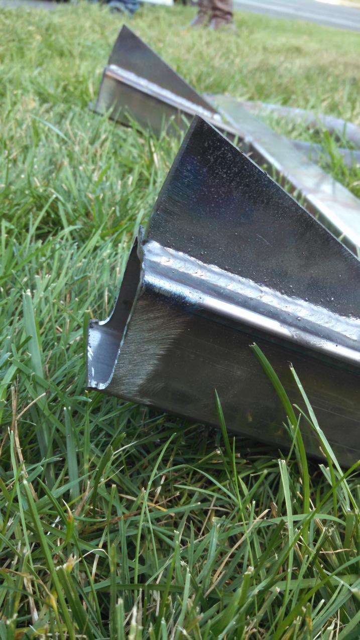

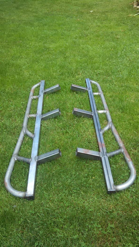

BAMF Sliders in the process of being installed coated with Herculiner Bedliner
Herculiner coated:

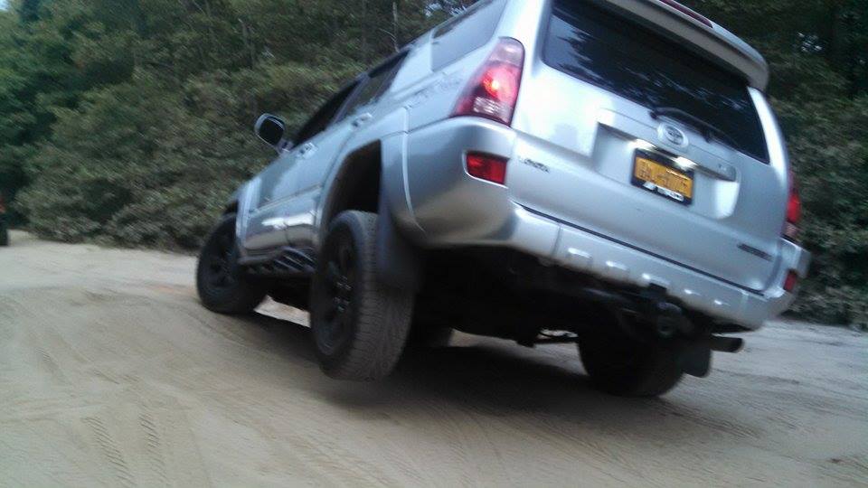

September 10th 2014:
Found some local power line trails with some friends.. First time lifting wheels.

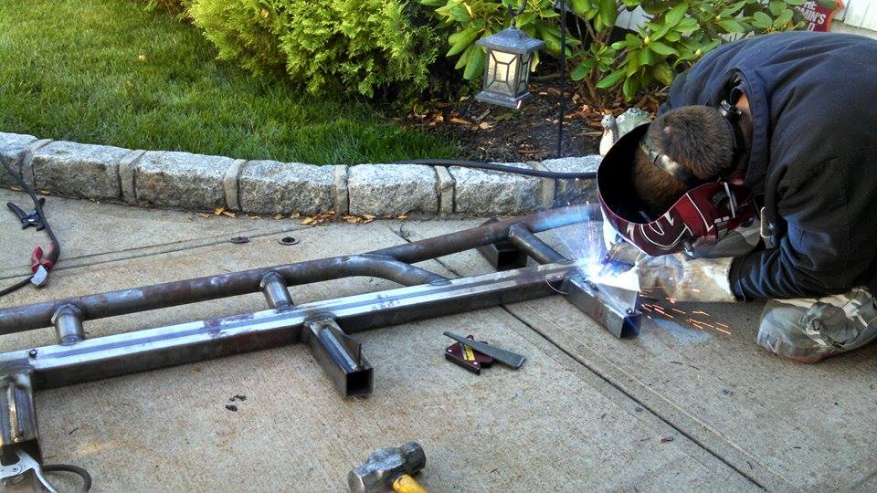

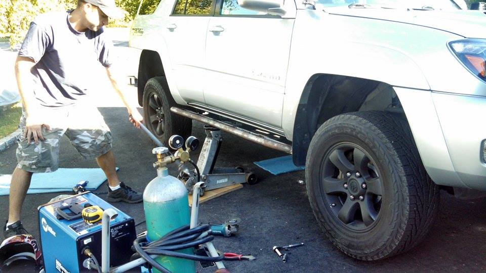

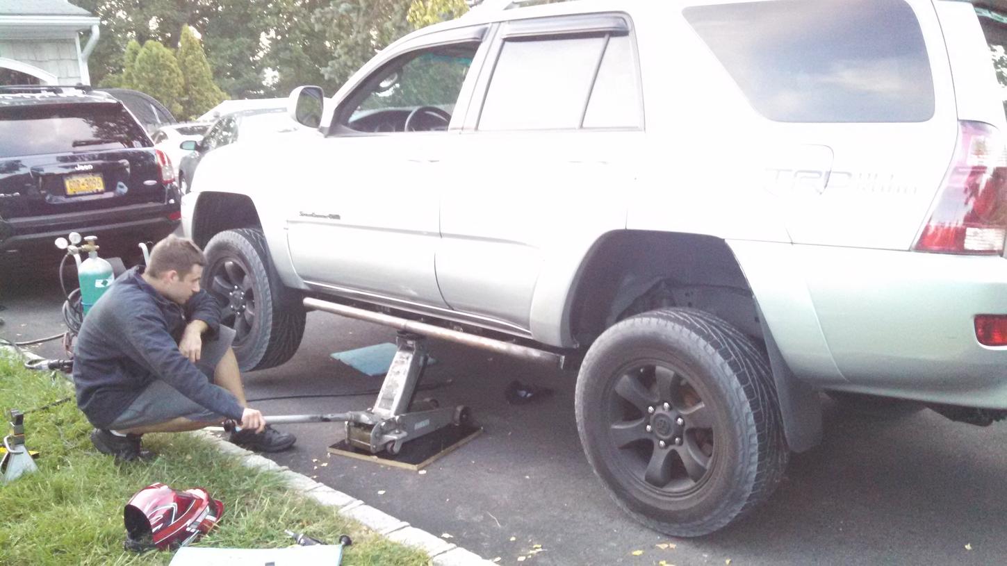

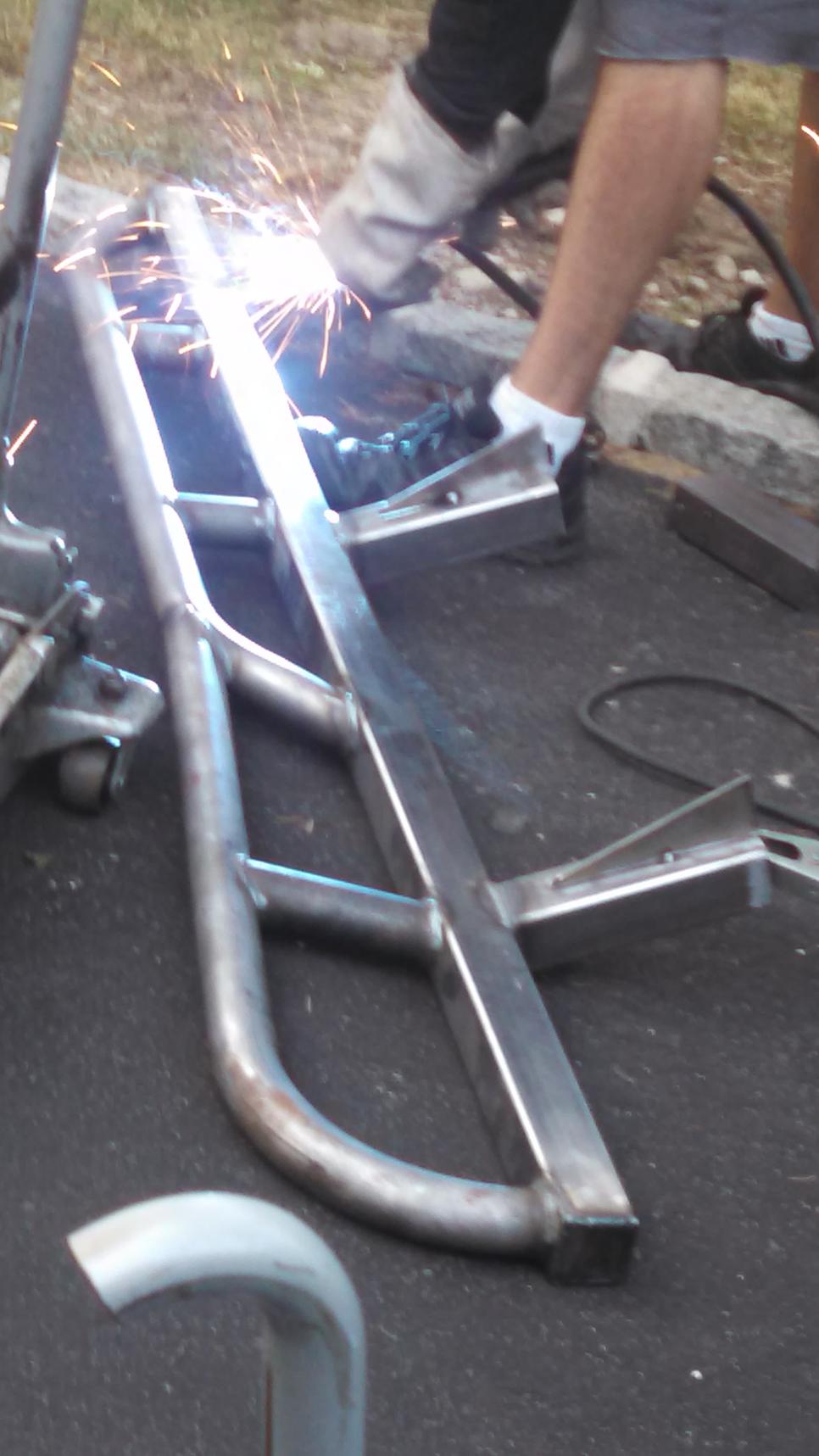

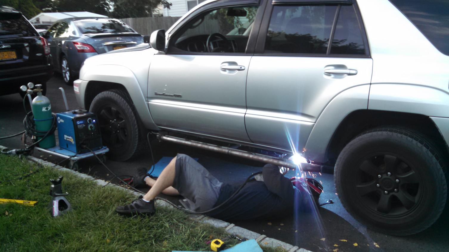

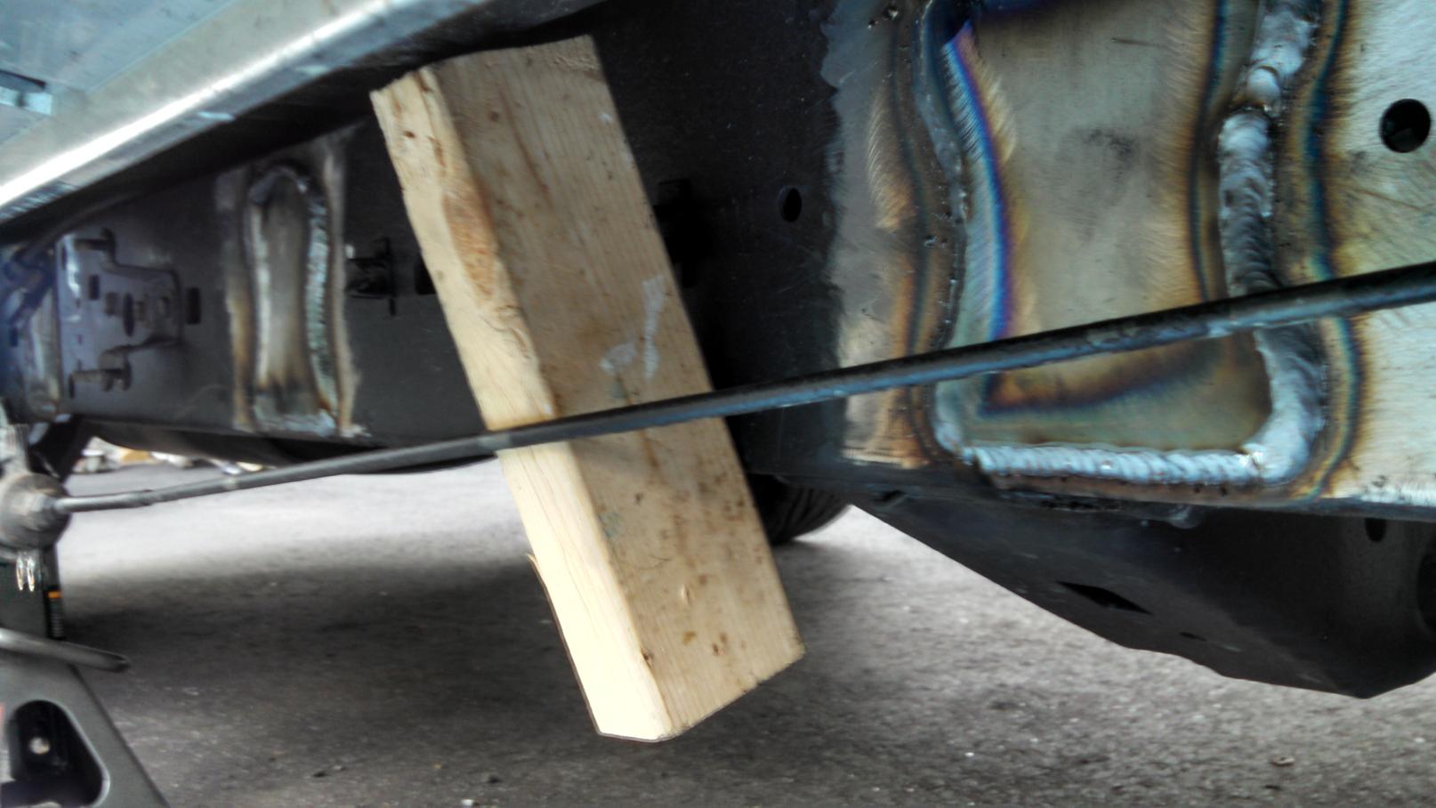

September 13 2014
Got the Passenger side Slider welded up. Had to do more notching and adjusting of the square stock to get it to fit correctly but it came out good.

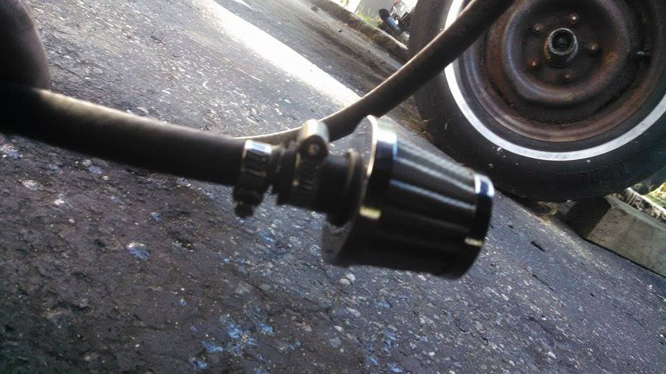

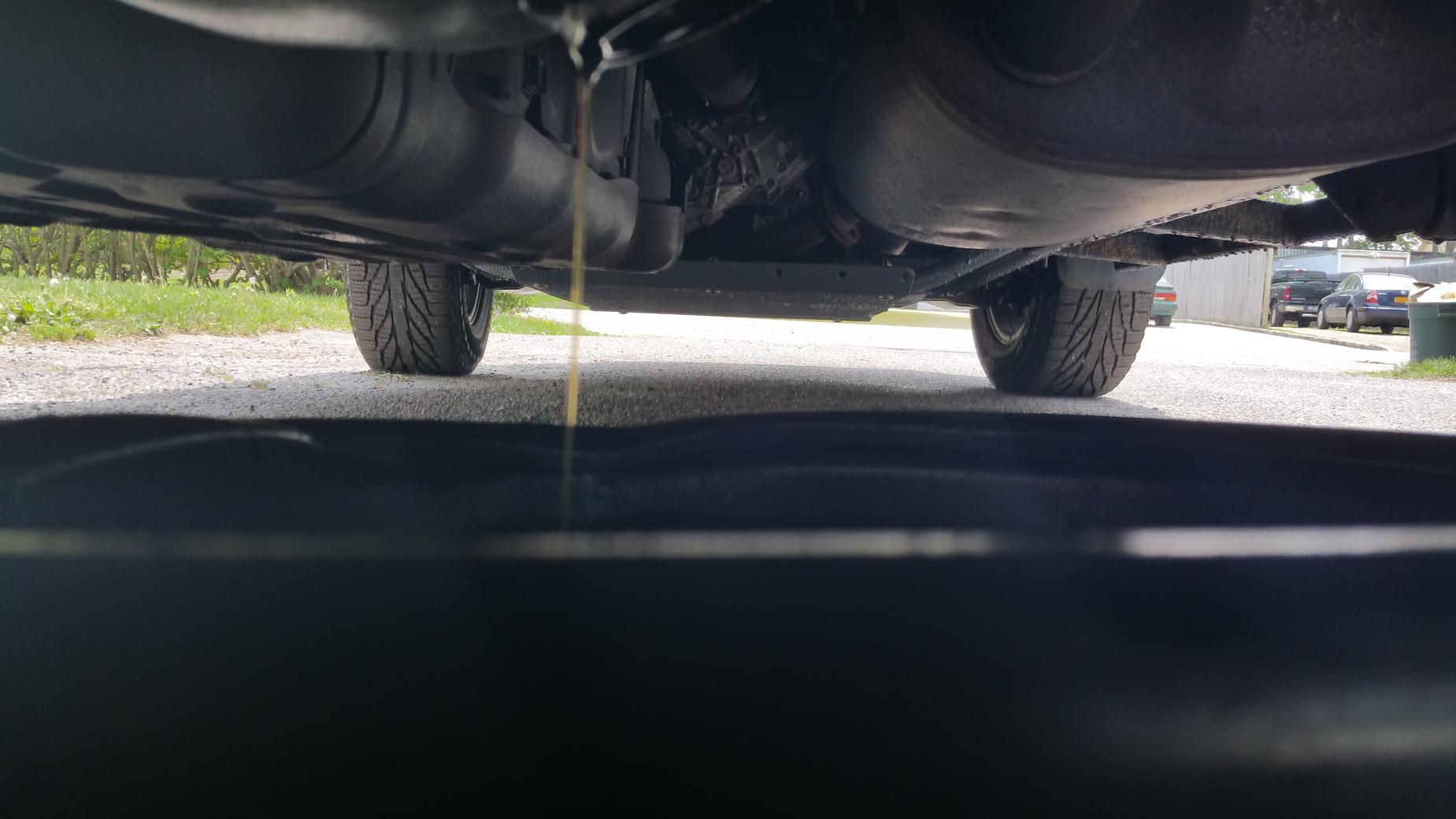

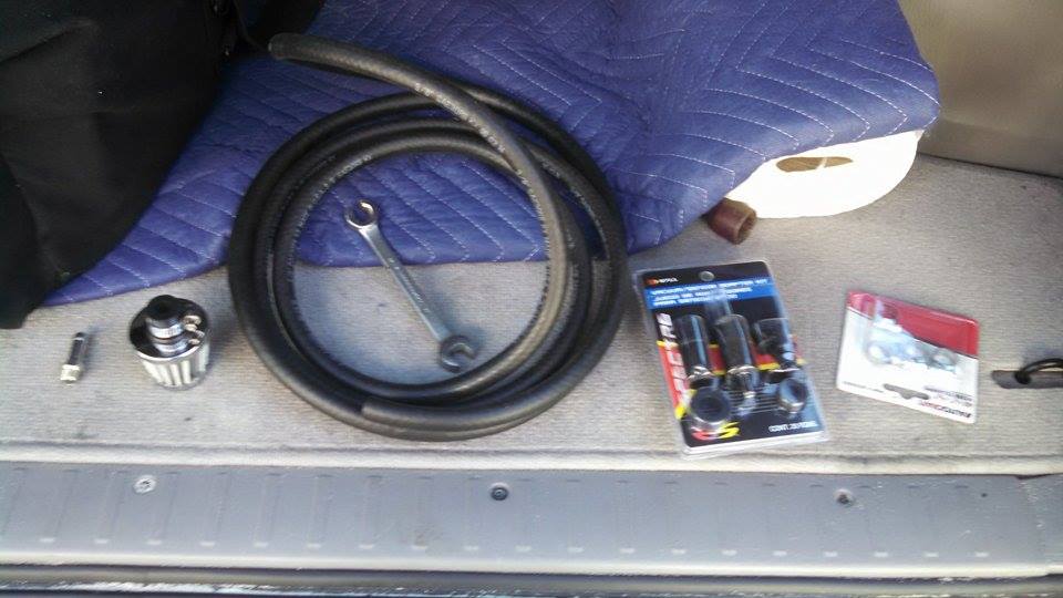

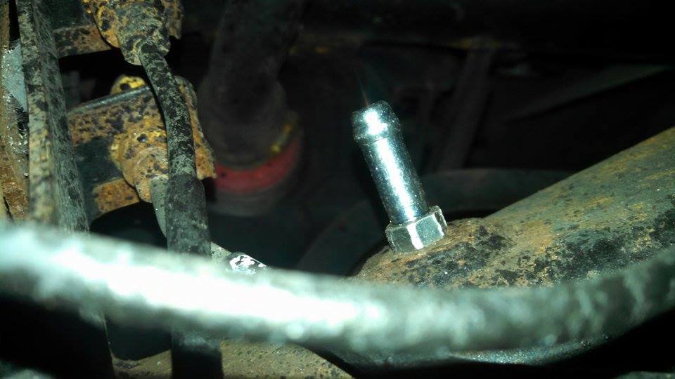

Rear Diff Breather extension Mod:
Filter is zip tied up behind gas filler neck.

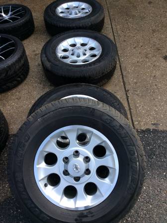

3/26/15 @ 110,000 miles
Yes it has been a very long while since Ive really done anything with my truck. Money has been tight and the winter was too cold here on LI for life. Started getting the spring itch today to work on my truck. been looking for a while now and found a perfect condition set of FJ 8 hole wheels. all tpms sensors work too.
They will be waiting to be fitted with 33's when I get to the lift hopefully sometime this year. Right now I have my sights set on the radflo 2.5 kit with camburg ball joint UCA's. Trying to do it right the first time.

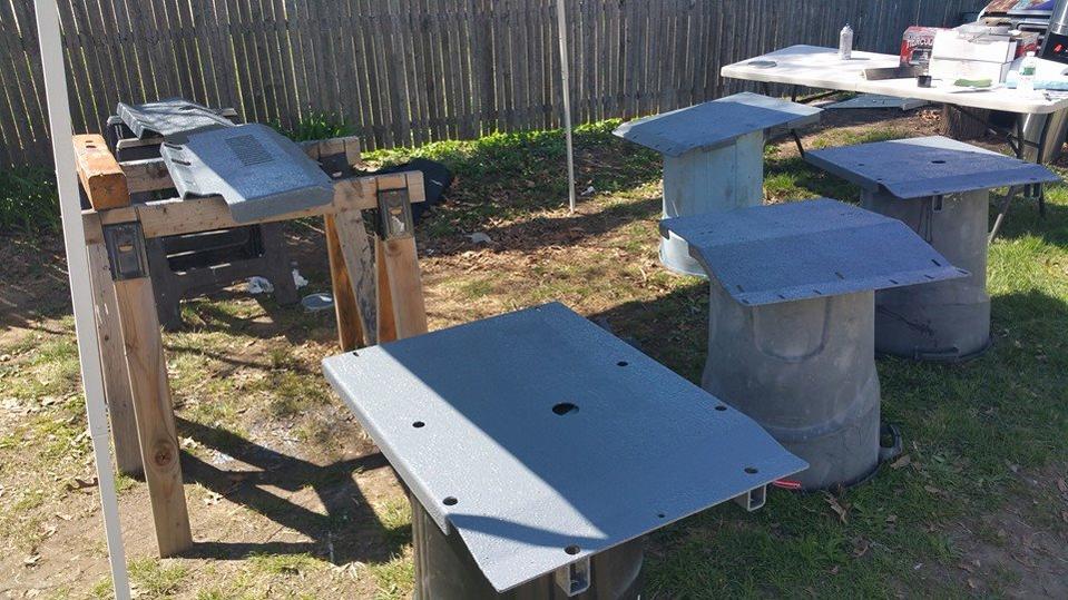

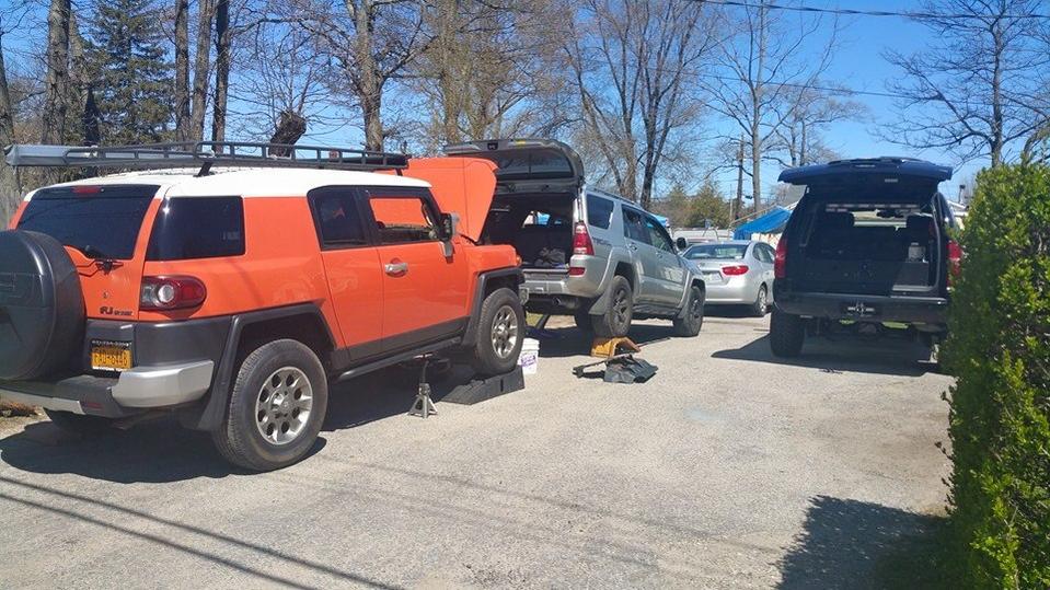

April 27th 2015

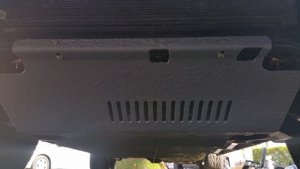

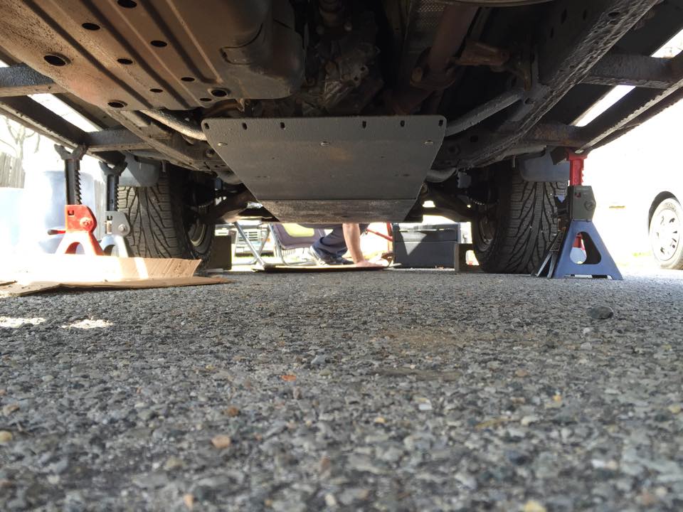

Budbuilt Skid 4 piece combo for me and a buddy with an FJ arrived today..
Tomorrow's project-
- Remove stock skids
- Oil change
- Rear sway bar bushing upgrade to poly
- Grease everything
- re-clamp passenger cv outer boot
Prep for herculiner coating on skids
April 29th plan-
2 coats of herculiner on budbuilt skits
1 coat of herculiner as undercoating of truck
touch up rocksliders with left over.
april 30th plan-
Install skid plates
Prepping for first time Rausch creek trip with friends june 6th 7th and 8th. everyone is welcome to join, shoot me a PM for details if interested

April 29th-
Removed stock skids,Oil changed, Rear sway bar bushing upgrade to poly
Greased everything on driveline
2 coats of herculiner on budbuilt skids
4/30/15
Installed Budbuilt Skid plates with Stainless hardware

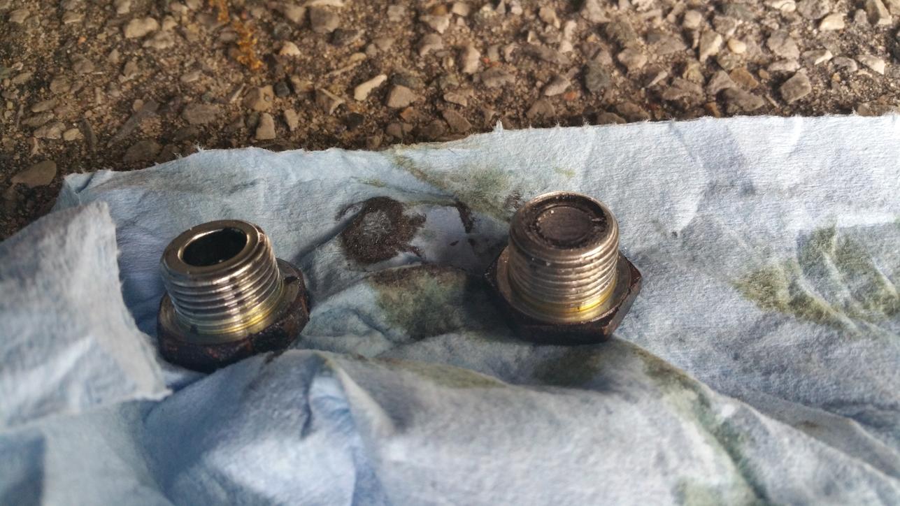

5/12/15
Changed original rear diff fluid to mobile 1 synthetic 75w-90
Drain plugs came out and went back easy. All looked good. Magnet had no visible signs of wear and tear.
