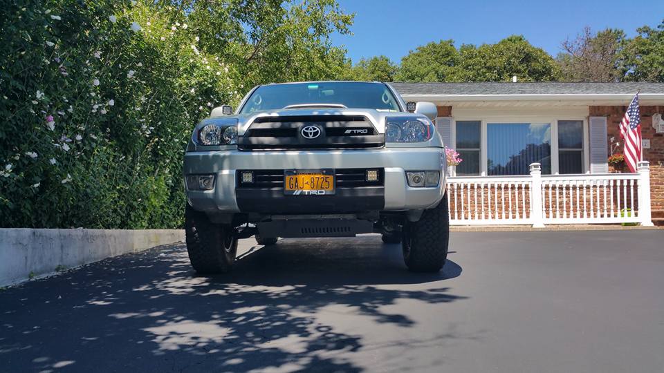

Nice man, looking real good. I have a silver 08 and plan on going kinda the same route as you. Can't wait to see it with the lift. You plan on plasti dipping the fj wheels black too?
Thanks man, Ive actually been thinking about doing the FJ wheels in anthracite grey and keeping the silver/machined ring around the outside by the bead.
The daystar lift it really just a temporary fix for some ground clearance until I can afford the coilover lift I want.

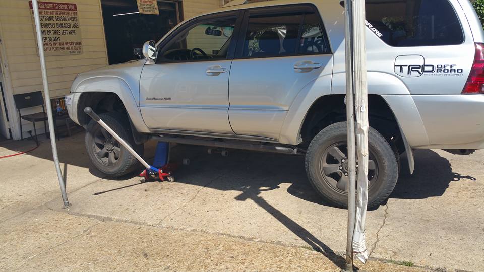

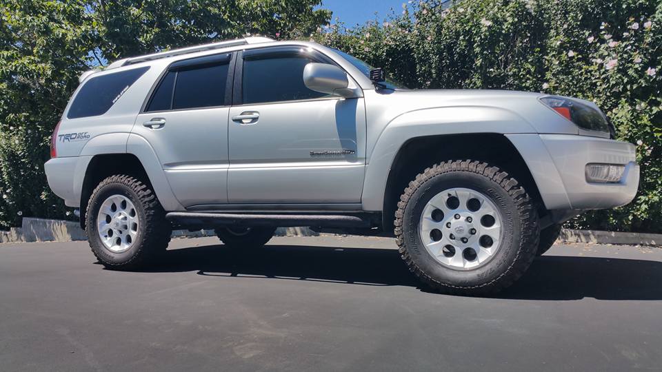

Installed Daystar 2.5/1.5 kit and got alignment
That lift looks good. How long did it take you? I'm planning on doing mine in a few weeks. You going to get bigger tires too?
Thanks man, Its more of a temporary fix until I can afford the suspension kit I want. It took me a while to figure out the best possible way to do it, and the instructions that come with the kit suck. once I had some help with an experienced person who has done it on these trucks before, we flew through it. If he was there from the beginning the whole job can be done in under 2 hours easy.
I will get bigger tires eventually when these tires die. They are very good tires so not worth getting rid of yet.

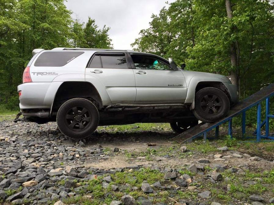

And after a few months of Prep, thanks to advice and inspiration from some forum members, I finally was able to bring the runner to Rausch creek Offroad park in PA and really test it out.
I gotta say, these trucks far surpassed my expectations, keeping in mind im basically stock except for some armor and daystar lift. I cannot wait to go back with upgrades and push the limits even more!

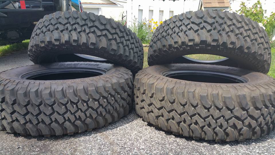

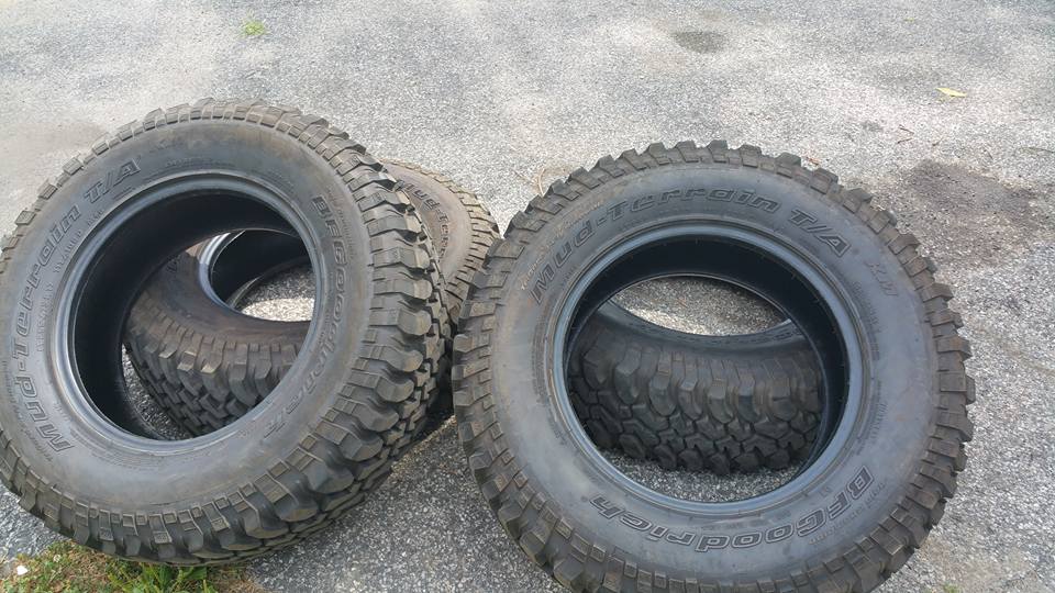

Picked up a set of 5 jeep rubicon take off's with less then 800 miles on them. Mounting on my '13 trail wheels soon.

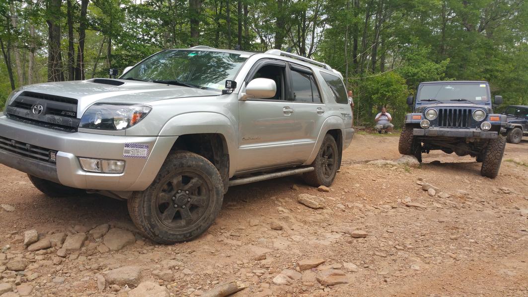

8/13/15

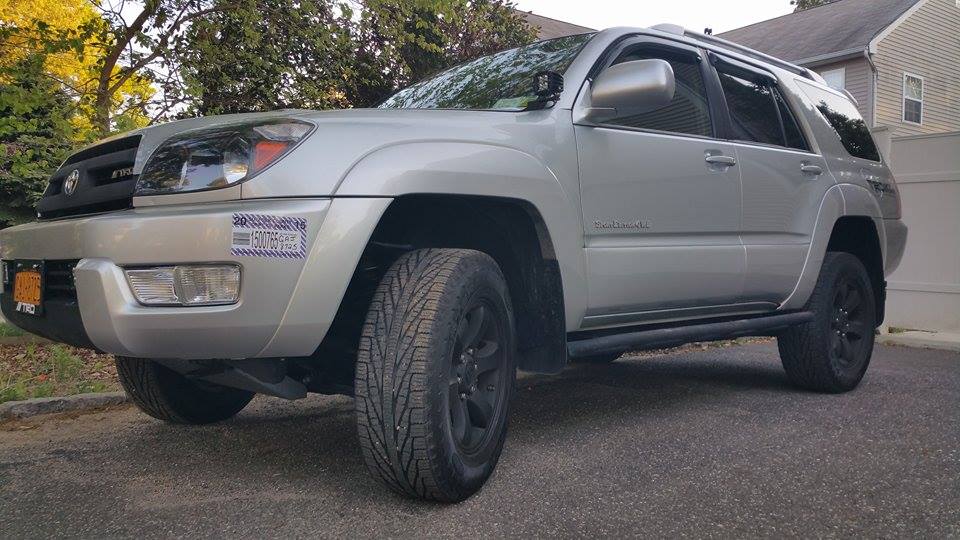

Got my tires and wheels put on today!

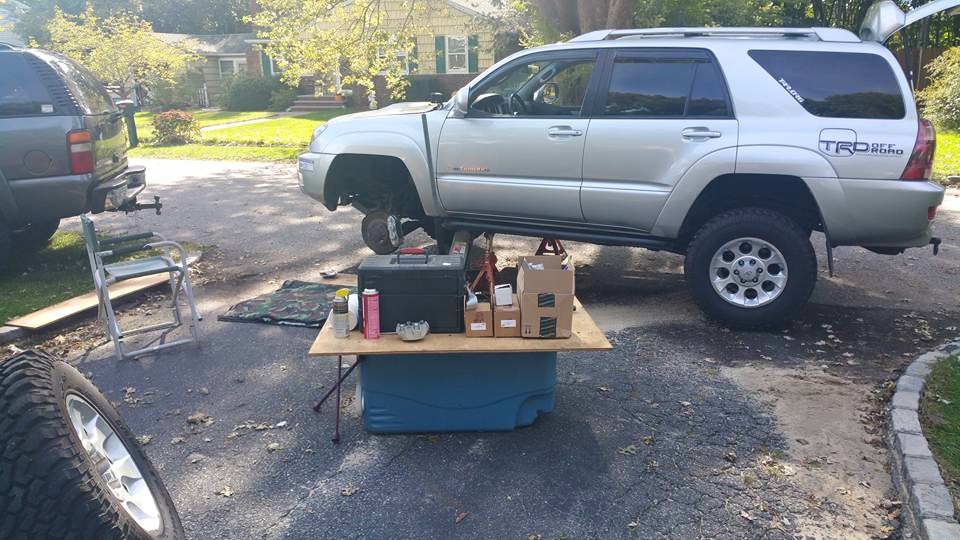

10/11/15 @ 116k miles

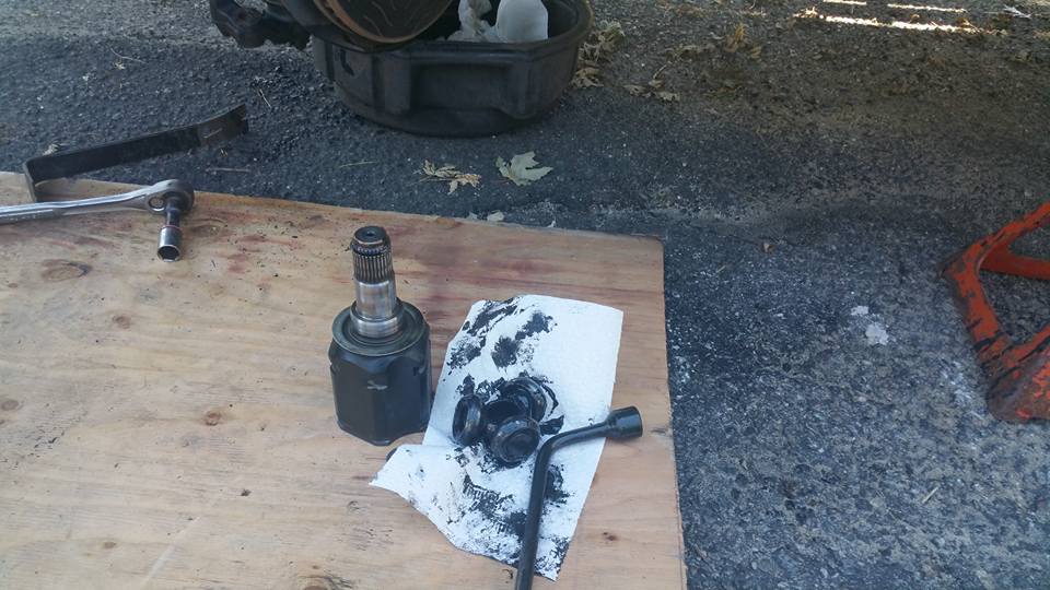

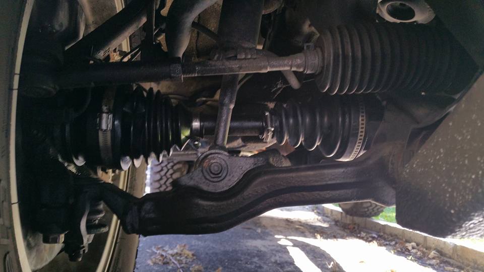

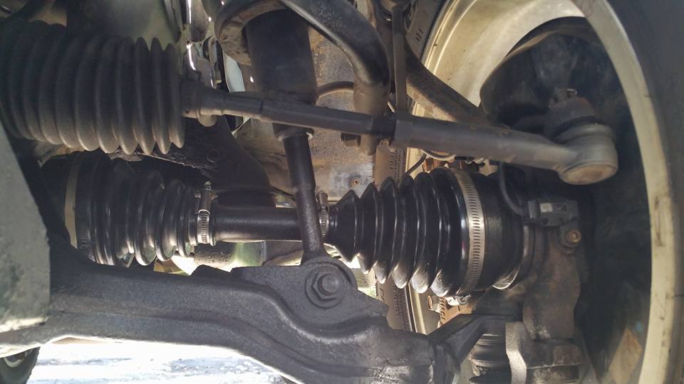

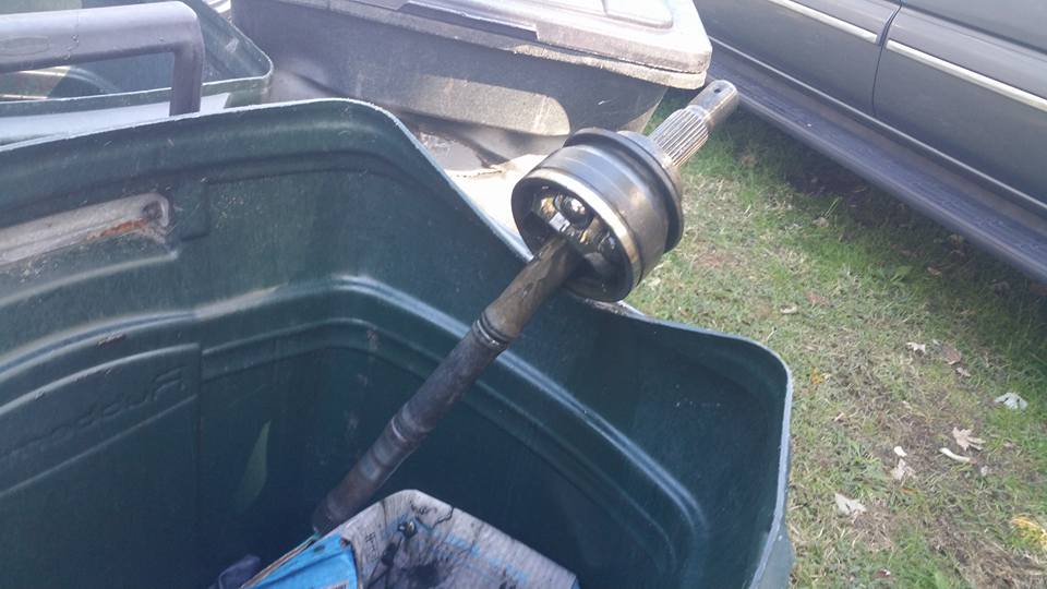

Doing some fall maintenance..
Today with great help from a friend and moral support of others,
I Removed, Regreased and Rebooted the driver and passenger CV axles.
For Grease I used military industrial grade synthetic grease.
The boots are heavy duty off road boots from SDHQ.
Its not a hard job at all, but extremely messy.
I replaced the two down stream 02 sensors.
I changed the front diff fluid to mobile 1 synthetic.
Couldn't get more detailed pics, very messy job to say the least.

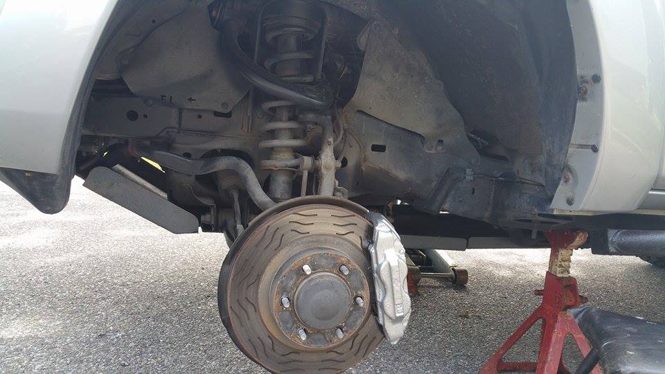

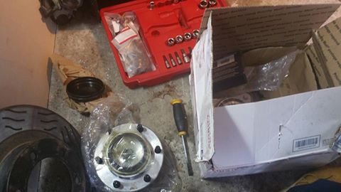

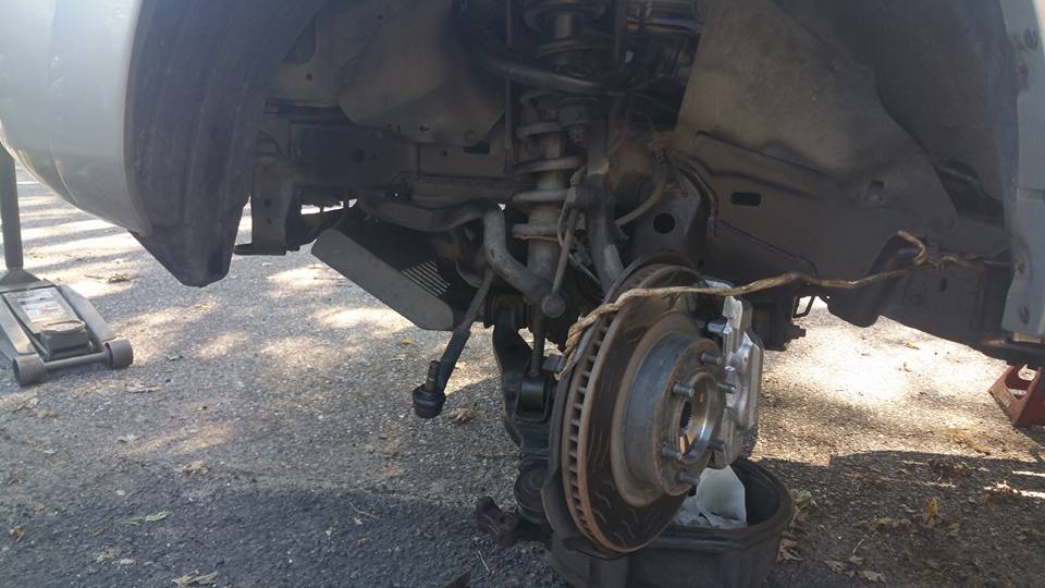

Anyway, Ive hit about 120k and The front wheel bearings basically started to self destruct to the point that they became so loud I was scared to drive. This took about 3 months of ignoring it to get to that point.
I Ordered the wheel hub kit from NJ636. Great product! Fast shipping!
Easy job, took a few hours going slow and taking breaks. Rides like a new truck!
This is one you do yourself. Difficulty level out of 10. was about 4.

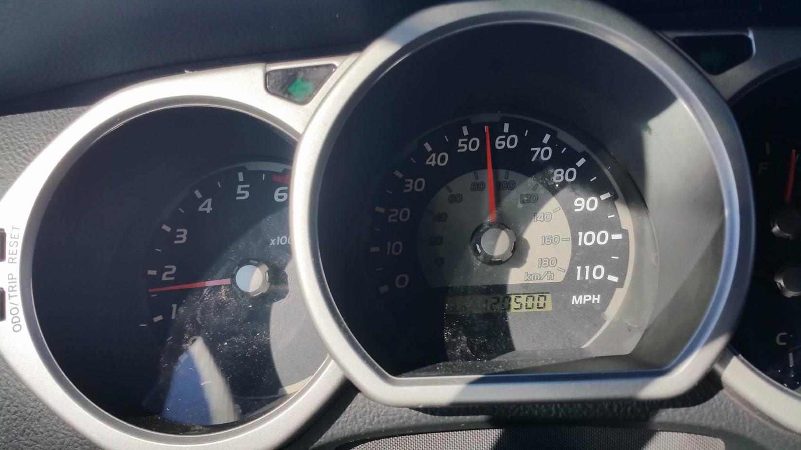

3/21/16
A few days old already but:
Picked up the truck from Riverhead Toyota with my newly installed dash, which came out perfect. Transmission fluid Drain and fill. Probably first time it ever got it. Had them look over the entire truck and make a list of recommendations. Came back with nothing to note. Also just hit 120500k..

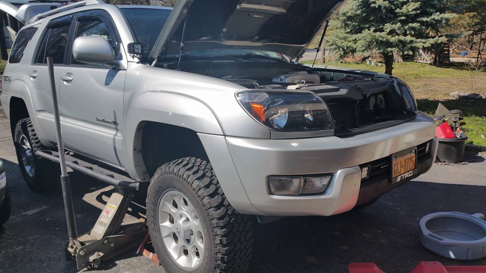

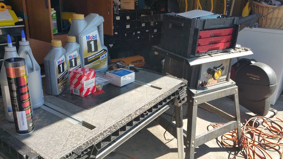

Some spring maintenance:
Oil changed
Fumoto oil valve installed with hose extension
Transfer case fluid changed to mobile 1 75w90
Greased driveline and swaybar bushings
Rust prevention and under body paint touch up
