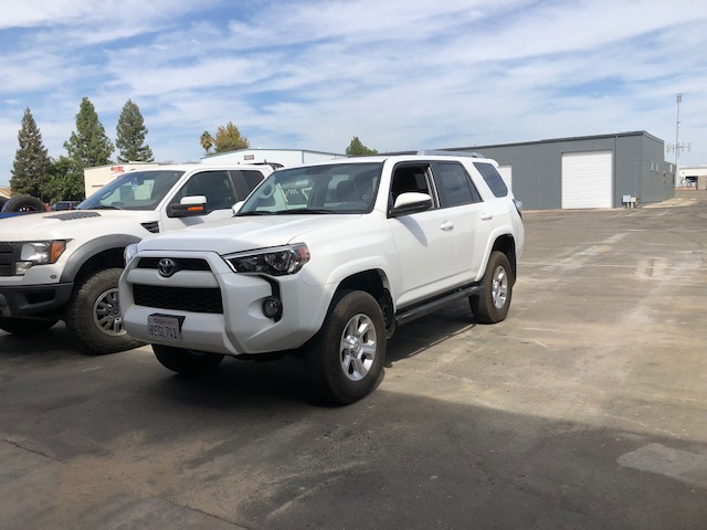

I have the front set for 2" and the rear with 2" springs with 265/70/17 Grabber AT2

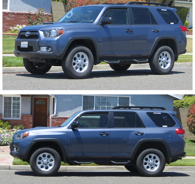

I'm at 0.85 with no spacer in the rear. It looks almost level, a slight rake. If I went to 1.75, I would go with 1 inch spacers in the rear. Should be almost level, with a slight rake. IMO 1.5 spacers would be too much.
I also have AirLift bags for when I add a load to keep it level.

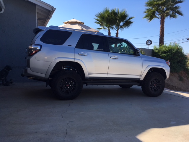

Look up threads with my pics... I’m at 1.75 front and 1 inch rear spacers...

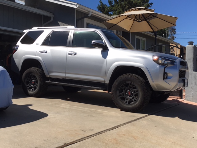

not exactly what youre asking but.... 1.75 up front, 1.25 spacer in rear. On stock 265/70/17's (for now)
socalka-albums-socalka-s+runner-picture51652-t4r-carwash-5100-bilstein-1-75-front-1-25-spacer-rear.jpg
