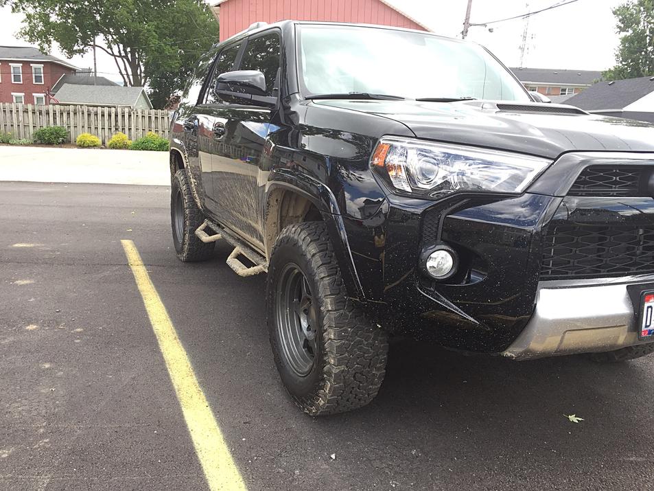

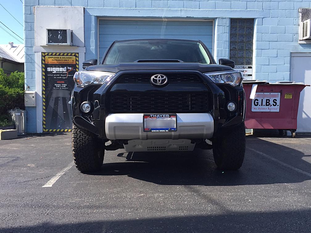

Love this set up, front set at second notch and stock rear with Bilstein B8 5100. Actually lifted the front 1 1/4" on both sides and I do not see any lean. She looks good and I am stoked.
Can you measure from center of the hub to your fender? I just did 5100s and notice no lift after measuring before and after. I see 20.5" on stock size ko2s. I set the fronts to the second notch so it should be .85
That's a sharp looking 4Runner! Can I ask, what size KOs are you running and what crossbars do you have on your roof rack?

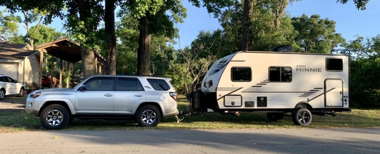

Was thinking about doing the same thing ,have a set of 5100’s ready to go but once I hooked my camper with a weight distributing hitch to mine it’s almost level,looks about 1/2” high in front .
That’s a nice setup, but it looks like you’re low in the back a lot more than 1/2”. Don’t use the fenders as the guide for that. Look at the frame. It could be the pic I suppose. If the hub to fender measurement is even front and back, then you have reverse rake. Airbags or helper springs (Timbren or Sumosprings) would help you out when towing even with the WD hitch. You have the hitch dialed in correctly?

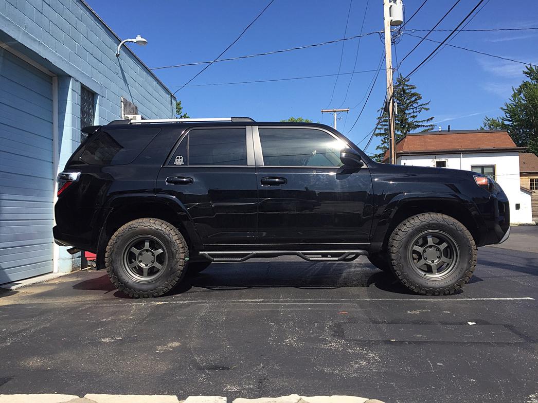

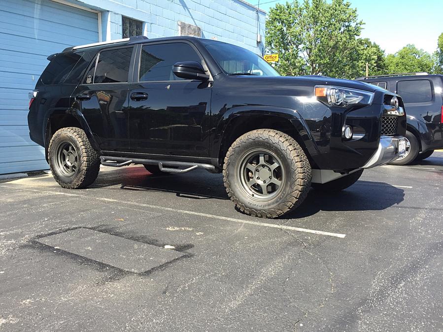

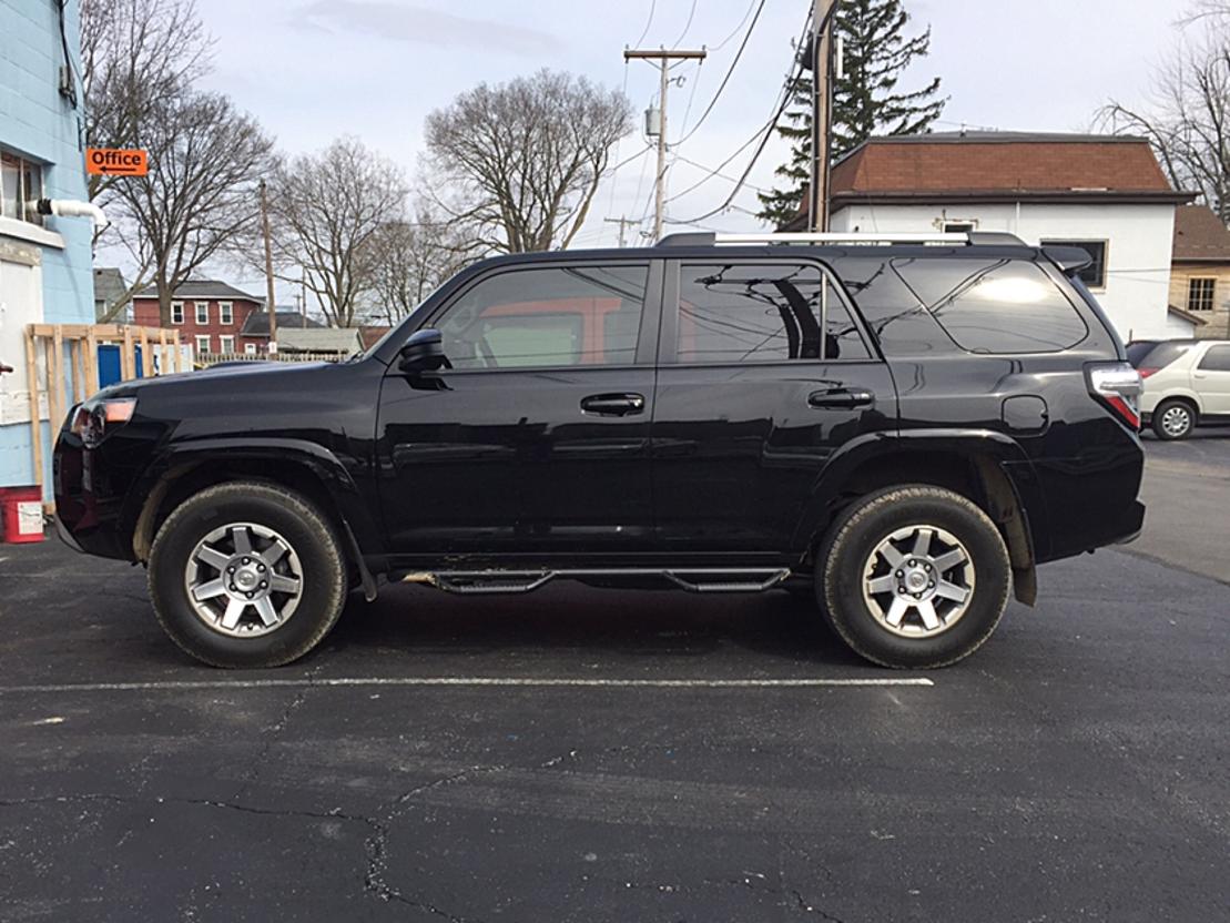

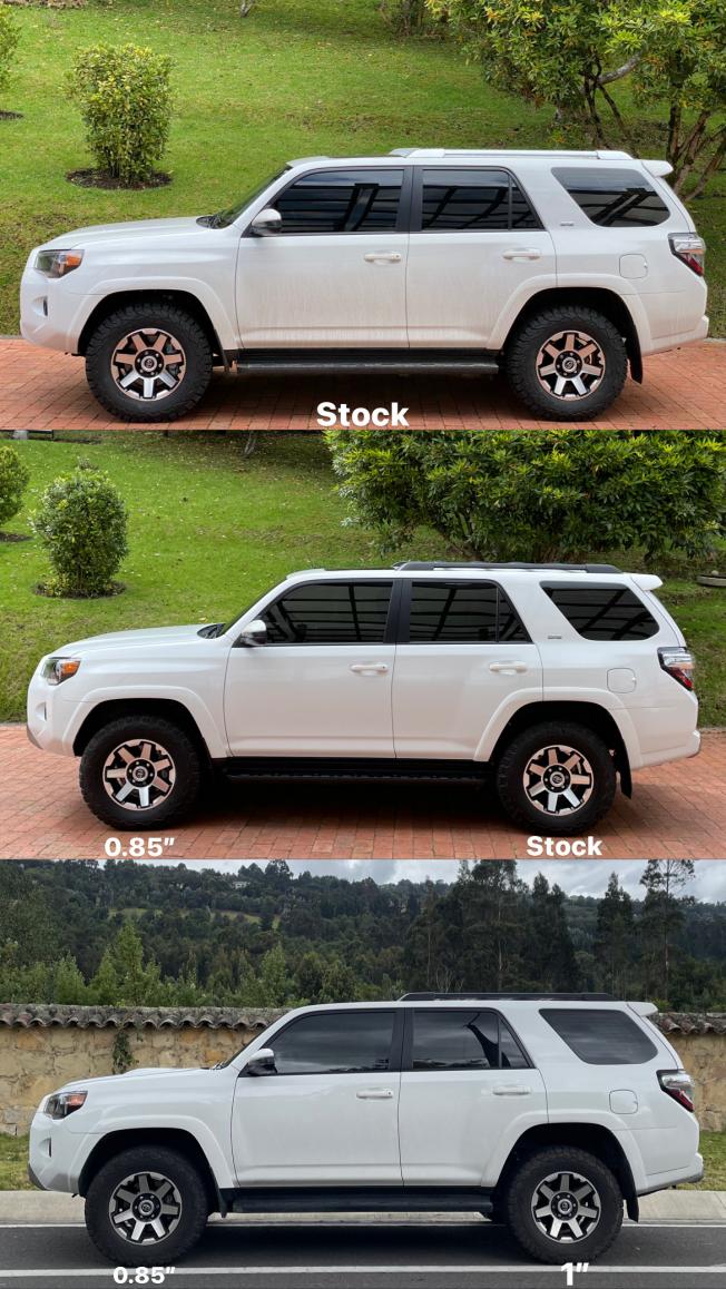

For anyone that likes factory rake (or hate reverse rake when loaded)
This is my 4Runner,
First picture is stock.
Second one is Bilstein 5100 in all four corners with only the front leveled up to 0.85”.
Third picture is 0.85 in front and 1” Bilstein springs in the rear.
In all pictures: TRD OR stock wheels and BFG KO2 265/70R17 tires, no spacers.
I’ll need to change tires soon and I’m considering 275/70R17, do any of you guys recommend this size of tires for my setup or is there anything I should consider? Thank you
This is my 4Runner,
The last one looks perfect for me. I daily drive mine all over for my business so I don't want a huge lift. I was looking at the 6112/5100 or 5160 with 1.6-1.75" in front at around 2" in the rear but I want to use 265 ATs and am worried it'll look goofy. Yours looks perfect.
