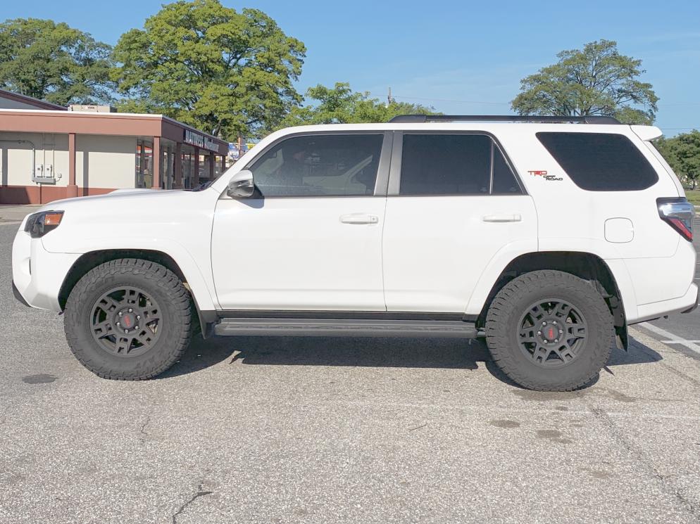

275/70/17 with Bilsteins up front at .85 and stock rear. Still had to trim a small part of the bumper after install.

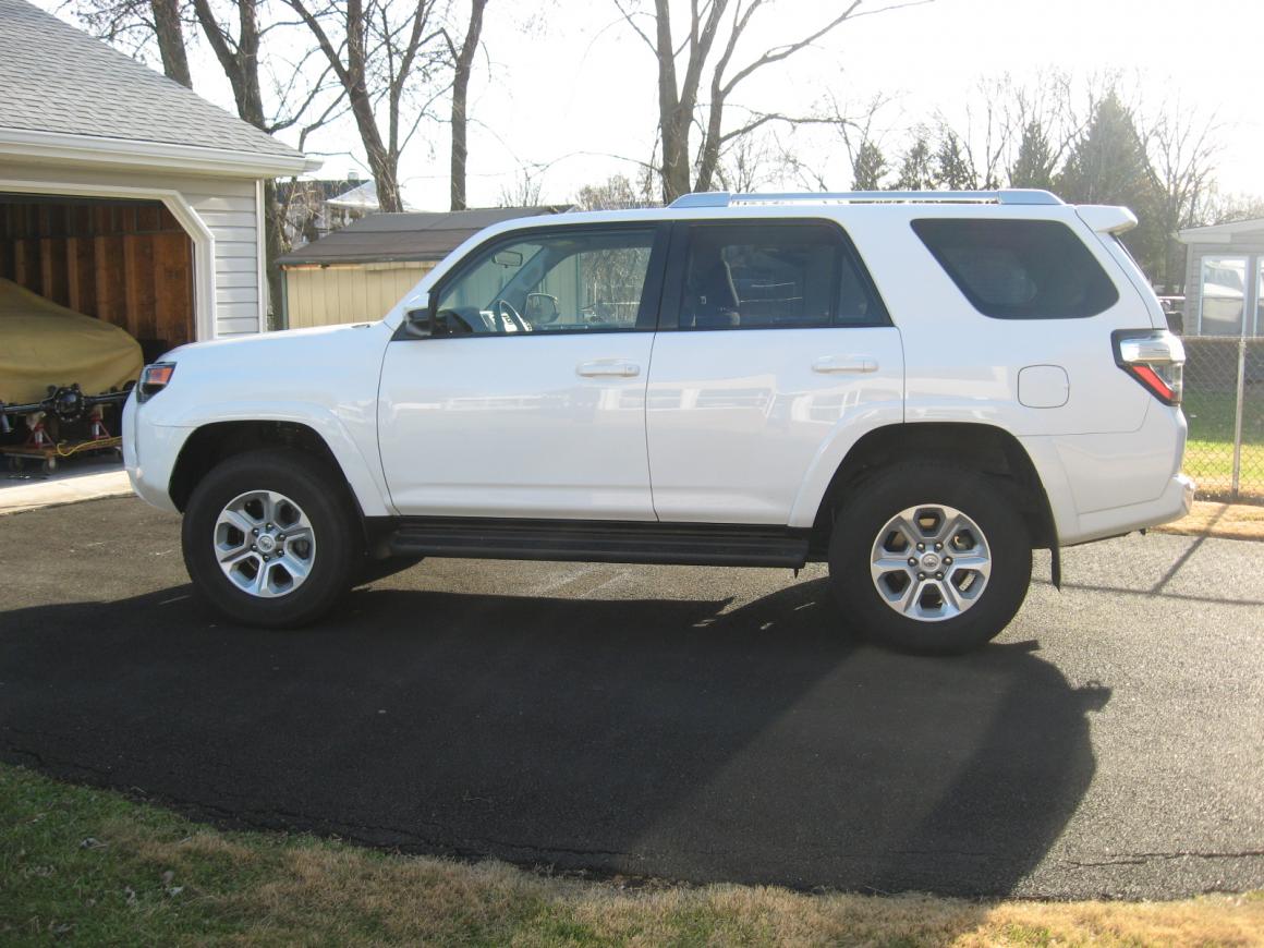

I'm sure the .85 community has seen this on some other thread, but anyways here is my .85 with 265 KO2s ....The KO2s help fill the well nicely ...add about 6 lbs per tire compared to Dunflop. In general the ride is stiffer, but also handles better

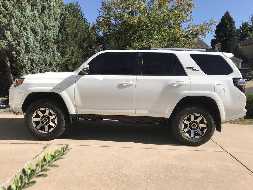

Here are two quick ones from my iPhone this morning. Tires are stock size. K02s and BD Squadron fogs are next.
Re: The driver side lean being discussed, I’m going to go park it on level ground and take some measurements but the way it’s parked in the photos, it’s noticeable. I’ll give it some time and decide on adding a spacer to compensate.

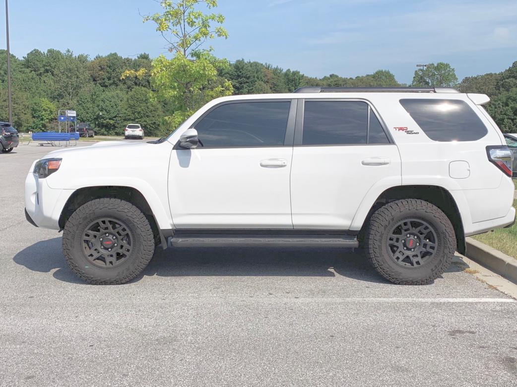

275 KO2s are on. E load range is no issue at 38psi.

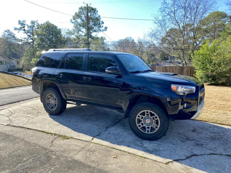

Love the look but already kinda wish it was a 1.10” setting instead of .85. If I tire of it, I’ll switch to 6112 and add cornfed rear spacers. Maybe a tiny spacer on FL for lean comp.

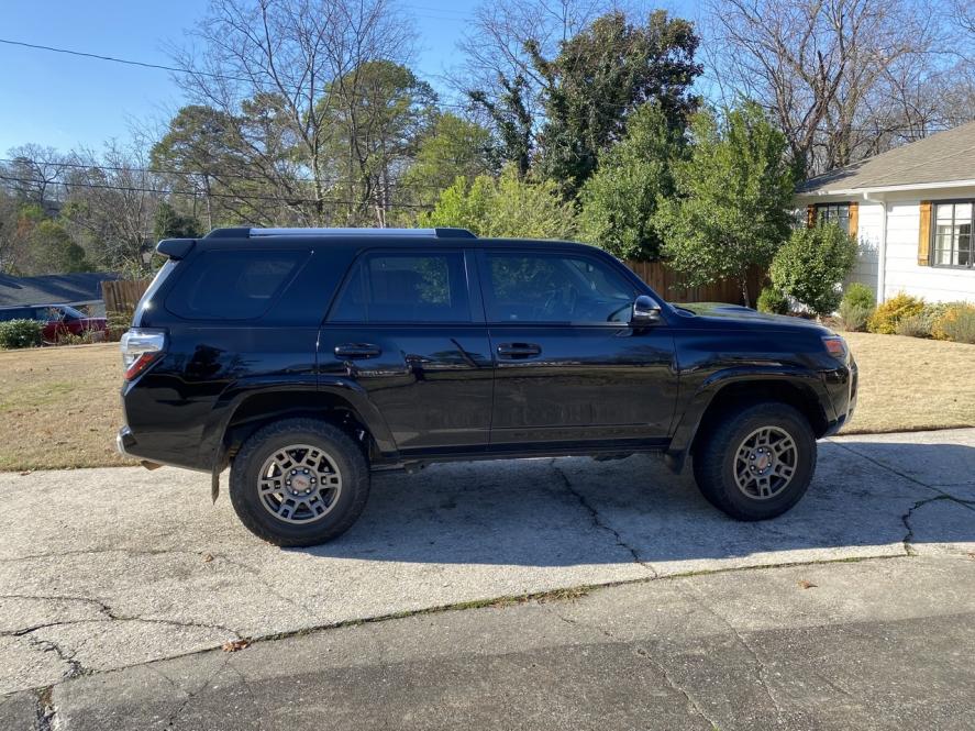

I guess I should have done a search before installing. I went with OME springs and put the fronts on the highest setting. It rides horribly and bounces under 40 mph, as the shocks clearly have way too much pre-load on the springs. I ended up having to swap out the rear OME 895e for a set of Icon springs, and still had to add a 1" Cornfed spacer in the rear. I guess I'm going to have to remove the fronts struts and lower them a few notches, as it still sits a 1/2" low in the back. You can see in the last pic the height difference between the stock/OME/Icon rear springs.
Highest setting on shocks with OME springs
Icon springs with Cornfed spacers on the rear
Spring comparison
I guess I should have done a search before installing. I went with OME springs and put the fronts on the highest setting. It rides horribly and bounces under 40 mph, as the shocks clearly have way too much preload on the springs. I ended up having to swap out the rear OME 895e for a set of Icon springs, and still had to add a 1" Cornfed spacer in the rear. I guess I'm going to have to remove the fronts struts and lower them afew notches, as it still sits a 1/2" low in the back. You can see in the last pic the height difference between the stock/OME/Icon rear springs.
This is exactly what I wanted to do with mine (2.5" setting front, OME 895e rear and on my Limited as well). This is probably a stupid question, but could the reverse rake be caused by the weight of your bumper? Also, do you think there are specific springs I could use for the rear instead of having to add spacers? Thanks in advance, I'm pretty new to these things.
