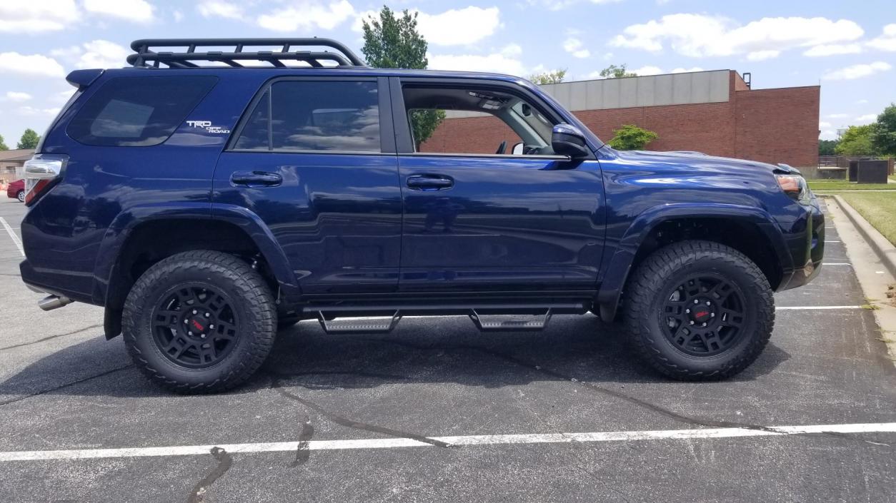

I lowered the fronts down one notch to the 1.75 setting with the OME front springs today. You can see it still sits just a smidgen stern heavy. I plan to build a full replacement bumper for the front and add a winch, so in my application I think it will level out perfect. It definitely doesn't seem to bounce as bad at low speeds with less pre-load on the front now. If you don't plan on adding a bunch of weight to the front, I would highly advise sticking to the .85 setting as many others in the thread have suggested. Just wanted to update you since I decided to drop the front this morning.

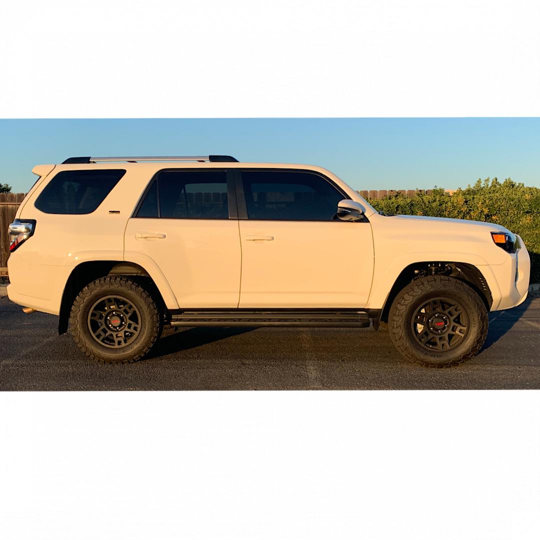

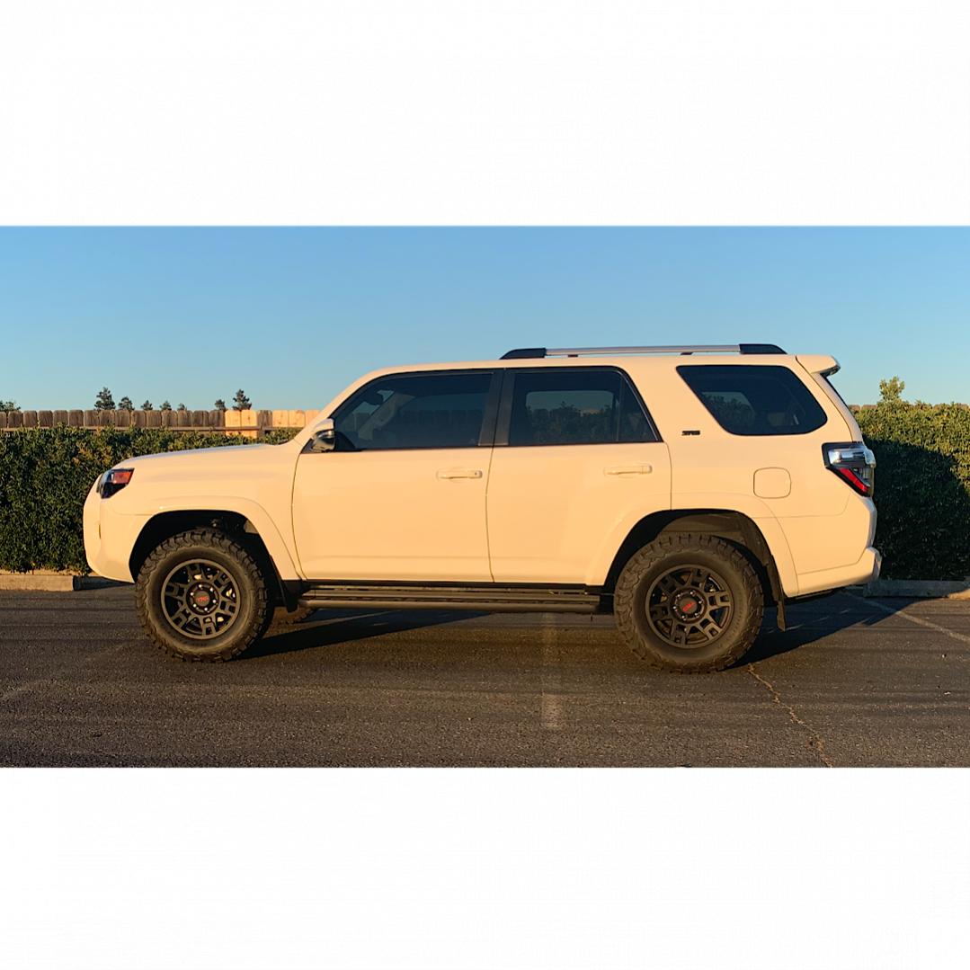

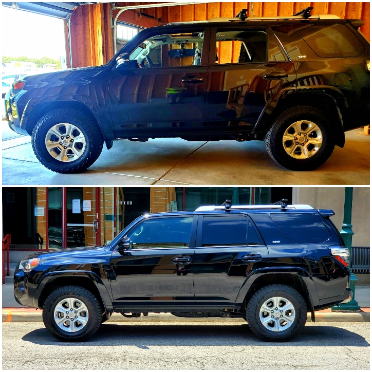

Just did the install with a buddy over the weekend. 5100 all around, 0.85" front / stock rear, factory coils. I am absolutely ecstatic about the ride quality. Feels like I traded in my '87 hoop-d for an actual 4runner.
Here is before/after
Looks great and I felt the same way!
Hands down, this is the proper set-up for a 4Runner!

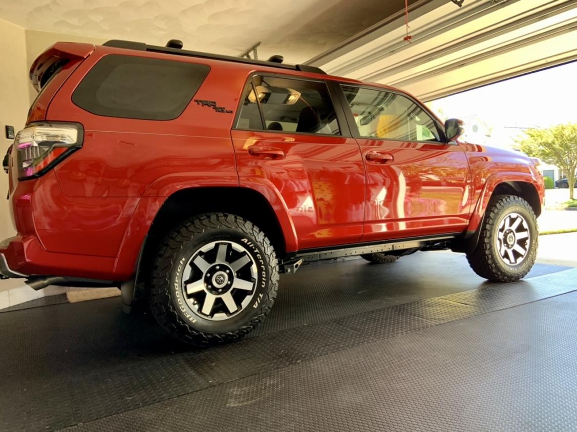

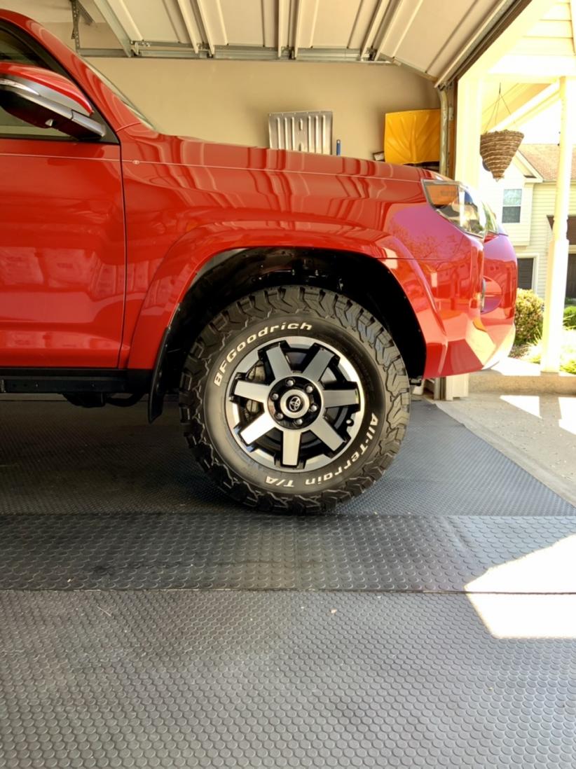

2020 SR5P. 5100’s on all four corners with stock springs. Front set to 0.85”.
Ride quality and control is amazingly improved. If I had to put a number on it, I’d say it got rid of 80% of the nose dive. Keeping in mind it’s a 4 wheel drive SUV. May have to do something with the lean, eventually.
In garage top of wheel opening, before.
Driver front 34 5/8”
Pass front 34 7/8”
Driver rear 36 3/8”
Pass rear 36 1/2”
In garage top of wheel well, after @ 0.85”
Driver front 36”
Pass front 36 1/4”
Driver rear 36 1/2”
Pass rear 36 3/4”
Frame DF 14 1/2”
Frame PF 14 3/4”
Frame DR 14 1/2”
Frame PR 14 3/4”

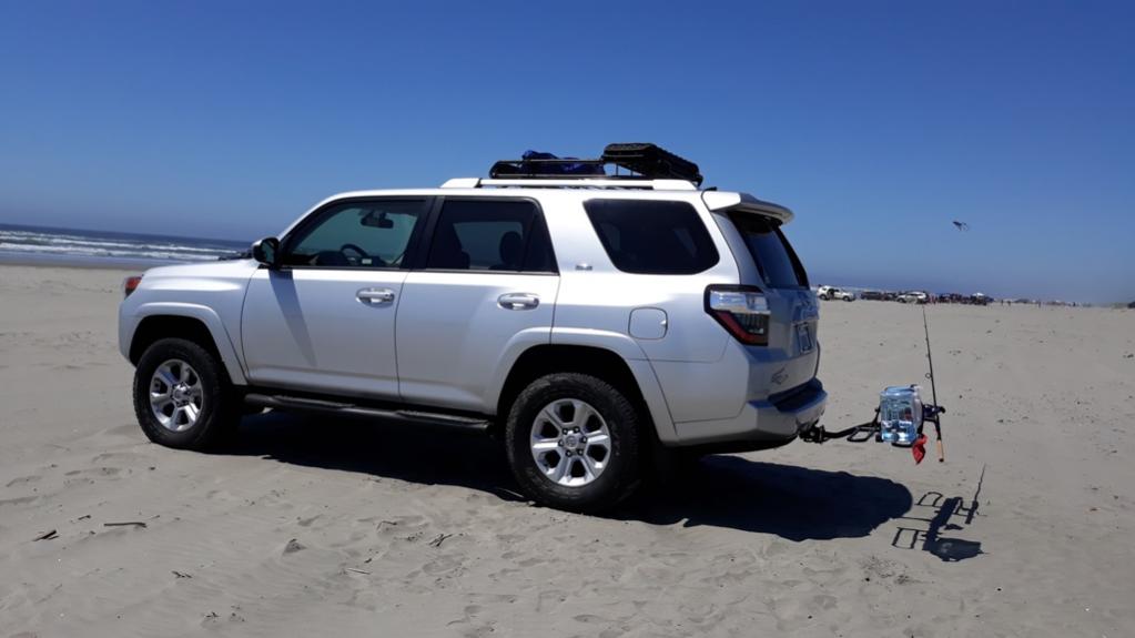

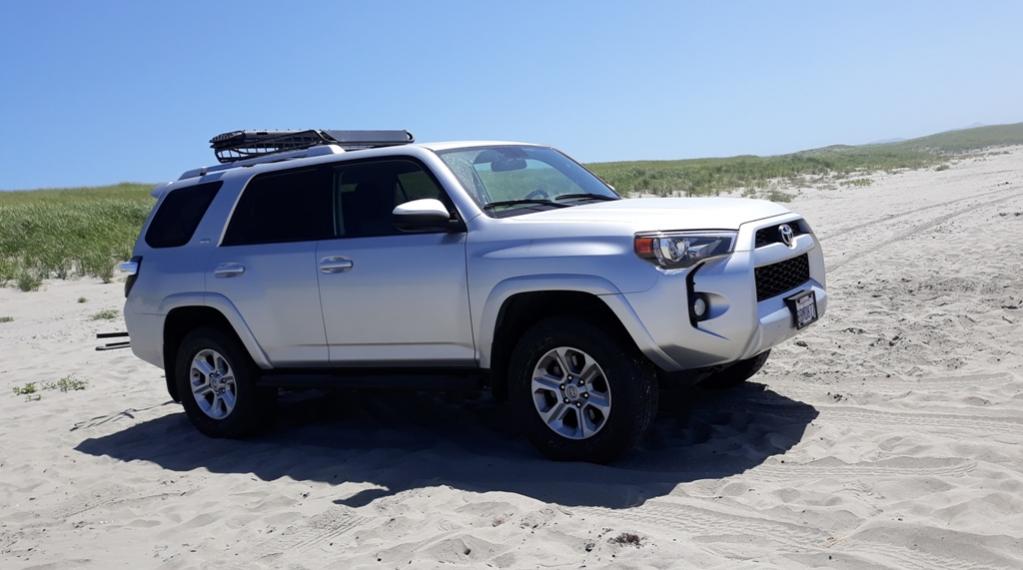

Bilstein 5100 front and back, stock coils, front set to .85
Nose high when trunk is loaded specially while driving, my truck is pre-loaded with 3rd row seats and with passengers in the backseat I'm ridin with a reverse rake. So I might move the front to 1.75 and change to longer rear springs along with 275s tire upgrade. Or, I might try airbags for my rear coils to help with rear cargo weight during outing trips.

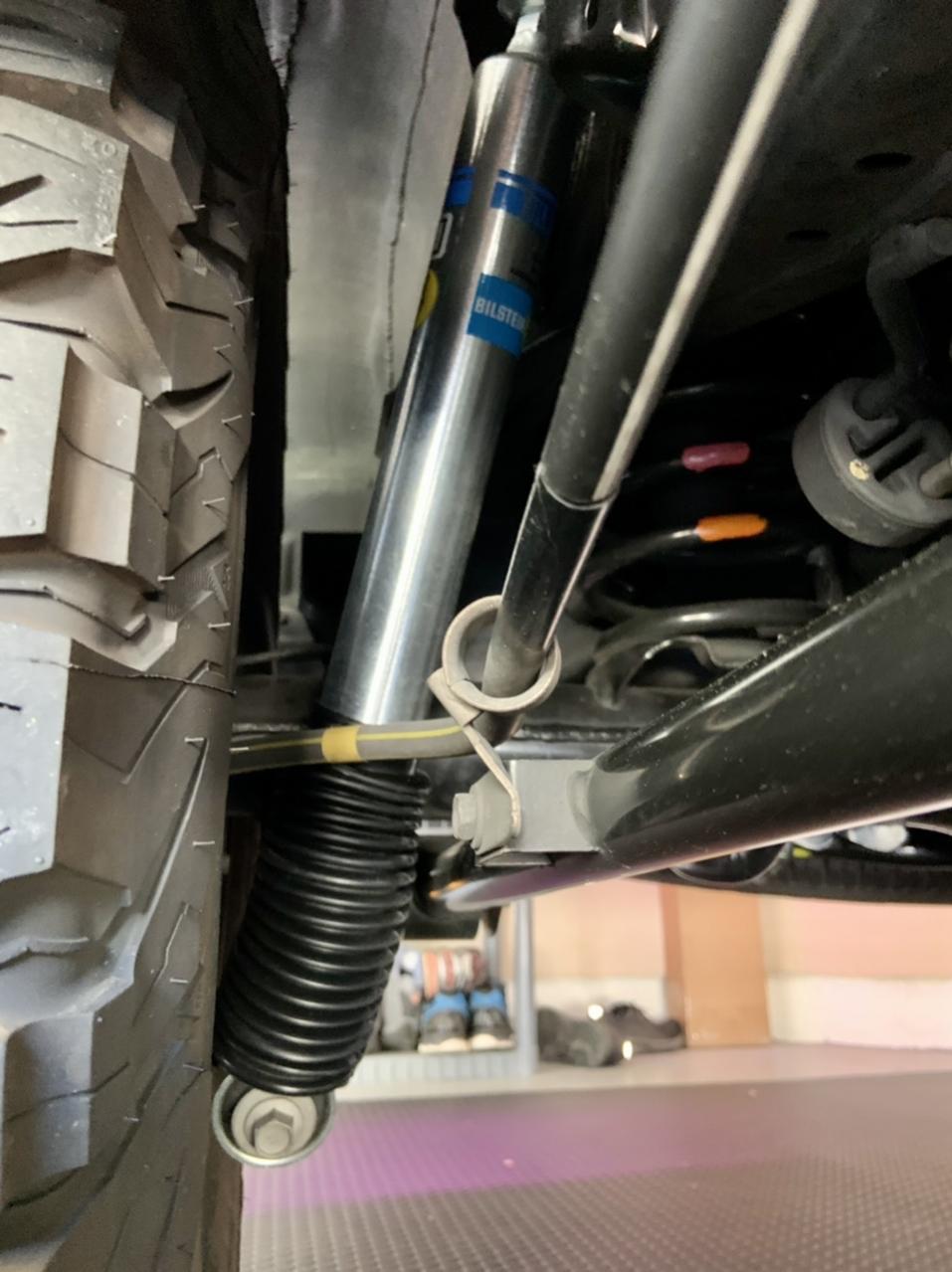

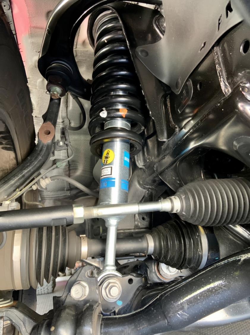

Bilstein 5100 on 2019 TRD Off Road Premium w/ KDSS
Love this set up, front set at second notch and stock rear with Bilstein B8 5100. Actually lifted the front 1 1/4" on both sides and I do not see any lean. She looks good and I am stoked.
