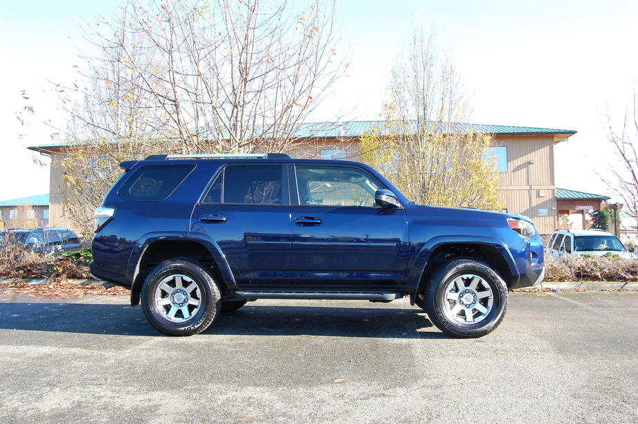

One of my turn signals went out on me, and while I was under the truck, I noticed the PO added Bilsteins to the front. I always like the stance.
Here is the stance. KDSS and Bilsteins.
