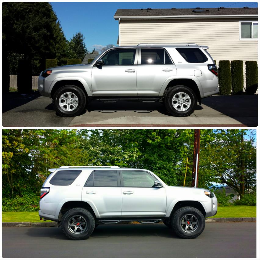

Actually I believe the highest setting is 2.5" And if you don't do something to raise the back to match don't forget to reset your headlights. I went with 1.75" on the front and nothing in the back and my high beams were pointing at the trees. 1.75" front and 0 rear will give you a body leveled look, but a slight reverse rake if you use the frame as your reference. This is mine at the dealer right after that setup.
Some pictures for reference:
Top: 5100s front set at 1.75" and a 1" Cornfed spacer w/ stock wheels. All stock coils. Level driveway.
Below: 5100s front set at 2.5" and a 1.5" Daystar spacer w/ 285/70/17 17x8 ET0 offset wheels. All stock coils. Lot not leveled.
