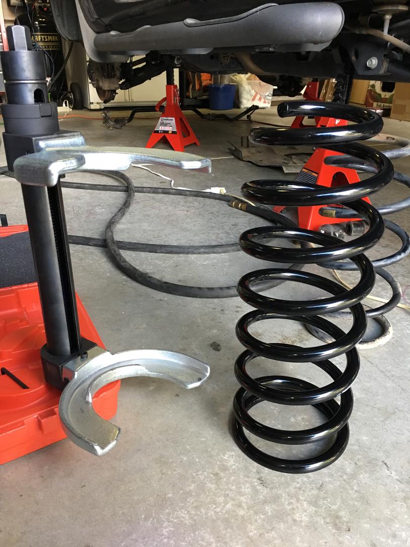

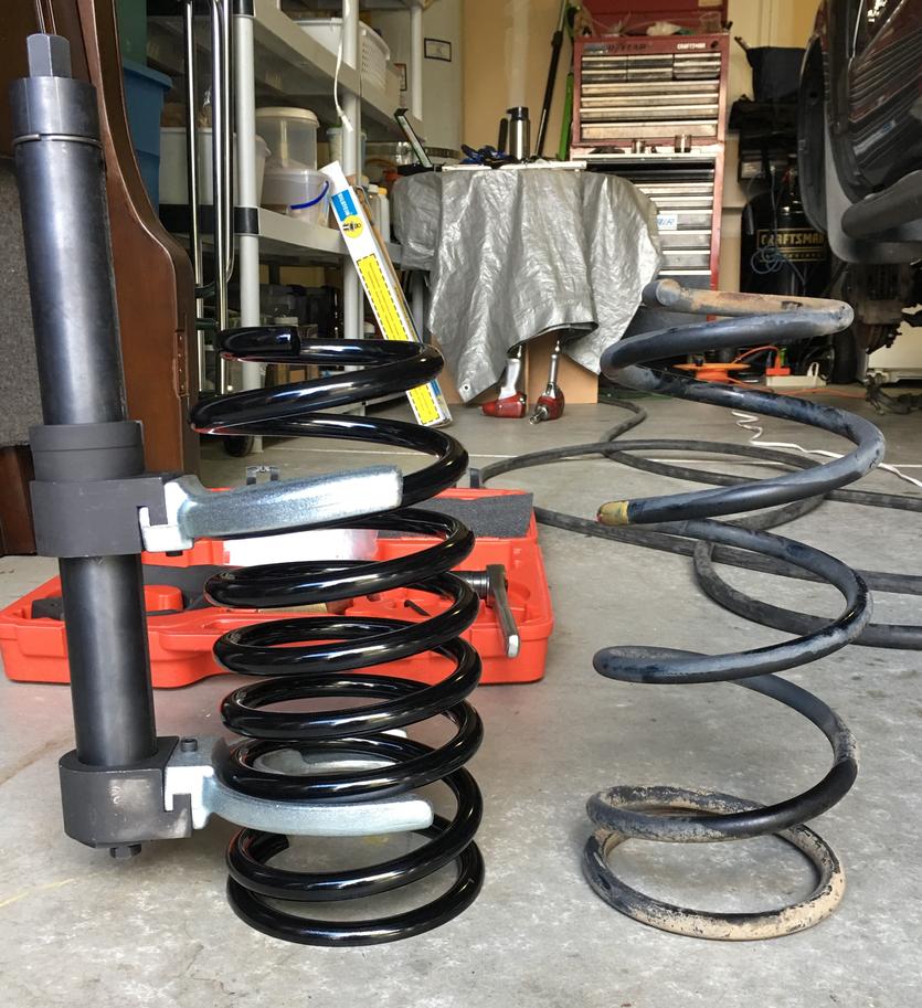

Hi superman3043, it worked out great. I did install the springs first. I just tried the shock fitment/alignment first. (I love my spring compressor.)
I had to position the compressor differently on each side and inserted the compressor it at the lowest coil near the axle.

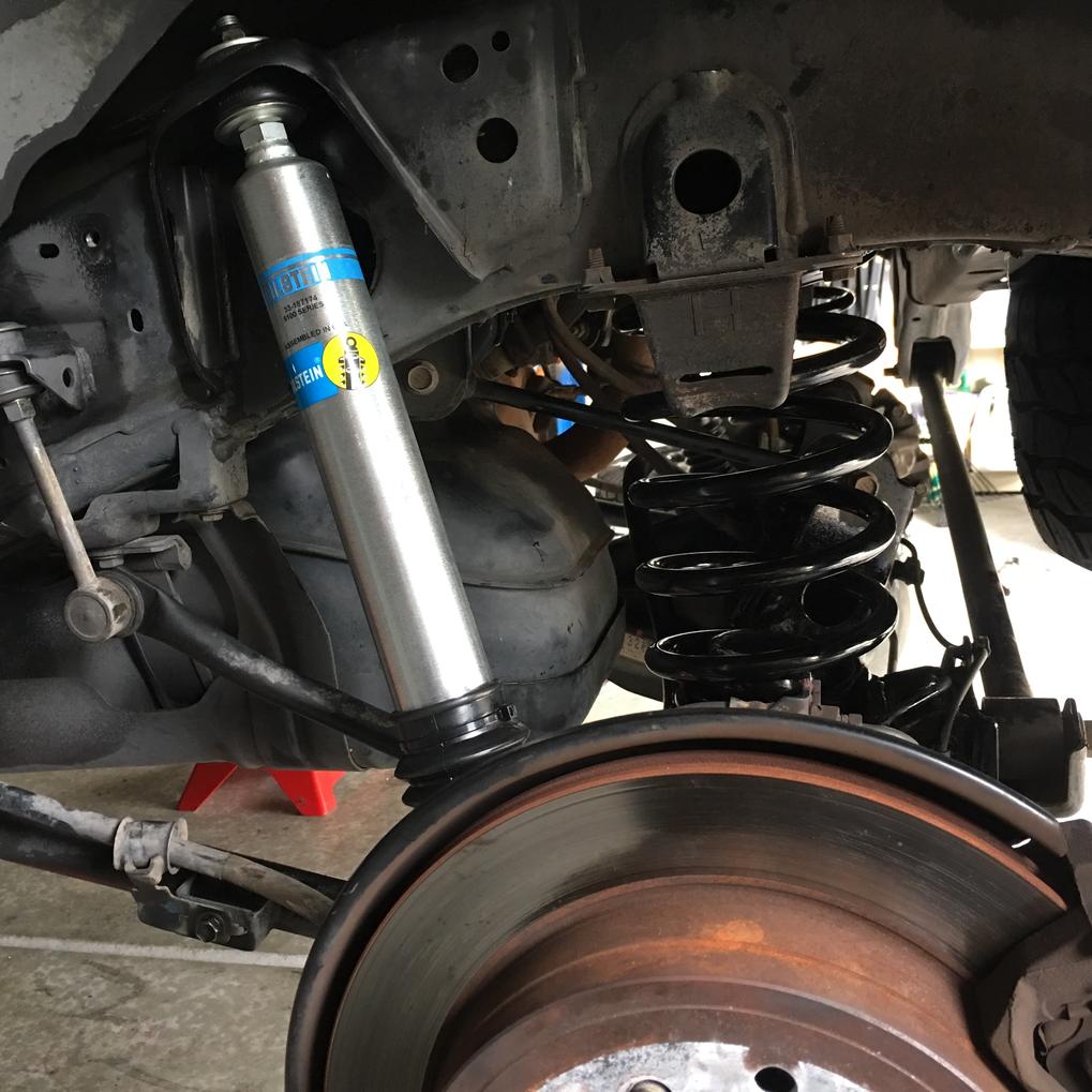

I did have to flex the shocks a bit however it all worked out just fine. The truck looks great and rides great.

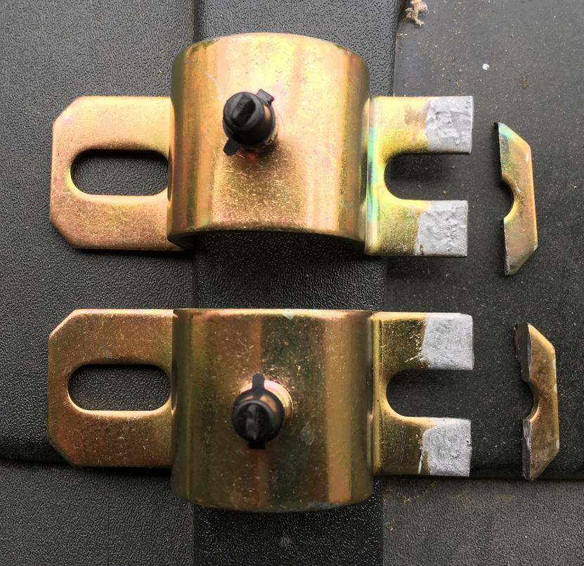

I also installed new polyurethane sway bar bushings front and back.
The front had to be trimmed a bit to allow the sway bar to be indexed the same as the original the cut end facing the back of the truck. I didn't tighten the rear sway bar until the truck was fully on the ground.

Info on that spring compressor? It looks neat. I've only been able to use these Macpherson Strut style compressors with moderate success on rear coils. I own one of these Clamshell style compressors and this thing has been a worthless piece of junk. Besides the big shop style, I've not been able to use much on front coilovers.
Glad it worked out for you!
This thing works really well and its a beast I had no fear at all that it could not handle the task. It's a 34lb. kit.
https://smile.amazon.com/gp/product/B01NH7GNP6/ref=oh_aui_detailpage_o05_s00?ie=UTF8&psc=1
