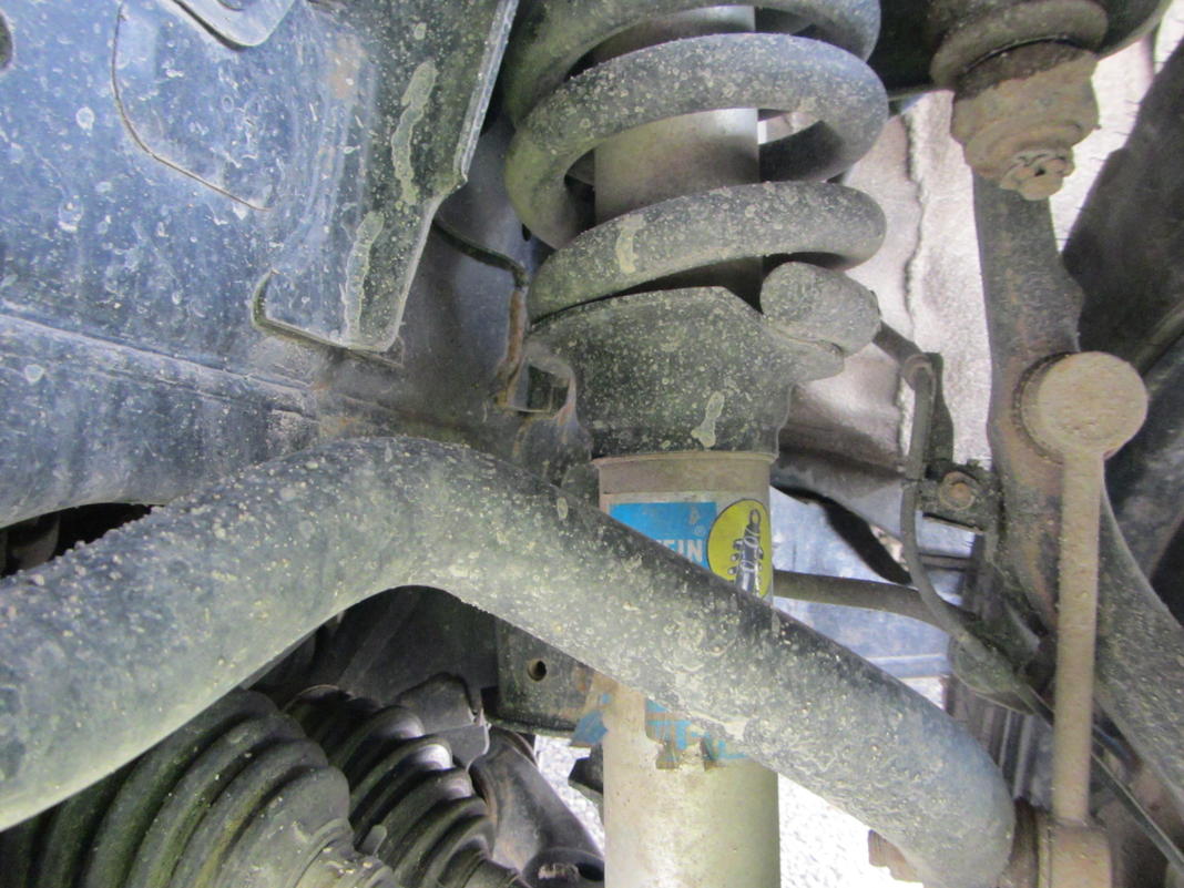

Does anyone have a picture of the spring seat of their bilstein 5100. It looks to me like mine was installed upside down.
It IS installed upside down. That black perch should be the other way, it slides over the C-Clip and basically locks it in from popping out of the slot. The way that one is sitting the only thing keeping that C clip in is the c-clips own inward pressure. Get that fixed ASAP!
That is like 2 extra inches of lift too, I bet that was ***** to install upside down like that.
