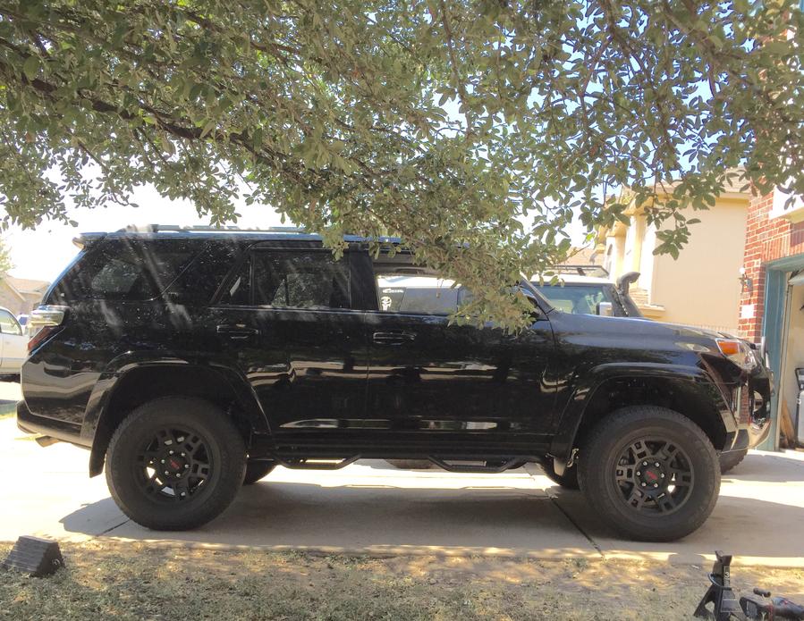

After

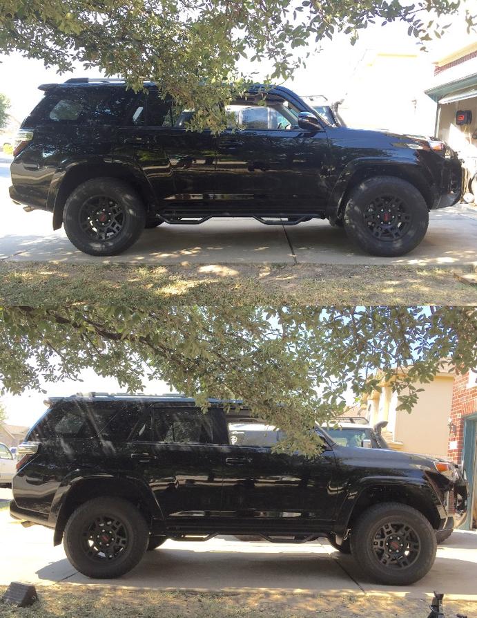

I was expecting a stiffer ride but I would say it's almost as smooth as the stock suspension. The brake dive is almost eliminated and the car hardly rolls during cornering like it did before. However, you do get a bit more wind noise during highway speeds. While the suspension was being installed, I did the front liner mod for added insurance since the car was already up. Very easy to do and no rubbing noticed. For anyone wanting to do the max setting on the 5100s I highly suggest it and glad I did instead of the 1.75" setting.

I really like the wheels I got. Only reason why I went with spacers. I think it's more so for asthetics as its pleasing to the eyes with the wider offset.
spidertrax... for me, it's all about cost vs wants... I'm happy with the stock rims. In fact, I prefer a more "stock looking" set-up with just the right amount of changes to my preferences. For me, less rake/more level stance... and a wider stance as well. But the TE already has a slightly wider stance than my other two previous 4R's, so I may just leave as-is. But the spidertrax is a great option for only a few hundred bucks.
Looks good... not sure I would have used an air ratchet on the spidertrax, I prefer torque wrench driven by hand
Looks Good. Youre gonna need to trim the front bumper a lot and remove mud flaps so you're not rubbing. Well, at least thats what I had to do ;-)
