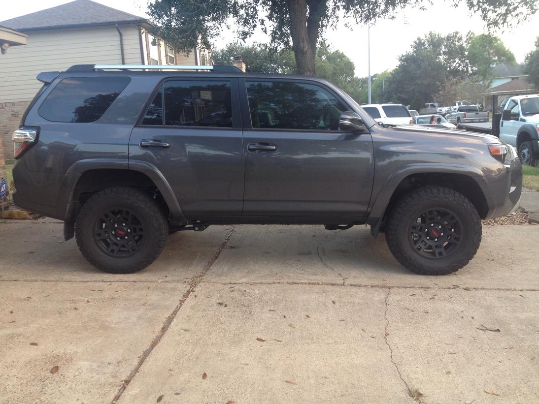

i just installed 4 bilsteins at 1.75" with a 1" cornfed rear spacer. have the spidertrax 1.25" but have yet to install them (this weekend).
posting a (crappy quality...) before and after profile and front, also for use as comparison between the OPs 2.5"/1.5" and my 1.75"/1"
gains after alignment (measured on full tank) = 1.75" front and 1.25" rear, 0.25" lower front and back driver side
Edit: added an after front-pic with the spidertrax installed, so now in order of stock vs bilsteins vs bilsteins/spidertrax

Here is a comparison picture of the two to better see the difference.
Definitely like the look of the stance you have there. I am thinking of setting the 5100s to 1.75 as well. On the rear, I have 10mm OME spacers and rear 5100s. This gives about .5 in of lift in the rear. I'm wondering how combination would look. Some pics show a nice positive rake, some level, and some with a negative rake.
I also like the look of [MENTION=118406]Haydenatx[/MENTION]'s stance too with the front set at .85.
I'm running 265 Cooper AT3s for reference.
