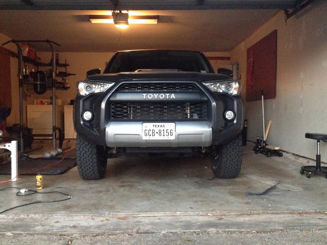

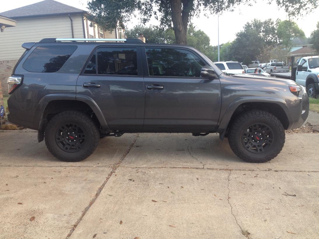

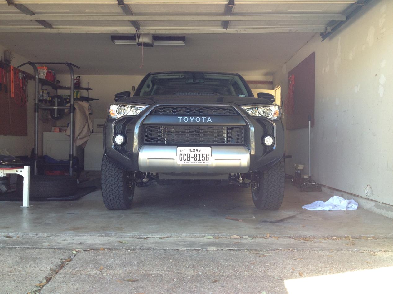

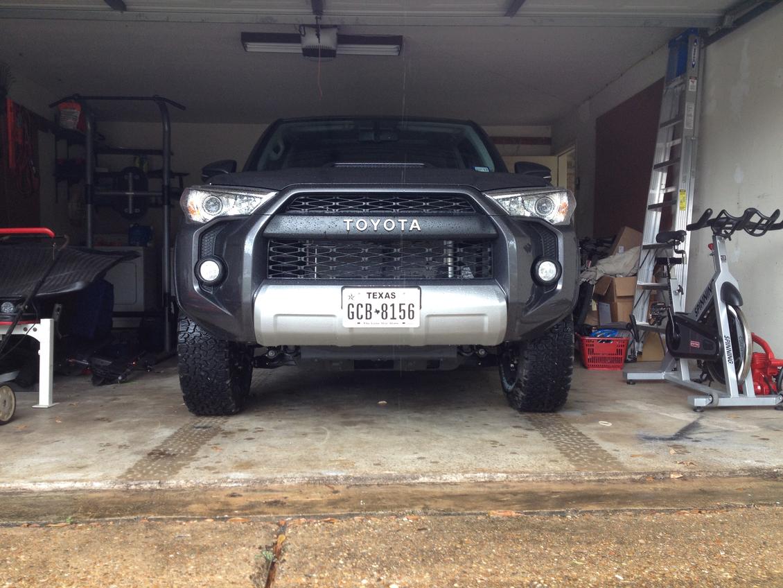

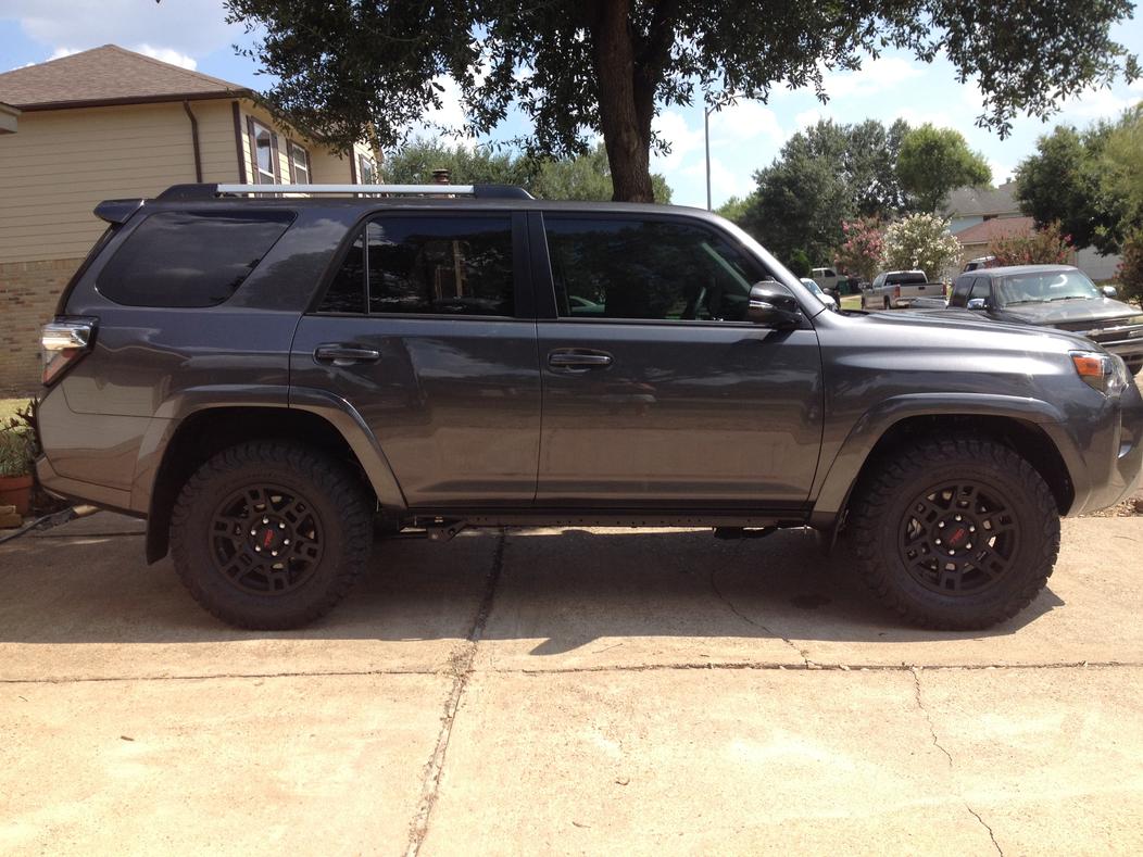

i just installed 4 bilsteins at 1.75" with a 1" cornfed rear spacer. have the spidertrax 1.25" but have yet to install them (this weekend).
posting a (crappy quality...) before and after profile and front, also for use as comparison between the OPs 2.5"/1.5" and my 1.75"/1"
gains after alignment (measured on full tank) = 1.75" front and 1.25" rear, 0.25" lower front and back driver side
Edit: added an after front-pic with the spidertrax installed, so now in order of stock vs bilsteins vs bilsteins/spidertrax

i started w/ 2.5" difference in F/R fender height and had a pretty noticeable rev rake to the frame w just 1.75" up front. fenders looked even tho
i'll also note that my pic is on a slanted driveway, which is making it look slightly askew
the AL RCI front skid is 18lb, not gonna effect anything, i think all their skids combined in AL (including gas tank) is only about 120lb
either way you go up front (2.5" or 1.75") i would add a rear spacer, but that's just my opinion
