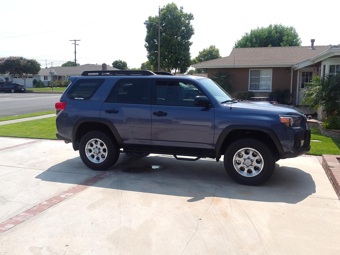

5100s
Front set to 0.85, rear stock with Air Lift bags at 5 psi, looks close to level. If rear sags with load will bring up with Air Lifts.
