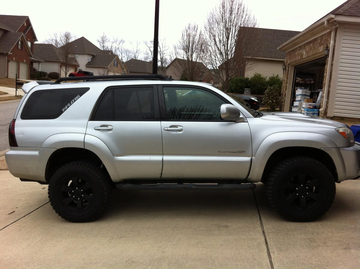

Did this set up yesterday... Except mines a v8
How does it ride?
Because I kept the stock coils up front, I can't tell a difference at all from the xreas... I think it soaks up bumps a lot better but I don't really see any body roll and its not all floaty like what is typical with lifted trucks and I don't think it's any stiffer... And with what you were saying about maybe getting a bumper in the future, I think this is the way to go until then... I still have a little rake but I knew I would... Only suggestion is of you care about that you could add a 1/4" spacer up front
