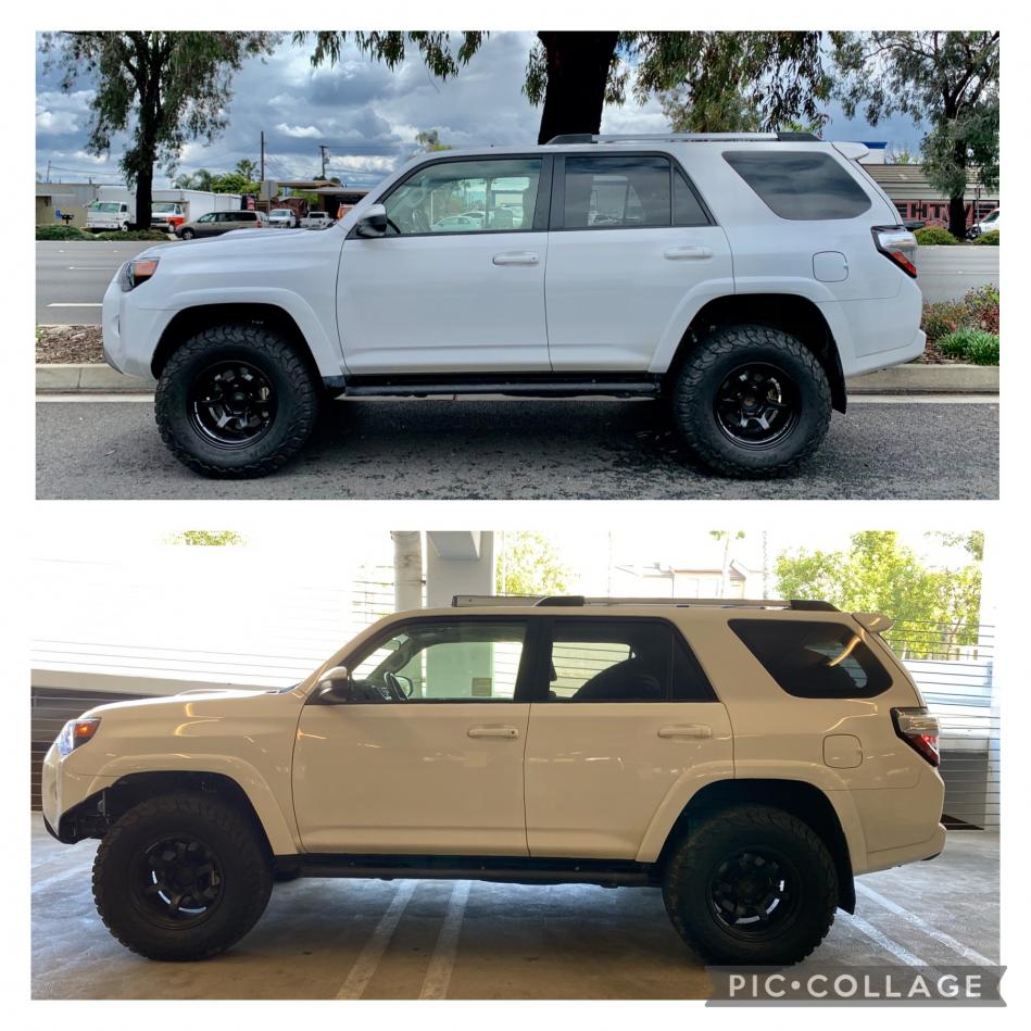

6112’s up front at 2.5”. 5160’s out back.
Top: 2.5” Wheeler’s T12 springs
Bottom: 1.5” Wheeler’s T13 springs (which I still currently use)

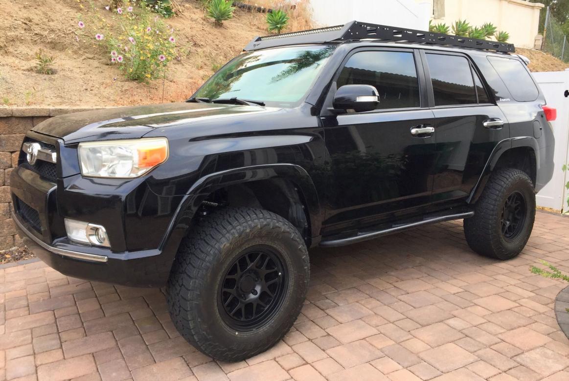

I have the 7/5 6112's but w/the 650lb springs up front, Dirt King UCA's, and Ironman 4x4 2" HD springs in the rear. The 5160's are not valved strong enough for the HD springs, so will prob go to Kings at some point.
Also to note, the increased spring strength front and back give a higher stance. If you're going stock or medium load springs your truck will sit a hair lower. This pic the truck is basically unloaded except for prob 60lbs of tools.
