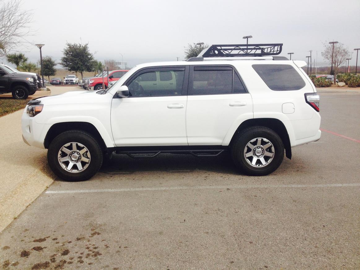

The body will look level but the frame will have a slight reverse rake. That was my original setup last year. This was picking it up from the installation. You will need to adjust your headlights down if you pursue this route.

Will adding the Bilsteins but keeping the stock rear coils worsen or reveal the infamous lean that is so common on KDSS vehicles? If so, is the workaround a single space on the leaning side?
