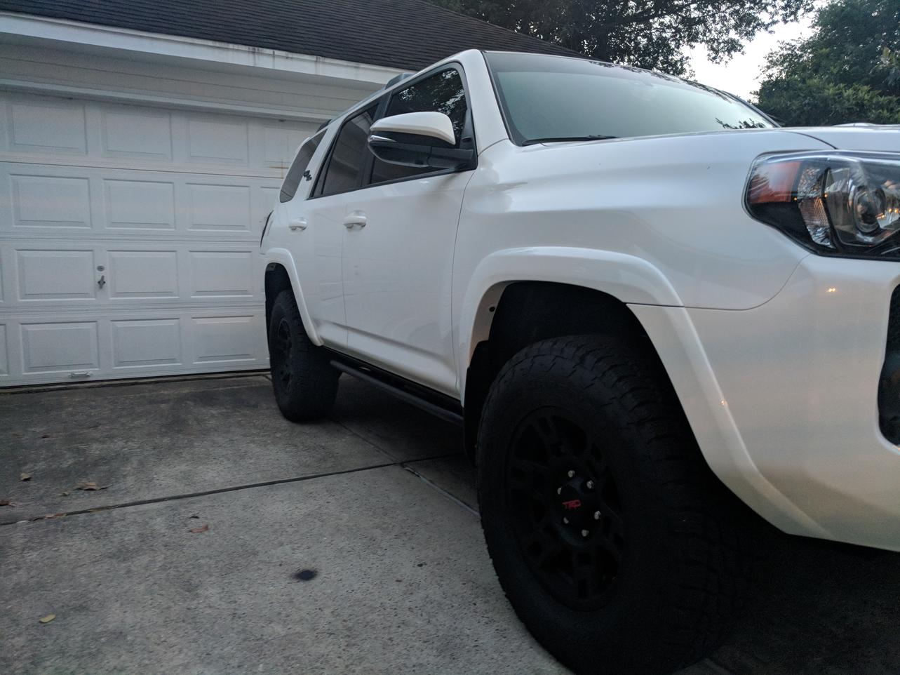

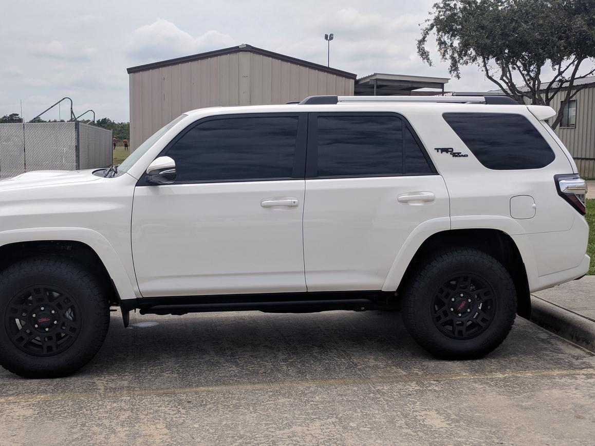

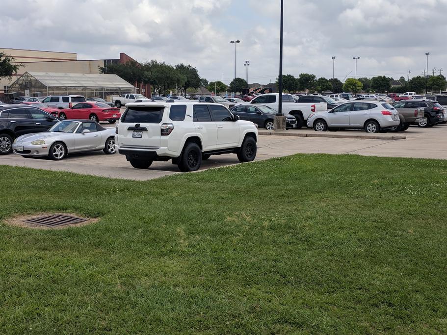

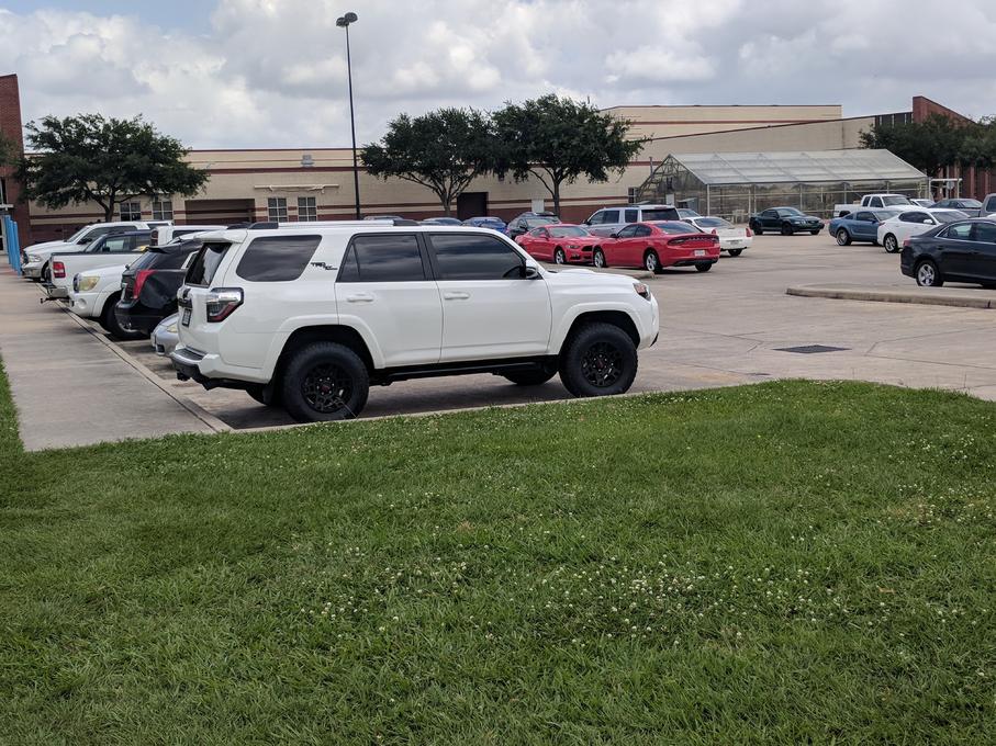

Bought this kit for my new T4R 3 days off the lot. Install was straightforward. Used the KYB top hats link a few pages back. Don't have the exact measurements in front of me, but it was right an inch lift up front.
-265/70r17 Nitto Terra G2
-TRD Wheels

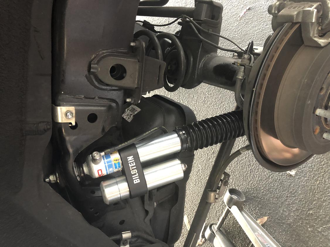

Installed the rears today
Installed the rears today since I have KDSS I purchased the clamp from 4wheel parts. Anyone else out there use this clamp? Did I install the Reservoir right?
-TRD Wheels
What sliders are those?
-TRD Wheels
You have the exact same setup as I do, I like how yours turned out and I’m nervous about adding the front spacer and rear coils for a 2.25/1.5” lift now
