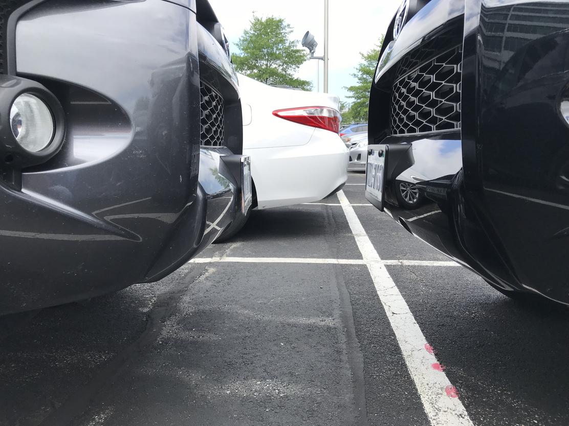

Comparison
I purchased this kit through frank motors on eBay and had it installed by my dealer. Didn’t add any additional spacers or springs that other folks have done. Parked by the other 5th gen at my lot at work for a comparison of the front end lift you’ll get with the base kit. Looks about 1” to me but I didn’t measure before / after just thought I’d share the pic. So far so good and def handles a lot better, well worth it for the price.
