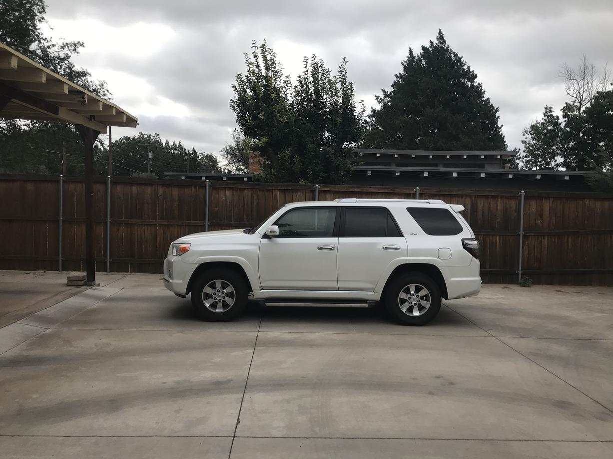

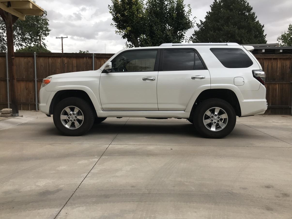

LF 2 1/8
RF 2 1/4
LR 2
RR 1 5/8

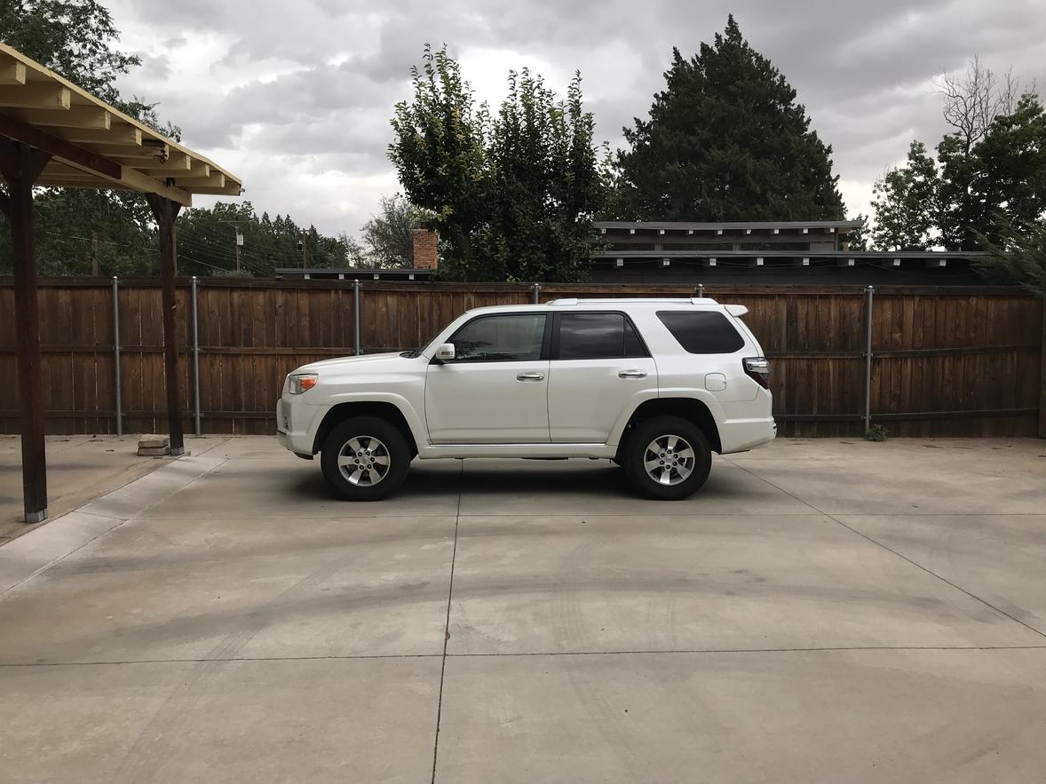

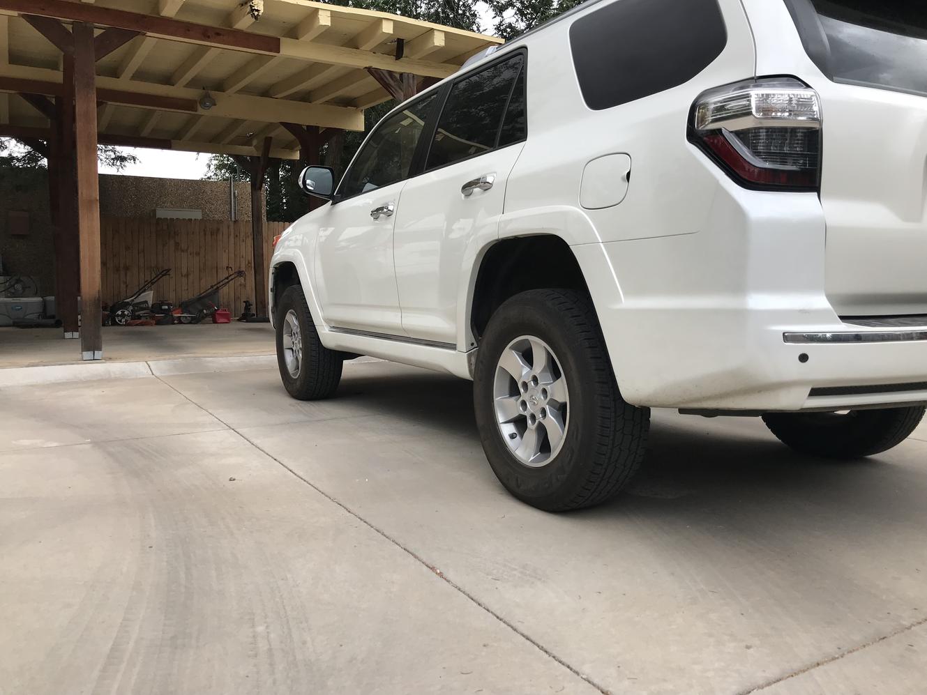

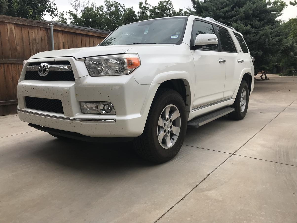

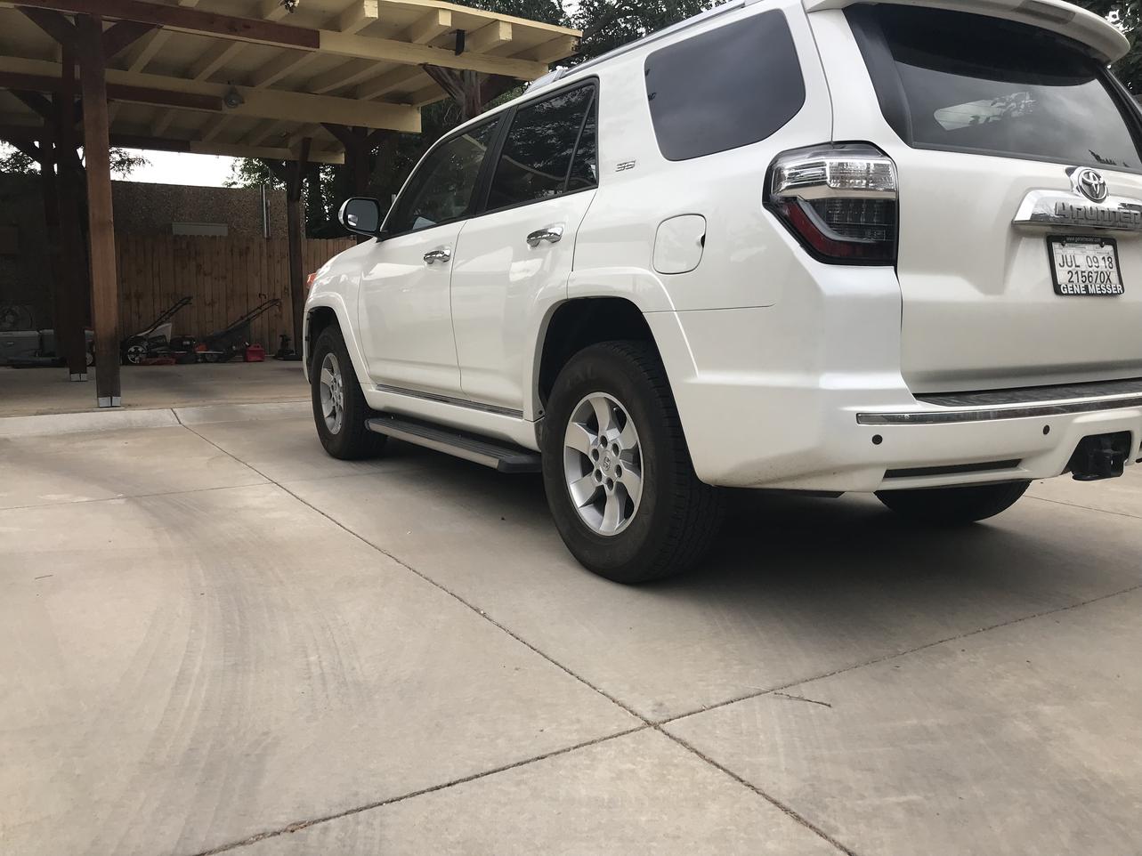

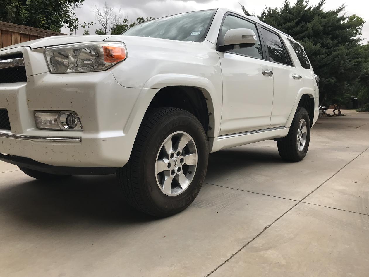

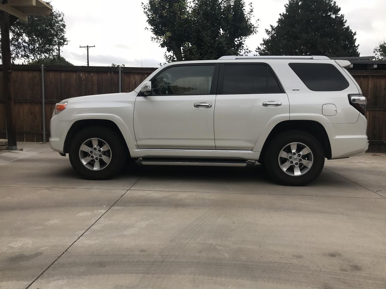

Here is my 2011 SR5. Kit with perches where they came. Front I added the cornfed 3/4” (3/8) top plate spacer and rear T-13 springs with 10 mm OME packer on drivers side. I’m within 1/4” left to right and have about 1 3/8” rake still.
Was overcast all weekend so pictures aren’t the best, I’ll post better when my Ray10’s get put on.
Love the ride so far, not what I’d describe as harsh at all, just way more composed in all aspects. Install time with me and a friend was an hour per side front and about 45 minutes per side rear. Only hiccup was I ordered new top hats and extended studs from wheeler, but 2 of the studs ended up spinning in the top hat so ended up reusing the old hats.
