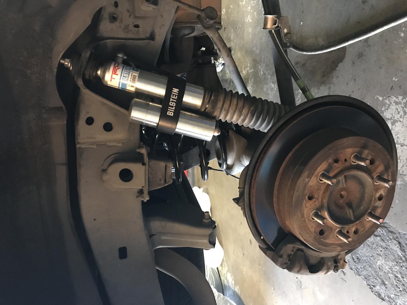

I just installed a full trd pro kit and I had to make two minor mods to them so they would fit. First was the lower front shock mount was too wide it needs to be shaved down a little bit. Second the rear upper shock mount hole in the frame needs to be enlarged slightly.
Here it is after the pro kit with rear fj springs
The rear upper shock mount hole is part of the frame correct? This means, that if you ever replace your rear shocks again, you'll need to go with an FJ rear shock because a standard '4th gen fitment' would now be too small for the shock mount hole?

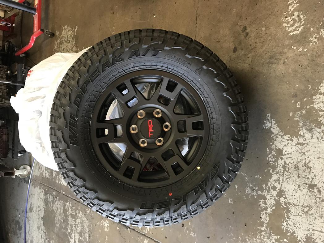

I’ll try and take some measurements when I get a sec. I just installed trd pro wheels and toytec trd pro leveling kit. Since I’ve had multiple people ask what setup I’m using I thought I’d share my setup for others with questions.
My setup is:
Used trd pro 4Runner shocks with trd pro stock front springs
O’Reilly auto parts fj cruiser rear springs roughly $70 for the pair
Bilstein 5160 resivoir clamps amazon $50
Toytec Part numbers for leaving the front:
BAJA1-B
TOP1-T
TAC-DR-05 Diff drop kit
If anyone has any questions feel free to pm
