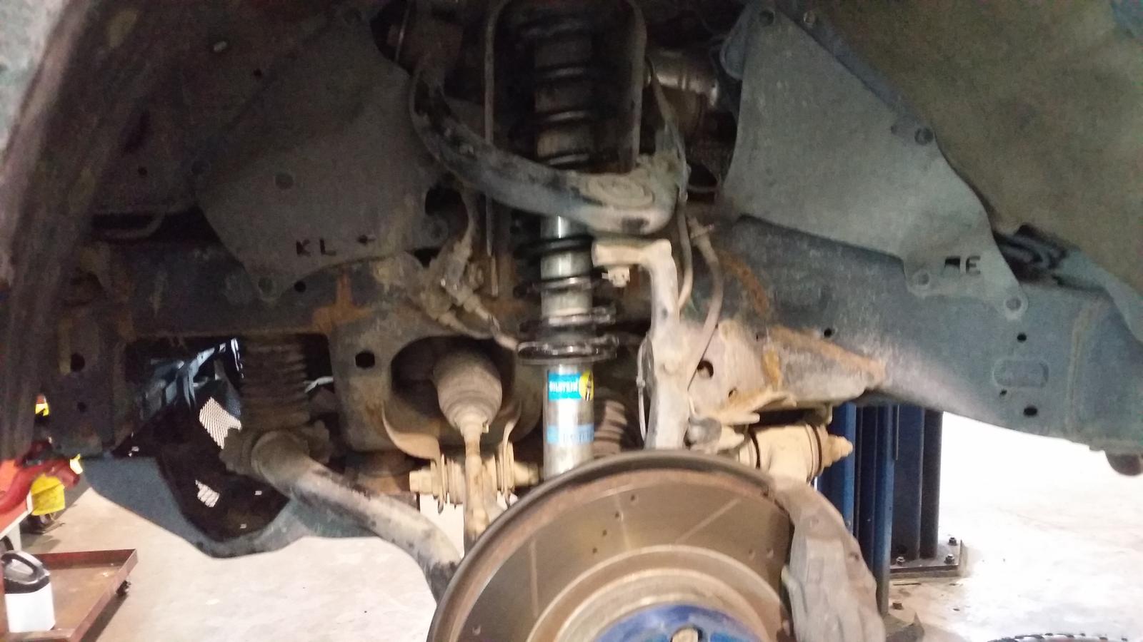

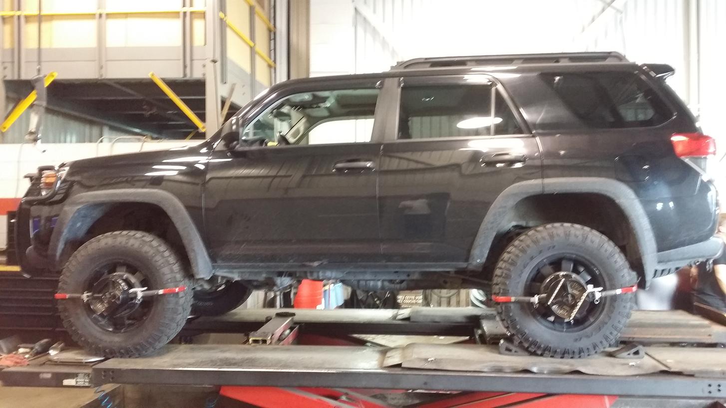

3wbdriver got it setup up like you said .85. Got a pic on the alignment table :)
The dudes at the toyota dealer were amazing an knew wth they were doing. Got 3 guys working on my truck and I left happy ! Thats what matters right ?
Here is some pics.
