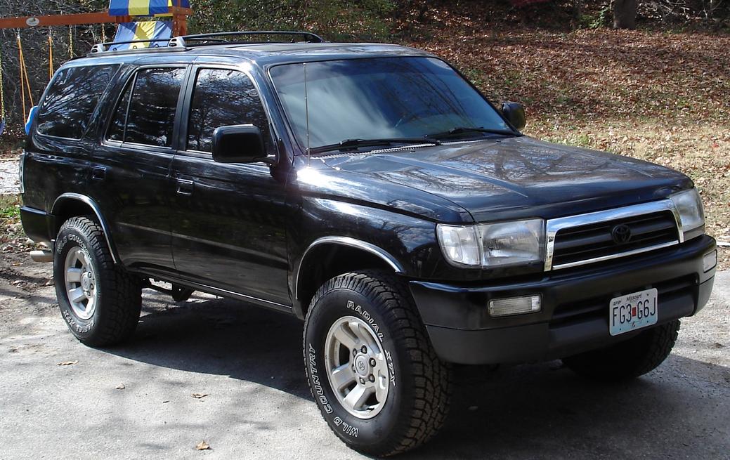

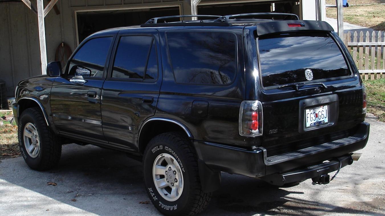

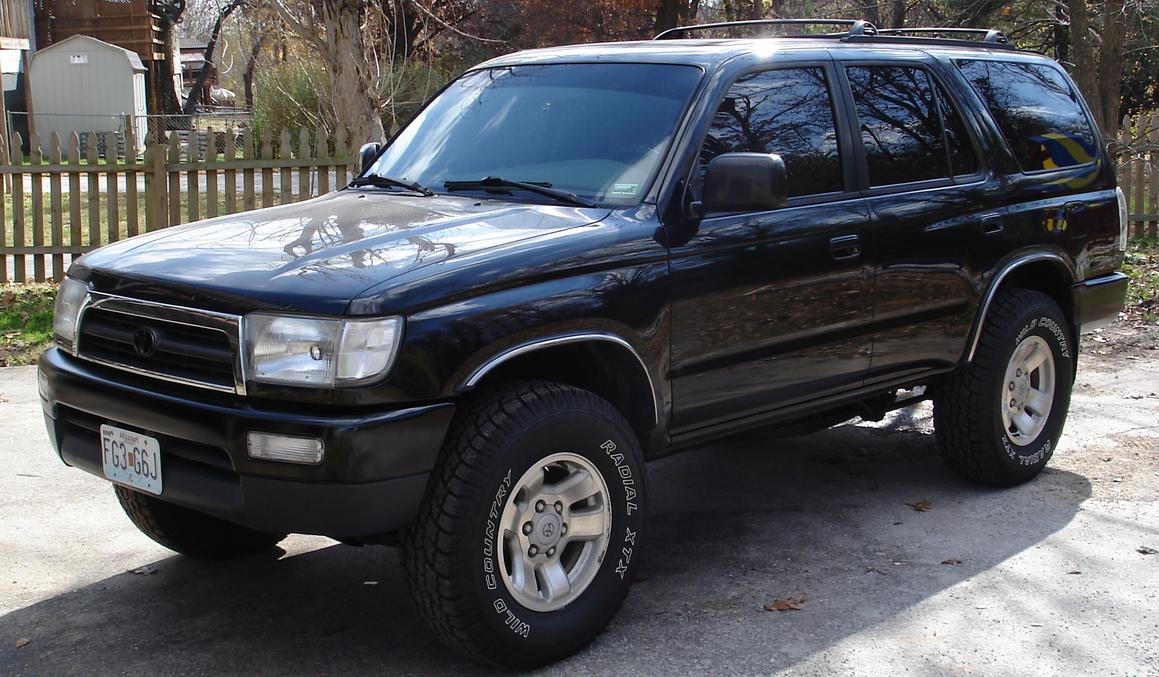

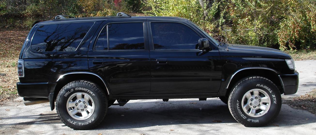

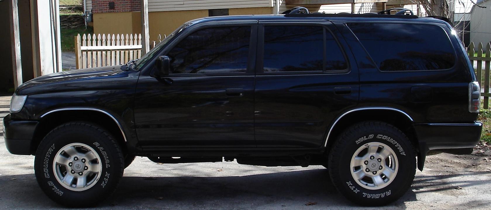

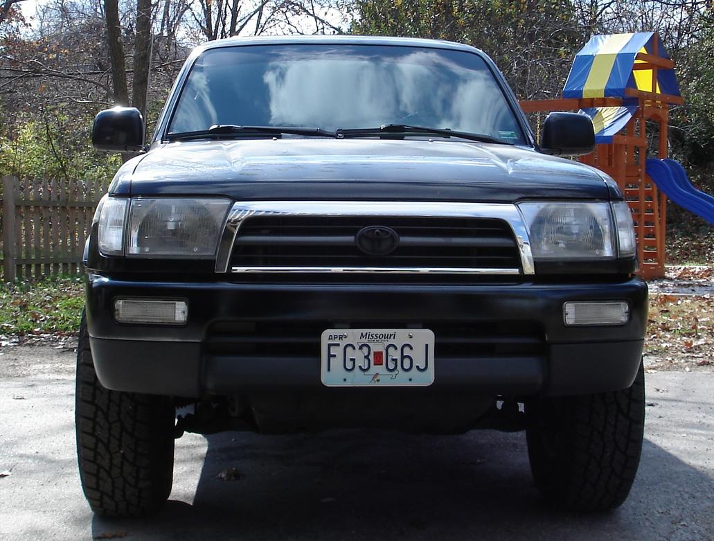

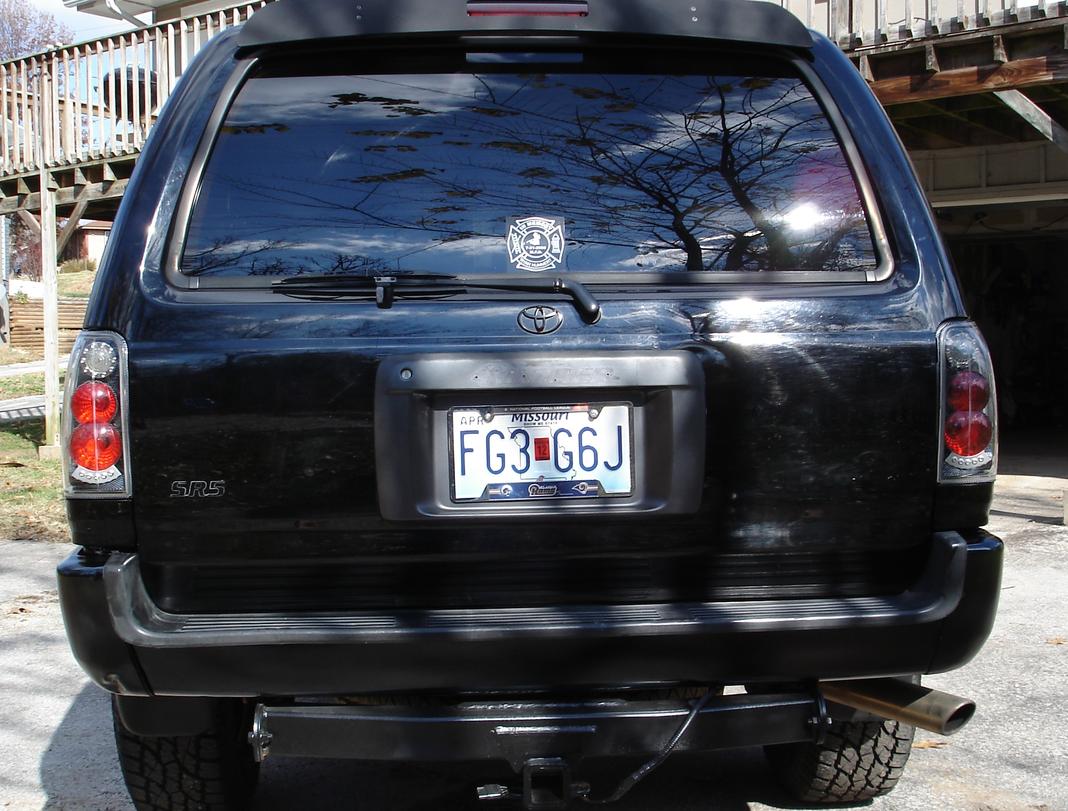

Here you go
:cheers:
:thumb3:Keep us updated on the durability! A lot of people here have asked about painting their chrome bumpers and this may be a great solution. :hatsoff:
Edit: I like what you did with the grille too. It flows very well with the rest of the front end :thumb3:
On my to-do list. Look good after you put more paint on it.
Its funny though, in the first pictures I was looking at it like "WTF?!" because it looked super thin.
I know. When I finished the first time I looked at in the sun and was pissed. I was like "this is f*ing blue, wtf !!!!" Needless to say I was pretty pissed. I don't think Duplicolor expected anyone to do bumpers with their product. Light coats on a big flat surface looks way different than light coats on a wheel or valve cover. In the direct sun now it looks more black chrome than just black paint.
so did you just paint over your clear coat to get it right?
are you a firefighter? (i cant see what the sticker says.)
Yeah, I painted over the clear because it was still fresh. The texture of it is not as smooth as I would like but I didn't lightly wet sand the surface before I painted. No I'm not a firefighter. I was a volunteer for awhile though. The sticker is a rememberance of a close friend who died in the line of duty. His name was Ryan Hummert of Maplewood, MO FD
