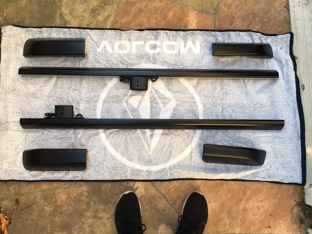

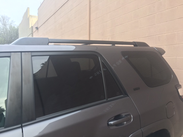

Hey guys, new member but not new to the forum. Thought I could chime in since I got a lot of help with my decision from this thread. I decided to wrap my roof rails and end caps in black vinyl. Painting is a cheaper and more durable way to do it, but I'm super picky and can't commit to permanently painting something without knowing what it will look like ahead of time hah.

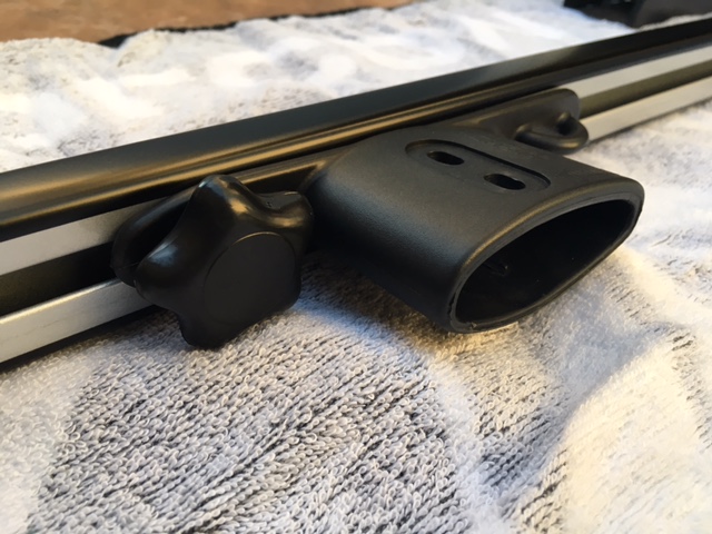

But I had the roof rails and end caps of my 2105 SR5 wrapped in 3M 1080 Series Satin Black. I had doubts about choosing satin over matte but really glad I went with satin. The 1080 3M Satin black is more matte than it is gloss; exactly what I wanted. I removed the silver roof rails from the black mounting brackets along with the end caps ahead of time so it would be easier for the installer to wrap. I also specifically asked to leave the channel open so the OEM crossbars can move freely for any roof/ski rack. I left a slider from the OEM cross bars on each roof rail when I handed them to the installer so he could measure where to start/stop the vinyl.
When reinstalling the rails, I wrapped thread seal tape around the white nipples in the truck body, that the mounting brackets bolt to. This was probably over cautious (especially because I live in So. California) but that is a weak spot for a potential leak into the cabin. A silicone bead around the bottom would have been ideal.

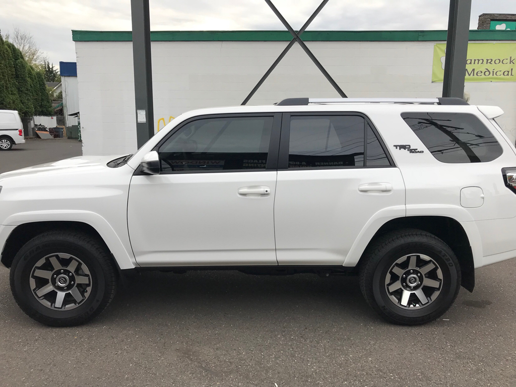

Has anyone seen, or done, the roof rails in white on a white 4R?
Incase anyone is wondering, it looks like this. I dig it. I’ll most likely get them powder coated at some point.

Vinyl wrapped mine semi gloss black, super easy. just remove the end caps to tuck the edges. Will post pics asap!

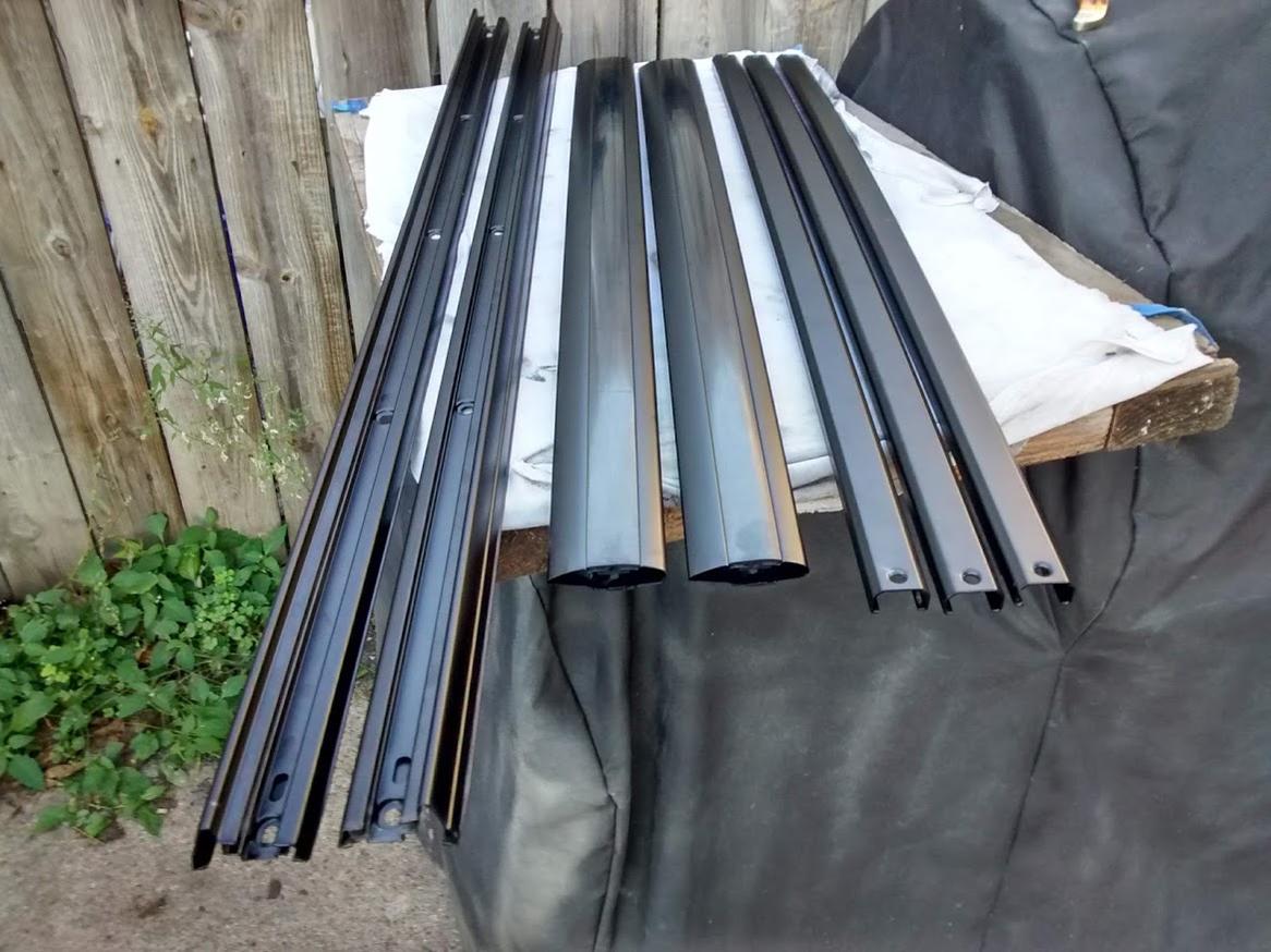

Got mine powder coated by the same shop that did my Rago panels, they look great, hoping to get them on the roof some time this week if it ever cools off outside
I powder coated mine. I am running a Prinsu full length now so it just sits in the garage for the eventual trade-in or sale lol.

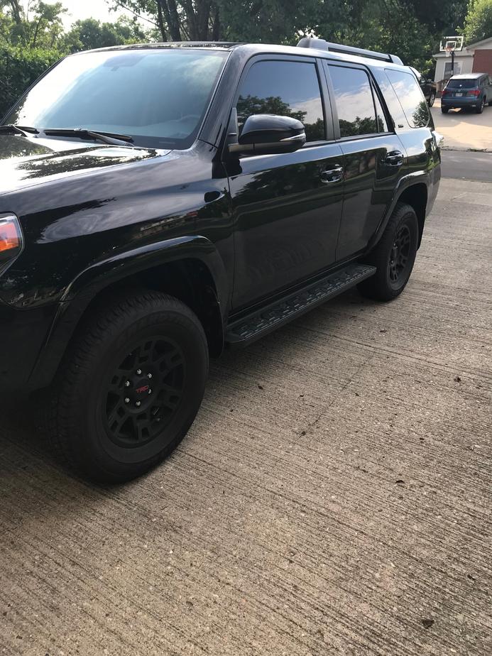

Spray painted my rails black using the tutorial on Trail4Runner. A bit of a spotty paint job on my part but a short-term solution through snowboarding season before switching to a full rack next spring. Before and after pictures.
Powder Coating
Dropping my rails off at powder coating tomorrow morning...should have them back by Thursday.
