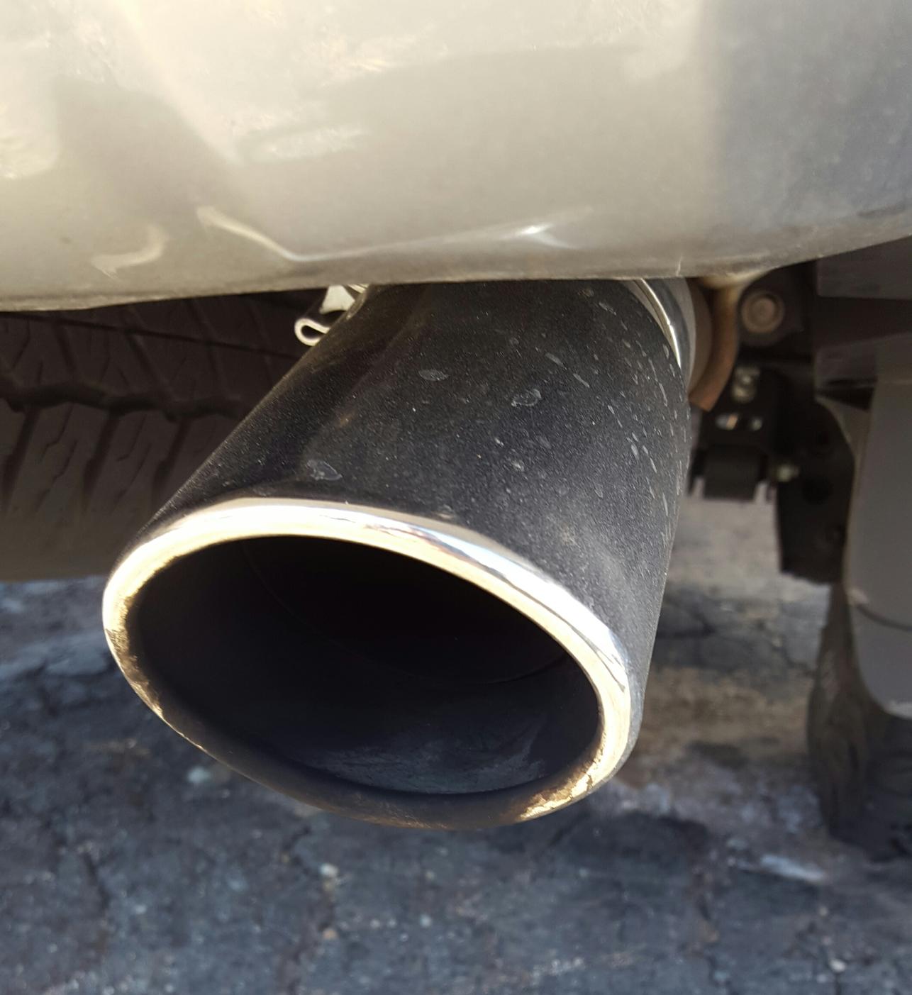

Black soot on exhaust tip. What does it mean?
alext72888
Winter driving over here. Is my fuel to air mixture too rich? Lead foot? Improperly installed exhaust tip? Does anyone else have this?
What you're seeing in the pic is completely normal. Wouldn't think twice about it
I have the same tip on my 2016. same soot . I now have 5K miles on my vehicle. no codes 18-20 MPG ..
I understand your concerns . on my old GM vehicles NO SOOT ..
I recommend finding an muffler shop that can route the exhaust to the side. What's on your tip gets sucked in inside the cab when you drive with the hatch down. You'll notice all kinds of dirt on your cargo area and headliner due to that. It cost me $35 to get mine done.
Its 100% normal.
Toyota does tend to run a little on the rich conservative side in open loop (which is when most of this happens). In normal driving conditions/closed loop (not WOT, and after warm up..) The AF ratio should always be just about perfect due to O2 sensor feedback.
