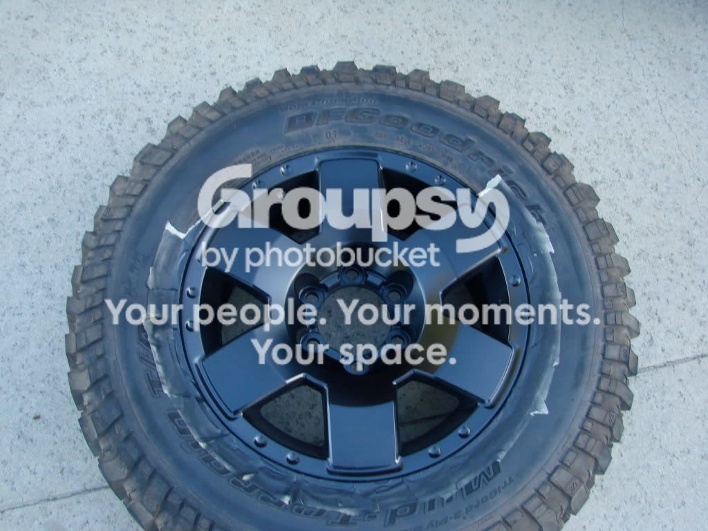

Well I decided that I wanted to go a different direction with my wheels so I started a little project. I found a set of FJ wheels locally, which I actually got for free, since they had some rock rash from off roading. Before doing the entire project I decided to mount and balance one wheel and tire, just to test fit b/c I was curious how much rubbing I would get with spidertrax and the increased offset. After test fitting I decided I also wanted to try the entire wheel painting process one time through, which this thread documents.

Step 7- Spray your final coats of paint. I used Dupli-Color Satin Black Wheel Paint (HWP-104) and let the primer dry for around an hour prior to painting. I put on 4 coats, the first 2 relatively light, the second 2 more thick. I was sort of disappointed with how this paint sprayed when compared to the primer. It was really hard to get a nice even coat on. Also, the nozzle on the wheel paint sucks in comparison to the one on the primer. It will take 4 cans to do this, for me it may be more since the wind picked up and not as much paint ended up on the wheel as I had wanted. Here is a pic after I started taking some of the masking tape off.

I would say currently the look of the wheel is a 7/10. They look good, but due to the troubles getting an even coat on I think they could look better. I might try another coat in better light with no wind, or using very very very fine bronze-wool.

The overspray on the tire is actually very very minor and since the tire is dirty and rubber it does not stick whatsoever. When I was done I took a towel and wiped all of it right off. It looks worse than it is since when I was painting the wind picked up and cause more overspray then normal.

....and actually when I look at the pics of the tires, those were taken just after I took the overspray off with a damp towel. So that is just a clean/wet tire sidewall just standing out from the dirt in the tread/lugs. Not paint :D
