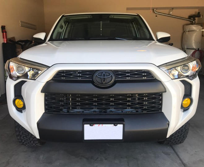

So I've got a silver 2015 LE. Can't decide if I want to do the black emblems overlays on the back or use a black plastidip background under the sombrero and 4runner lettering on the tailgate. Seems the background contrast might work better with silver paint. Wish I didn't suck at Photoshop/etc and could mock up what it would look like.
Already have a guy lined up to do my front chrome pieces in a new plasti dip that's apparently oil resistant (?) while leaving the front sombrero chrome.

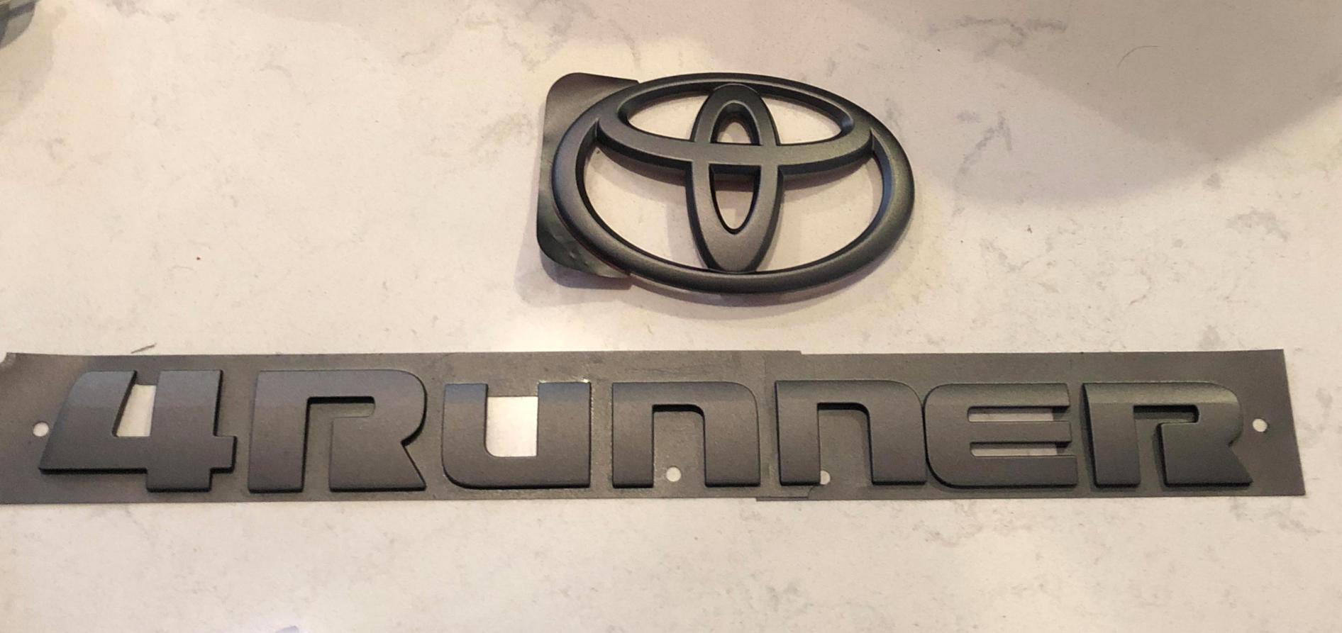

I just bought all the rear stuff online and sprayed it. For the front emblem I had to buy a top part of a grille on ebay. I am sure the other parts are available on the site too, I did see some in black as an option.
Got the others @ toyotaparts.mcgeorgetoyota.com 75432-06030-Emblem
75431-35060-Nameplate
Here is a pic of them sprayed

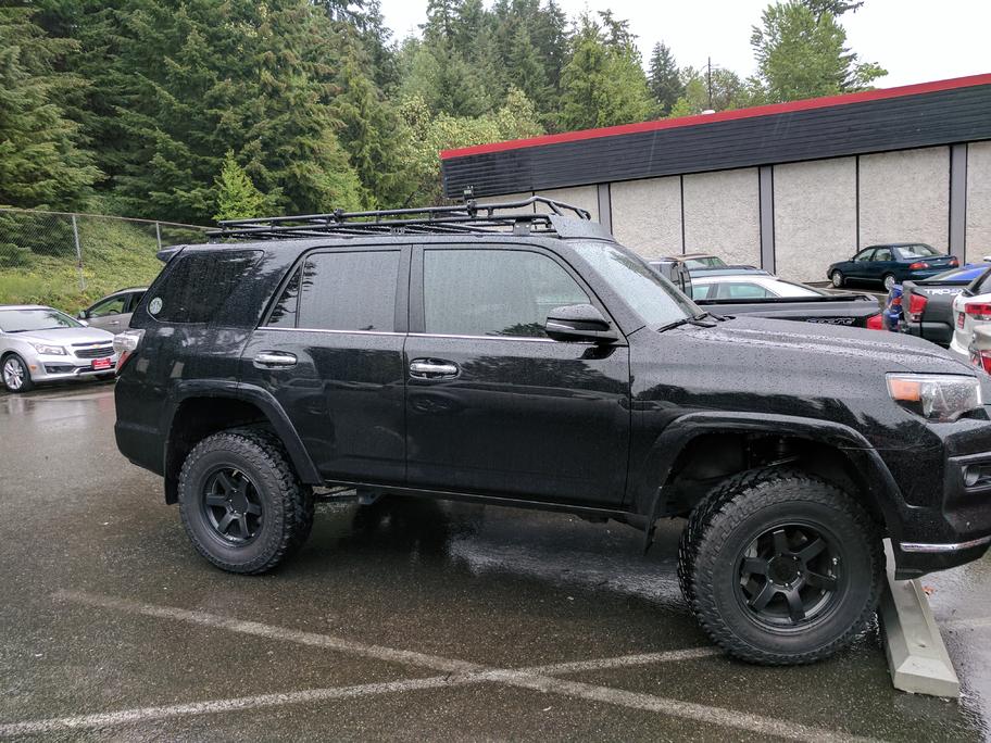

I need to start the dechroming process soon on my TRDOR. It came with those ugly chrome side steps (damage multipliers), and I'll be removing them today or tomorrow. Mine isn't lifted, so they aren't even necessary.
