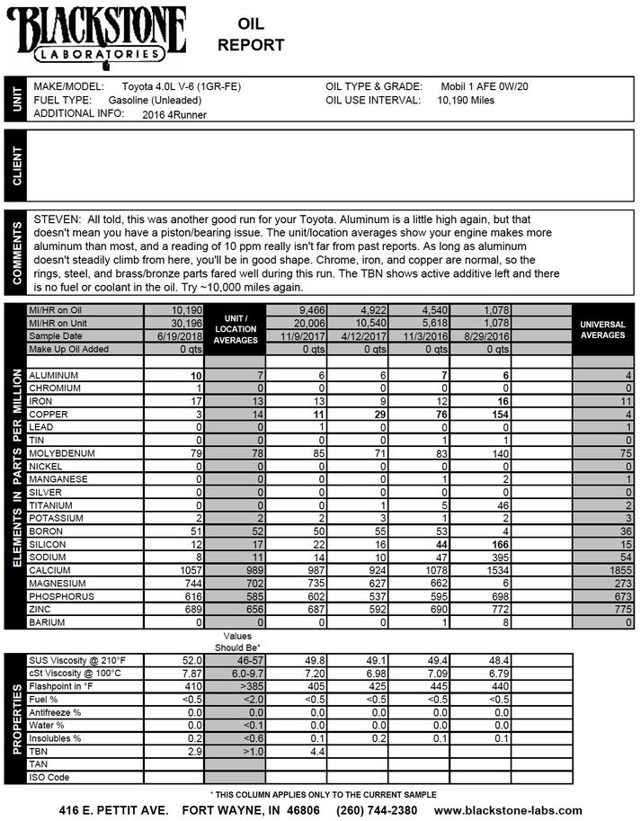

My latest Blackstone Labs UOA -- a bit over 10k miles on this one (and I forgot to re-order Amsoil oil filters so I used a Fram XtraGuard this time).
Seems safe to say 10K on Mo1 is a good Interval. I have never gone over 7500 but the add pack appears to be good for around 15K.:thanks:
What kind of driving do you normally do? Are these mostly highway miles? Looks like you put on 10,000 miles in about 5 to 7 months?
Yeah, living in rural (small city) Montana nothing is close to me. A trip to the closest McDonalds is a 160-mile round trip. ;) So there are no short-distance trips where the engine/fluids don't get warmed up properly. I would venture a guess and say the M1 0W20 EP would be better for short-trips, etc. Then again, now you're into "severe service" and 5k mile OCI territory.
Basically, M1 AFE can handle the 10k mile OCI called for in "normal service" -- that's all that I was really documenting (for myself and others here). I'm going to be doing 10k OCI's until I hit 60k miles, then I won't be doing UOA anymore.

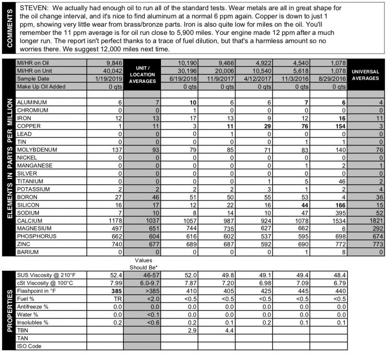

Latest Blackstone report for members' perusing. I was still running Mobil 1 AFE 0W20 on this report. I did switch to Amsoil Signature Series 0W20, so the next report I'm going to have Blackstone run TBN for me.

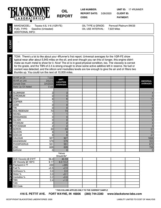

This is my first report with Blackstone. I am on my 2nd DIY oil change with Pennzoil Platinum after the two courtesy oil changes from the dealership ended. I have been doing 7500 mile intervals with oem filters and also have a Jowett Performance oil filter housing installed. I apologize for how small the image turned out.

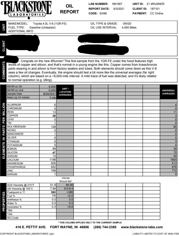

2021 TRD Pro that has seen quite a few trips into the California mountains.
This oil was sampled at 5k miles, and I had changed the oil at 1K; so there are only 4k miles on this oil.
TL;DR: data report shows normal wear for a new engine; count for wear and silicone should drop after a few more changes.
:beer:
