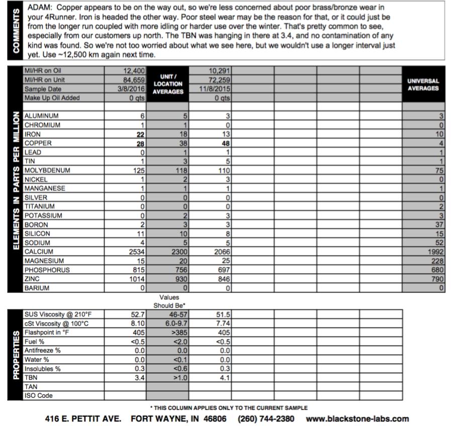

Bumping this back up with a report from a few months ago that I forgot to upload at the time.

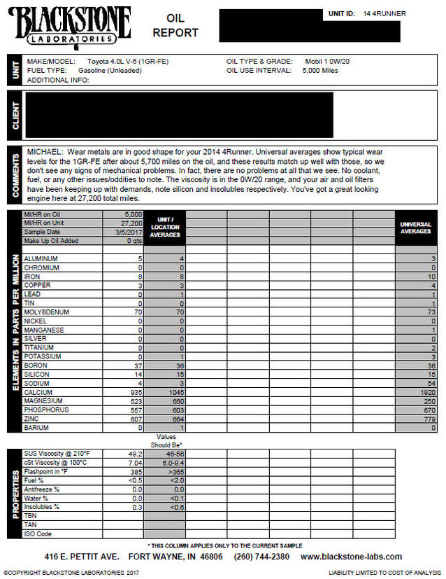

Just got my oil analysis back. first time doing this and wanted to keep records for myself. not sure how to show the attachment wo downloading it. sorry

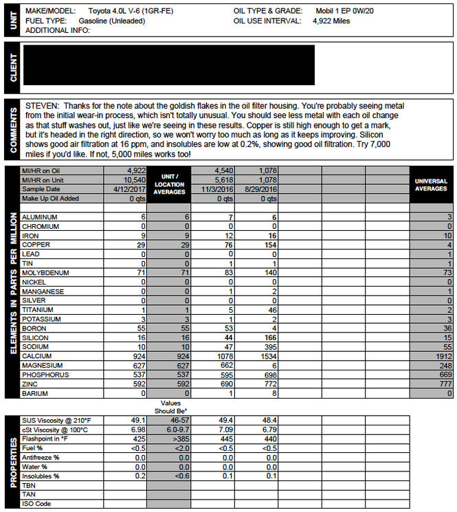

Here is my third Blackstone report (as a reference to anyone interested).

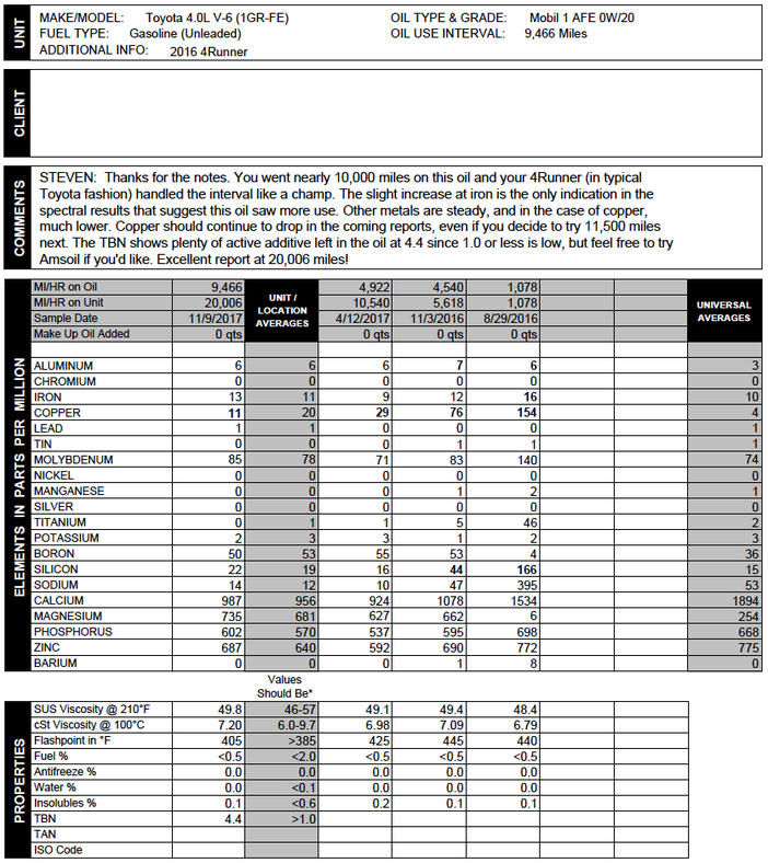

Here is my fourth Blackstone Labs report, after running Mobil 1 AFE 0W-20 for just a tad under 9,500 miles. (I forgot to order more Amsoil filters and had to use an STP during this change - hopefully it'll hold up for another 10,000 miles).
This is the first TBN measurement I've requested; if you run 5k miles for your OCI I don't see any need to request it (it's costs extra). I did not have Blackstone Labs check new Mobil 1 AFE 0W-20's TBN, so I don't know where it is at when new, but at 4.4 the Mobil 1 could definitely go a bit more than 10k miles.

Nice! Always good to read. Mobil lists the TBN as 8.8 for new AFE 0w20, so it appears to hold up well.
