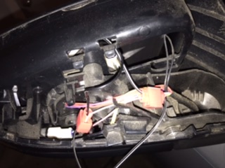

Can someone please tell me where I went wrong? I have a 2016 T4R Limited. I clamped a pink wire with one of the wires provided and the white wire with the other half of the wire provided and left the clamps inside the housing. I have the excess wire just hanging out in the door panel. Is that supposed to connect to anything? My turn signal light on the mirror is not showing up. Please help
did you connect the other side of the wires to the new mirror glass ? Pictures ?
I found out what was wrong thanks to help of Eddy from Suma who was quick to respond to emails. It was a rookie mistake but nonetheless a lesson learned. You need to make sure the splicers are properly clamped and should feel a click/locking type sensation. In addition after taking my door apart I realized it’s not necessary at all and this can all be completed in 5min or less. To pay it forward I’m attaching pics and descriptions so you don’t disassemble everything like I did..
1. Remove mirror (By pulling along the edges) and unplug the double defrost wires. You can rid the original mirror.
2. Remove plastic housing (outside cover) by pushing on the clip/tab from the inside of the mirror
3. connect the 2 split wires from the new Suma mirror with the 2 split wires Suma gives you and feed them through the housing toward where the wires lead to the turn signal.
4 us the splicer to connect the 2 wires that are fed through to the pink and white wires from the original turn light.
5 cut the remaining excess provided and double check it works before reassembling everything.
Hope that helps

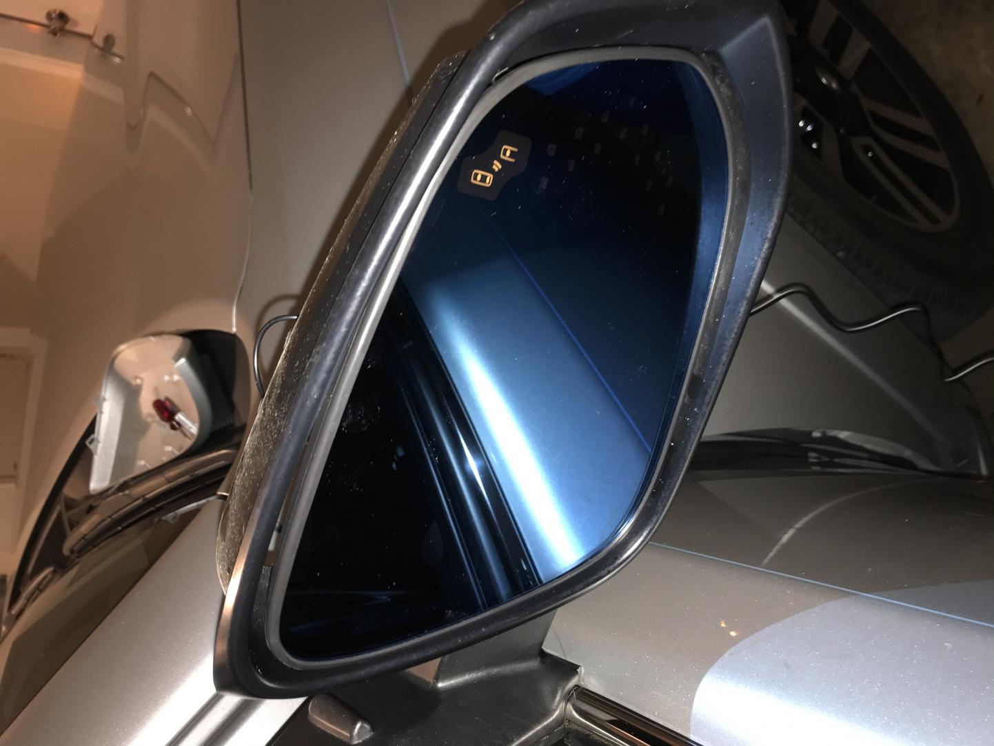

is that a Blind Spot Monitor system in the Suma mirrors? what enables this feature?
Hope that helps

so quick update.
Everything works well, with a much wider FOV

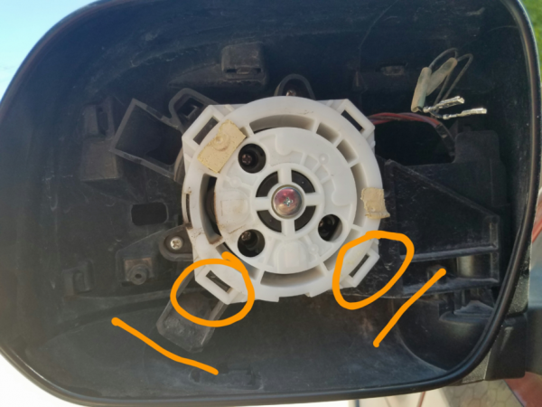

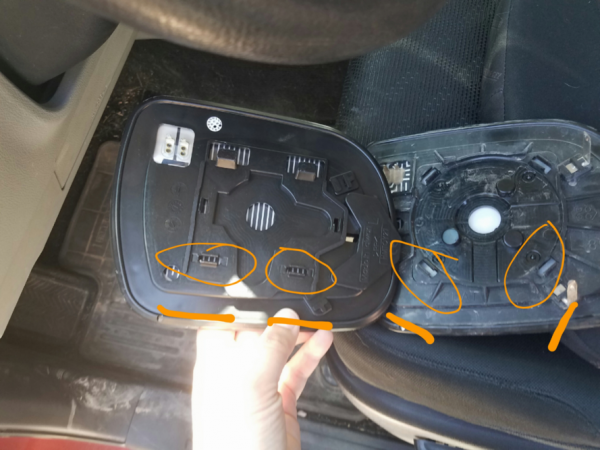

Got my mirrors w/defrost option today (yay) but the clips don't line up with the OEM mirror mount. OEM clips are at an angle, new SUMA ones are parallel to the ground. Am I missing something here?
Looks like you may have received the wrong mirrors. Here’s mine.
