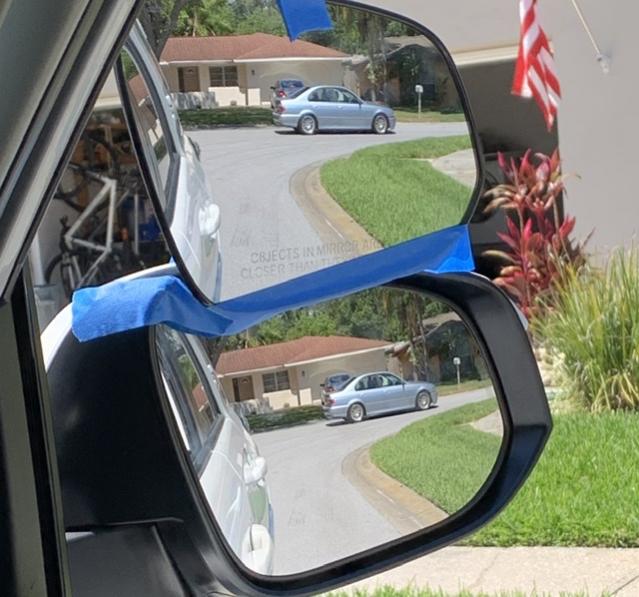

Not at all. Here is comparison. OEM on top.
Also, I spent last hour trying to get the flasher on driver side to work with no luck. Will have to buy a meter to test that now. 5 months to get these (actually not even the blue ones) and only get driver wide angle and the passenger side flasher.

Stock passenger side mirrors are already wide angled mirrors, so you won’t notice a difference with them. I put mine in last night, and you’ll definitely notice a difference with the driver’s side.
To get the flashers to work, I connected the pink wire to the mirror wire with the white stripe, and white wire to the black mirror wire. I had to clamp them pretty hard to connect.
Good luck getting them to work.
Your right. I just checked my passenger glass and compared to Oem glass. The passenger glass was wide angle already. That’s why the Oem passenger glass says “objects are closer then they appear” and the drivers side didn’t.
