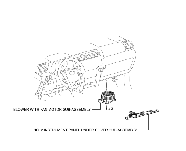

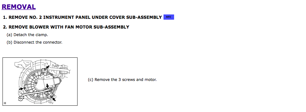

I haven't removed the blower motor, but have removed basically all of the dash to install a remote start. I would be comfortable tackling the job in a parking lot. I don't think you would need any tools other than a small plastic prying tool, 10mm socket, and maybe a phillips screw driver. You'll want to disconnect the battery before removing the knee airbag.
Looks pretty easy.

Thanks for posting that! That does make it look a little easier when only focusing on getting at just the blower motor.
