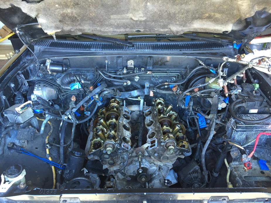

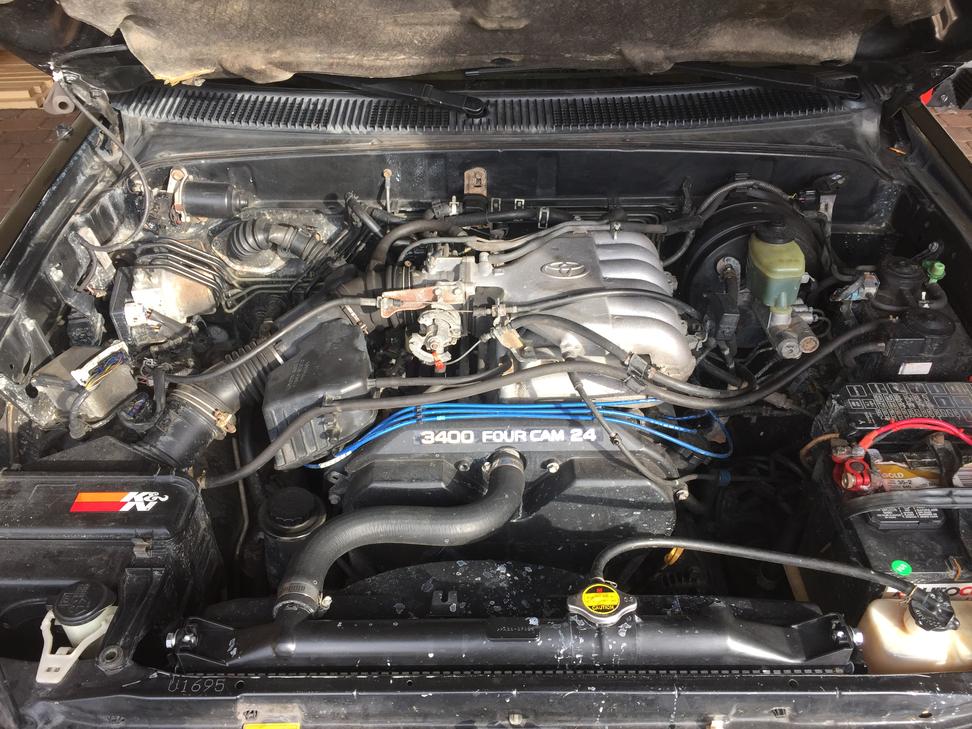

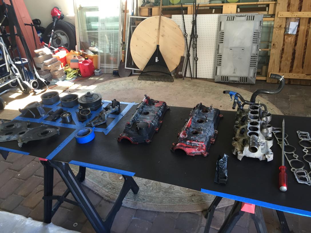

So I've gotten down to having the cylinder head covers off. I'm a little perplexed. It appears as thought the previous owner painted them red at one point, and then painted over them with black. I have a feeling they did some serious tinkering and a lot of damage to give me a blown head gasket at 127k. I will know more once I get the heads off and take them in and have a better look. I'm struggling with the exhaust crossover pipe and intake manifolds. Just old gnarly bolts and very tough to get to. Anyone have suggestions? Can't get the impact gun on most of them. Also, nervous about getting the camshafts out. Process looks tedious and I feel like I will screw something up. I looked ahead and I don't think I need any special tools so that is a plus.
I have invested a grand total of $0.00 into this so far. Well maybe $2.50 in bandaids. I'm not ordering anything until I get the heads checked out. Oh yeah, pictures....
You can see a before the craziness, and where I'm at now, followed by my organization system and my weird read head covers. I have an entire other table full of parts lol. Gotta keep it organized.

You could just unbolt the exhaust manifold from the head instead of the connections further down. Or visa versa.
Why do you need to remove the camshafts?
Someone has gone into that engine at least twice, once to paint them red and then to paint them over black. Would not surprise me , despite the carfax, if that was not the original engine. Did you get a compression reading before you pulled it all apart? I had my doughts about fixing the head gaskets before and now there is no way that I personally with continue with that engine. Find a engine that has come out of a wreck and throw it in. At least it will have factory specs. The crossover bolts are a threaded stud with a nut. worse case you can cut the nut off and work the stud out later or drill out the stud and put a stainless nut and bolt.
Have you personally pulled the heads and know it can be done otherwise?
Just wondering cuz fsm says to pull the camshafts out as OP said
The FSM says a lot of things. There is more than one way to skin a cat.
Let me give you an example: For the 3.5L V6 Camry / Highlander / Avalon / Rav 4 / Sienna engine, the FSM says to remove the engine entirely to replace the water pump. Is that the case? No. Many Toyota techs have told me that you can do it without removing the engine. Toyota later released a TSB to show that you don't have to remove the engine to replace the water pump.
After thinking about removing the cams, it may be necessary to do so in order to get the head bolts out. No, I have never done it on the 5VZ. On other engines, yes I have removed the head without removing the cams.
