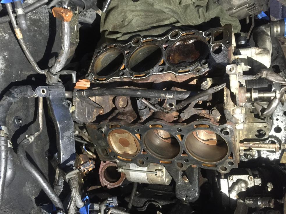

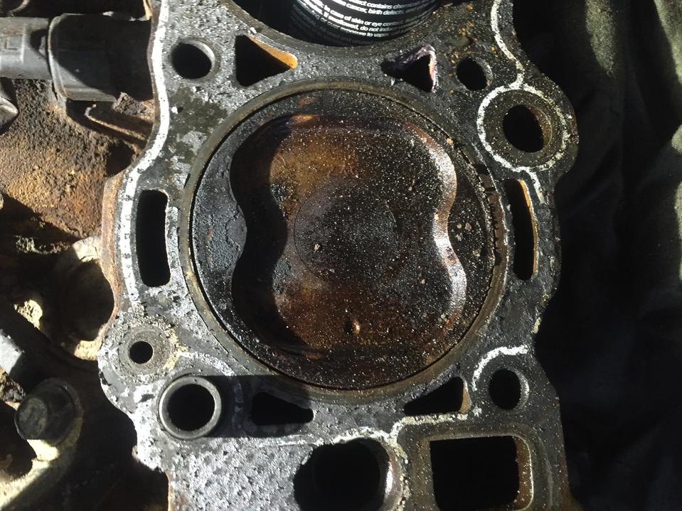

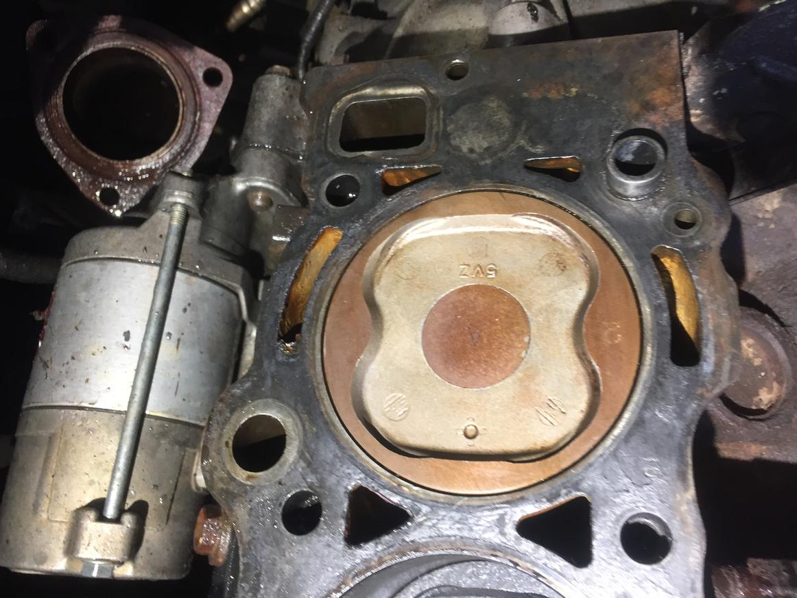

I've been busy scrubbing my life away cleaning up everything in order to put it all back together. Thought I would share the crap show that was the cylinder block today. I scrubbed the passenger side pistons as well as the gasket surface in order to make good contact. Hoping to get the heads on tomorrow. It seems there is a lot of residual coolant in some of the passages. I want to make sure to blow out all of the gasket crap that falls in but I'm simultaneously blasting coolant all over the place when I hit it with the air compressor. Any tips on cleaning up the coolant passages without making a total mess? Oh yeah here are pics to keep everyone entertained. :llama:
Last pic you can really see the difference in the clean bottom side of the pic versus the gnarly top. Yay brake cleaner! Sorry for crap pictures, my DSLR doesn't take kindly to greasy hands.

"Any tips on cleaning up the coolant passages without making a total mess?"
Use a shop vac. Might need to cobble together a thin hose to get the smaller passages.
There are block drains right above the oil pan flange on each side of the block...that's a quick way to drain the block, or if you're changing the water pump...pull that now and the coolant level should drop a couple inches.
If you don't feel like going through the hassle of pulling the A/C compressor to get the tensioner out to compress it, order one of these... Schley Products 97300 Toyota 3.4l Timing Belt Tensioner Tool by Schley Products | Toolfetch
If you were closer I'd let you borrow mine. I always use this against the old water pump as soon as the belt comes off to avoid hurting the bearing on the new water pump.
Those deck surfaces (the clean side) aren't clean enough. Get a single edge razor blade and scrape the deck surface holding the blade vertical...it'll pull all that old gasket material up.
Also, when you pulled the cams, did you put a 6mm bolt through the split cam gears? If not, you'll have to reset those before you re-install the cams.
