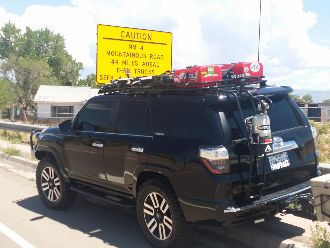

2.5" f & 1.5" r lift here on 33's with as much possible caster while keeping chamber/toe as close to zero. Drive straight, no vibrations, and doesn't turn to either side under hard braking.
I had to trim off a portion of the front bumper's lower corners, trim off a good amount of the fender lining and pushed the remaining fender lining forward as much as possible held with zip-ties.
