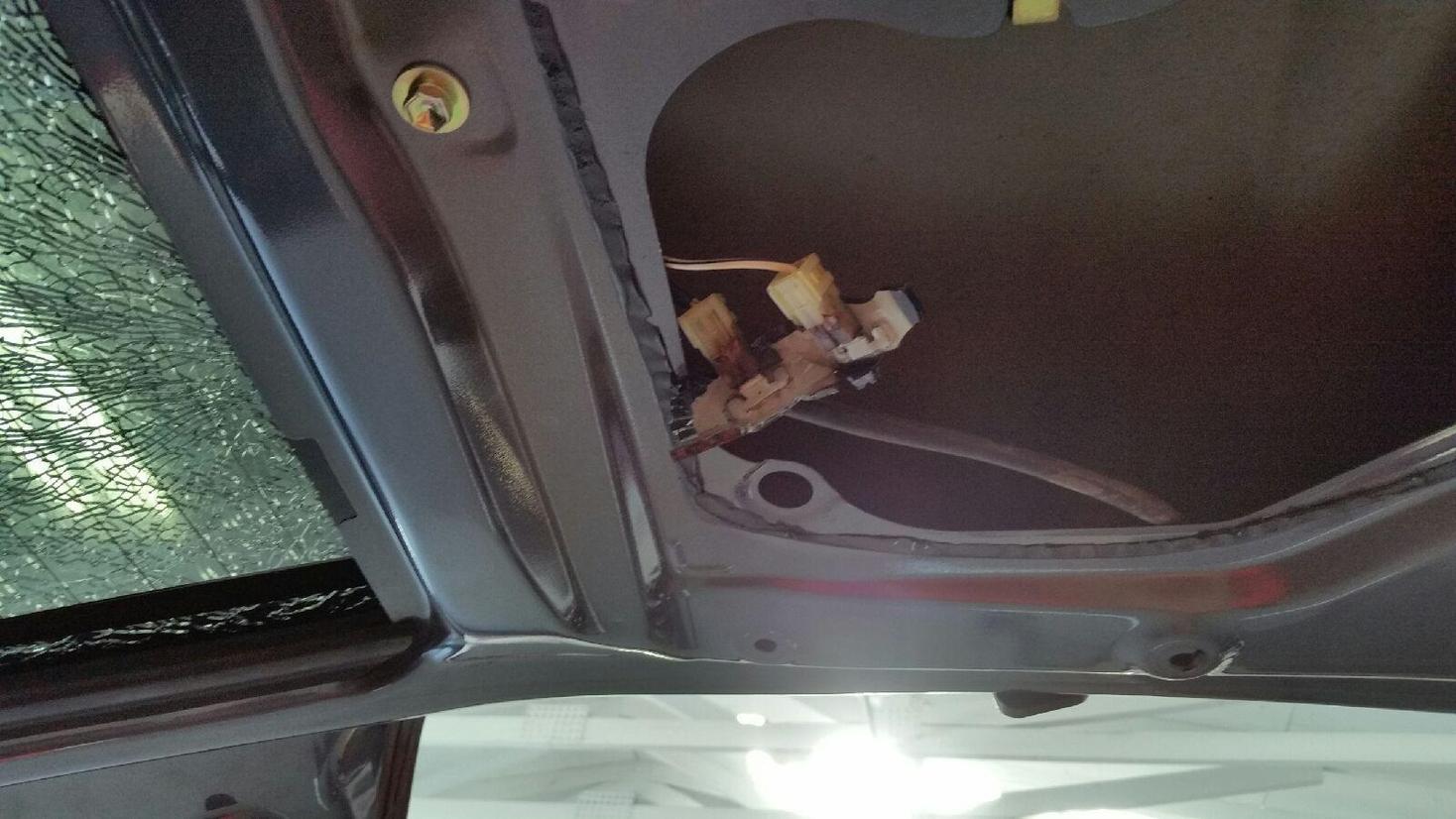

Got my rear window replaced yesterday by Safelite. Technician snapped a photo of the leads for me and they seem to be burnt to me as well. He suggested leaving them unattached for now, to prevent another breakage. Would it be possible to splice in new connectors, since the current ones seem to be bad?
I was thinking about the heat buildup issue and was brainstorming things at work that may help.
1. adding dielectric grease to the connectors for an even connection. if the connection point is small\uneven, heat can build up quickly. the grease would make a larger connection point allowing faster current/lower heat. Or solder!
2. would there be room to add a little stick on computer heatsink to the surrounding area?
These two thinks may seem very minor, but it could only be a matter of a couple degrees to stay in the glass safe zone.
Once I got our new rear window, I had the installer leave the rear defroster connectors unattached from the rear window. Didn't want to blow out a second window.
