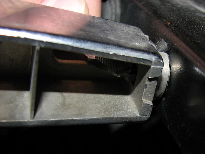

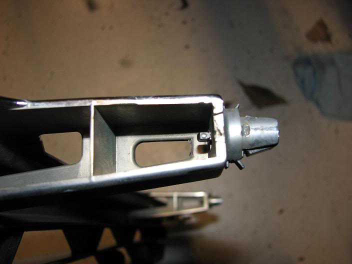

Releasing the clips. You can push the clip down from above but it is much more effective to come in from the side. There is a little black tab that sticks out and all you have to do is push it down with a screwdriver while pulling the grille away from the vehicle.
IMG_4941_25.jpg~original
I am right-handed and so I start with the upper left clip. Come in from the side with your flathead screwdriver and push down the tab while pulling the grille outwards with your left hand.
IMG_4937_edit.jpg~original
It may seem like you didn’t fully release this clip and that’s O.K. Move over to the next upper clip just to the right and do the same thing. If you really released both clips the grille should pull out just slightly. Mess with those two clips until it seems like they released.
Once those are free release the last two on along the top. Now it should be pretty easy to reach the lower three clips.

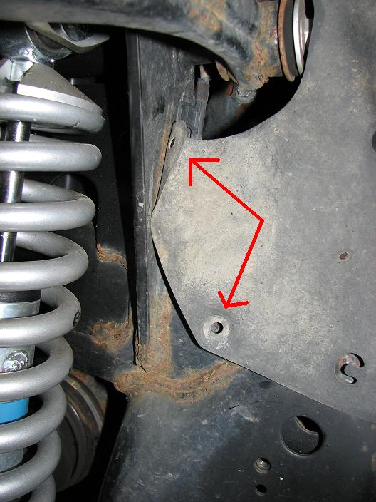

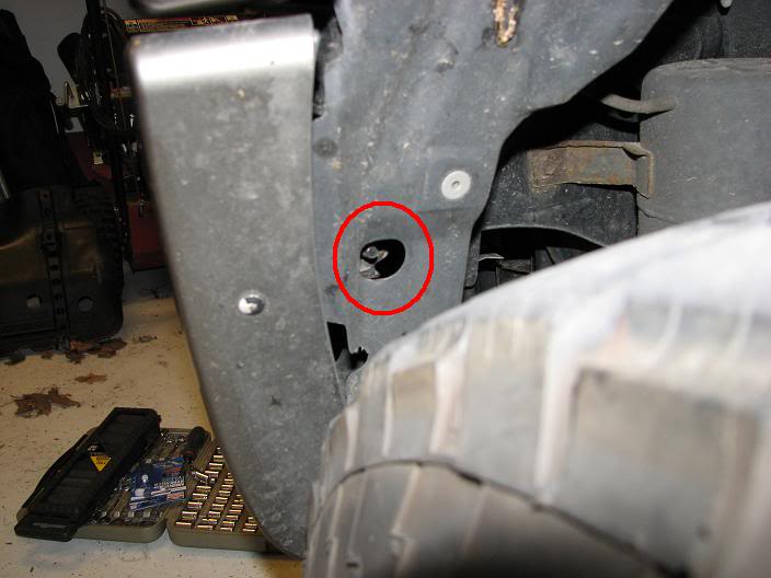

3) Remove two clips holding the front passenger wheel well splash guard in place. Now look through the wheel well to the engine and you can see the engine drain plug (5VZ-FE). Slide your 5/16" tubing over the drain and run it down to your bucket. With about 18" of extension bars and a 14mm socket you can reach the drain plug bolt located just above the drain. Loosen that up until you see coolant flowing through the tubing. If the socket is slipping off the bolt head push the extension bars up against the underside of the upper control arm. That's probably the straightest shot at the bolt head. This shows the tubing already in place and the bolt you need to loosen directly above
IMG_5533_25_20.jpg~original

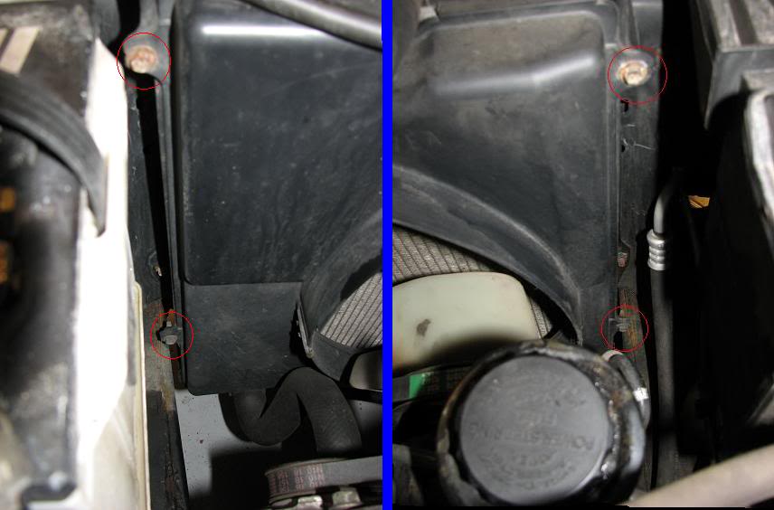

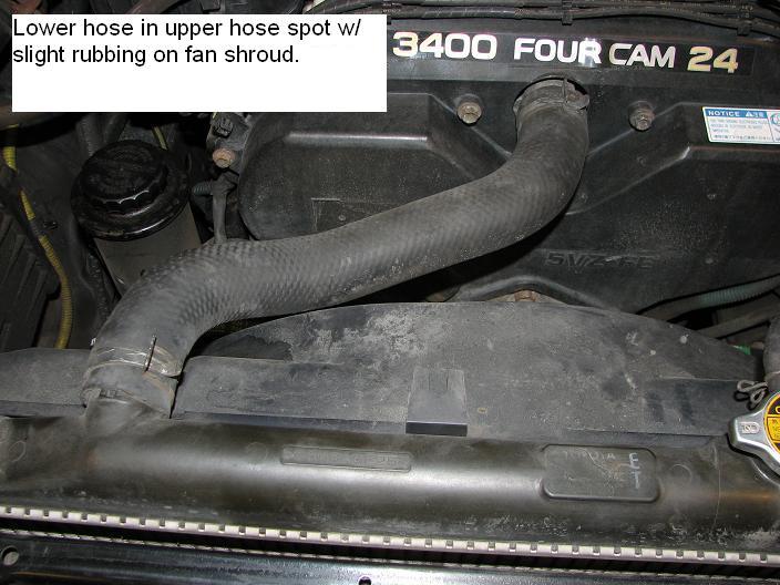

6) Remove the 4 bolts holding the fan shroud in place. Ratchet and 10 mm socket

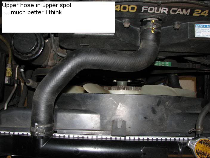

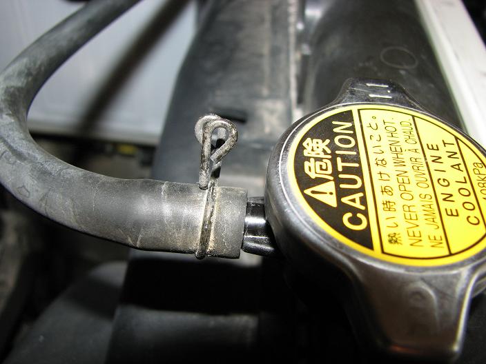

8) Completely disconnect the upper radiator hose (from the radiator and engine). Vice grips are great here or use a pliers. Squeeze the clips and slide them back. My mechanic put my hoses in the wrong spot and backwards when he did the timing belt. I think I have it right in step 14.
IMG_4944_upper-1.jpg~original

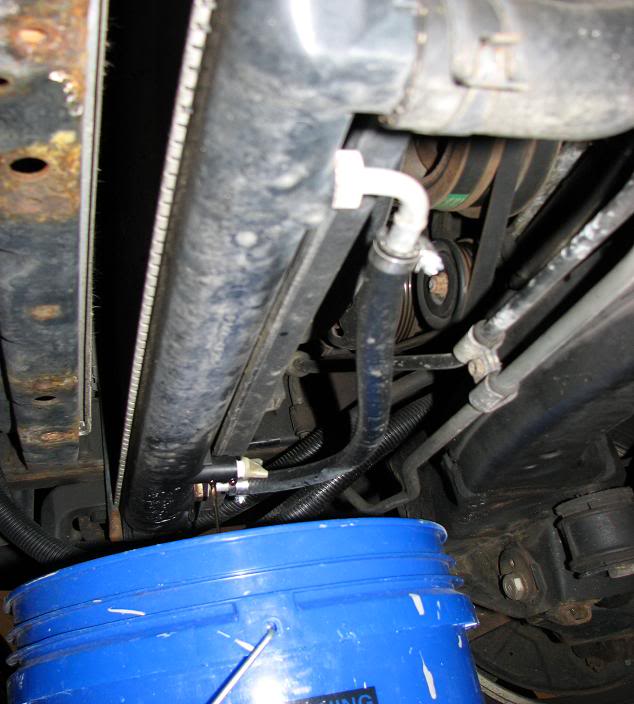

9) Completely disconnect the lower radiator hose (from the radiator and engine). Some coolant came out once disconnected from the radiator so have your bucket ready. Stuff a towel/cloth into the engine where the lower hose was connected. Coolant was slowly leaking out of there while I was working.

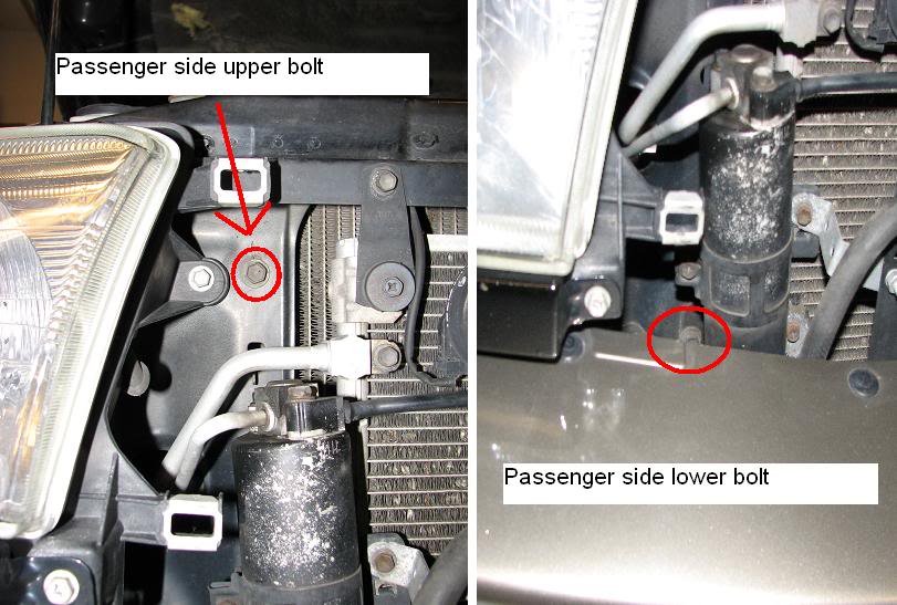

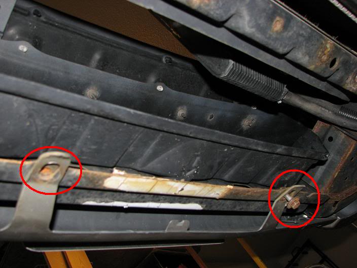

10) Remove the 4 bolts holding the radiator in place.
IMG_4961_edit.jpg~original

11) Remove the radiator and tip it over your bucket to get out any remaining coolant

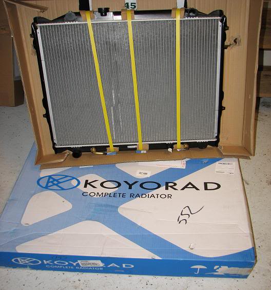

12) Install the new radiator. I bought mine on Amazon.com found here. Manufacturer listed was TYC but they shipped me a Koyo radiator. There is a tab near the top on each side of the radiator (just below the upper mounting bolts). These tabs will hook into the frame and hold the radiator in place while you put your four bolts back in. Tighten down the four bolts to 8.7ft/lbs

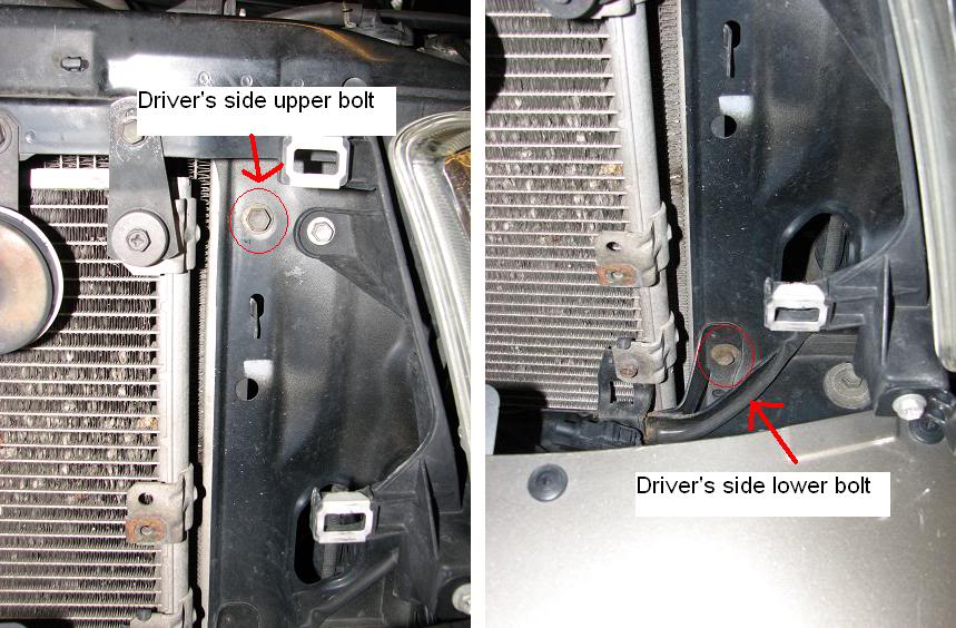

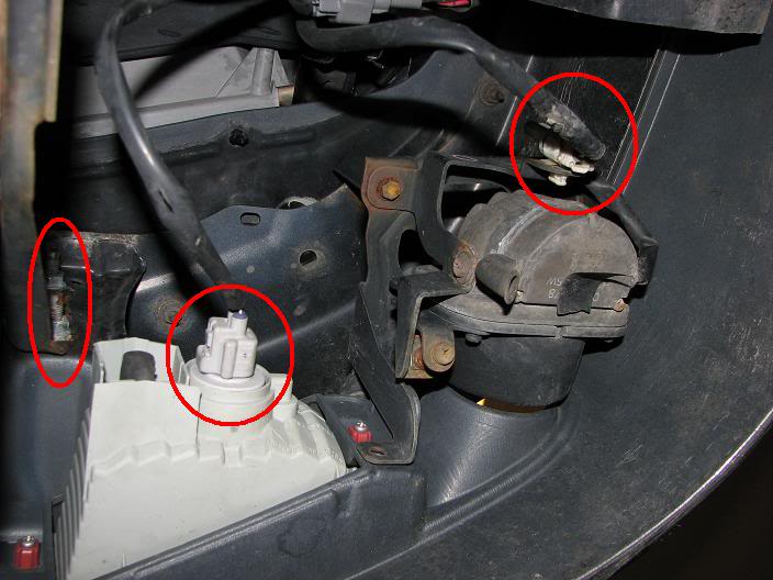

3) Disconnect your blinker and fog light connections and remove the 2 nuts on each side of the bumper above the blinker lights
IMG_4969_edit.jpg~original

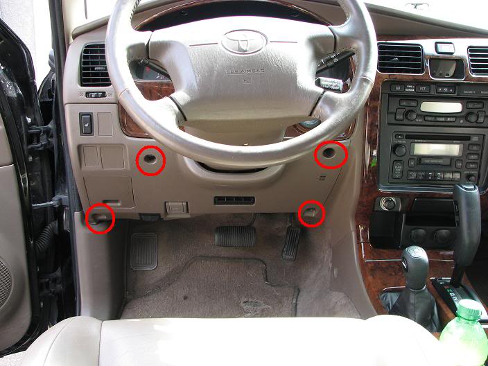

1) Remove the 4 bolts on the lower finish panel and let the panel hang
IMG_4886_25.jpg~original

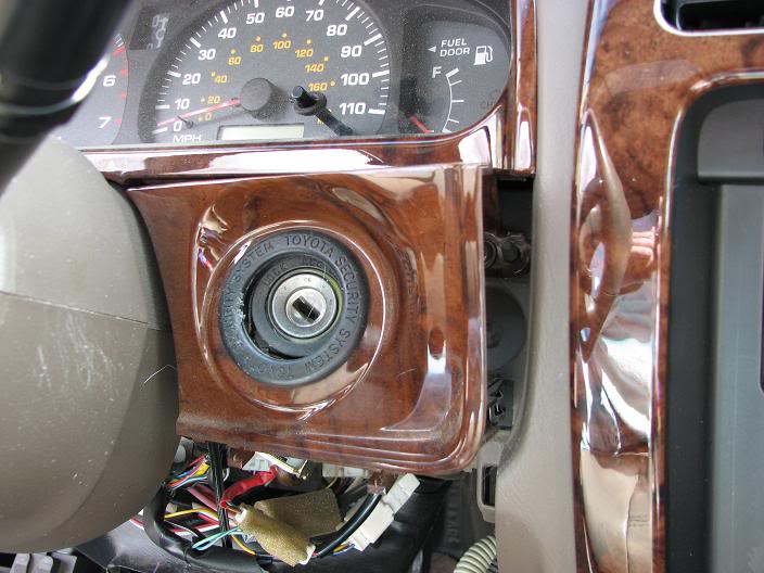

3) Pull the ignition key bezel out. There may be a screw there but I can’t remember
IMG_4890_25.jpg~original

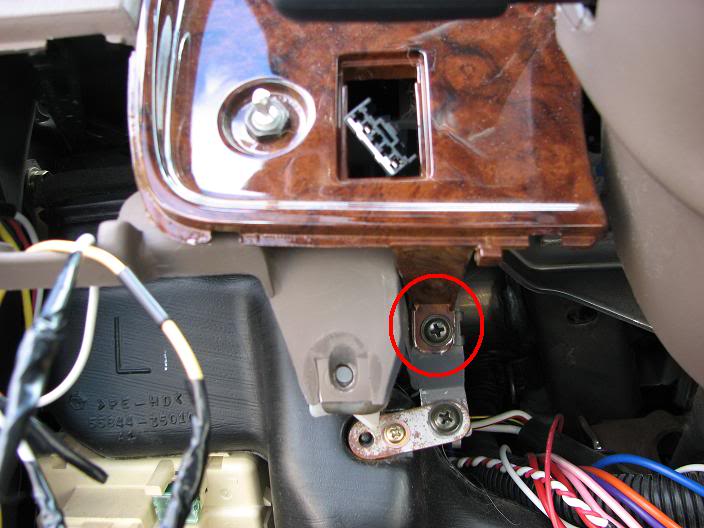

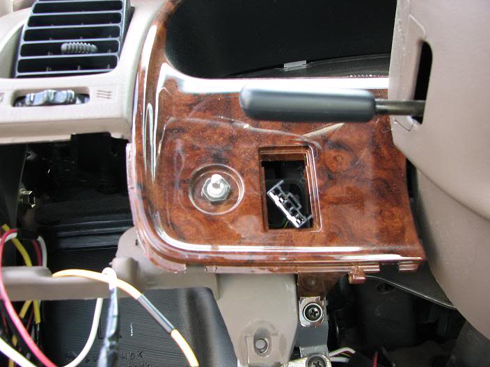

4) Remove the screw that was behind the ignition bezel, another one to the left of the steering wheel and the two above the gauge cluster.
IMG_4891_25.jpg~original

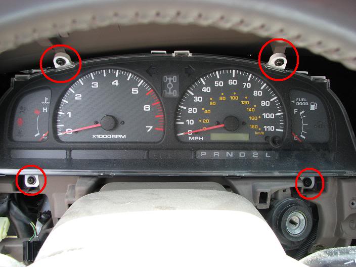

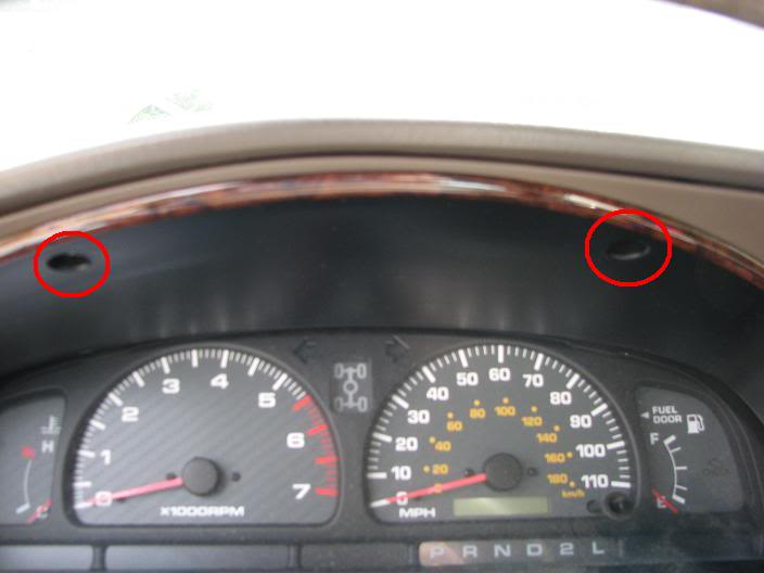

5) Remove the 4 screws holding the gauge cluster in place
IMG_4895_25.jpg~original

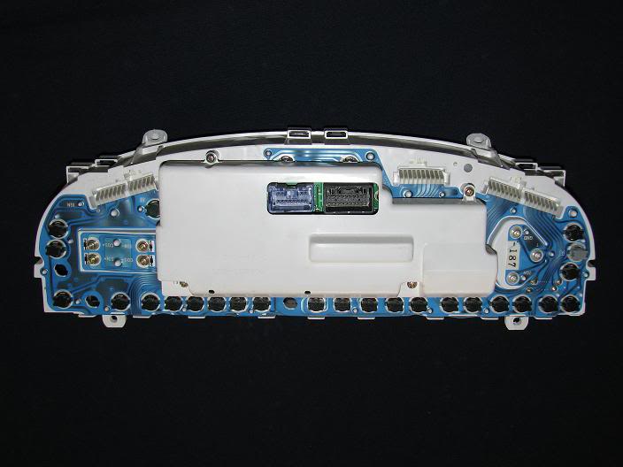

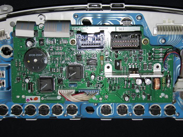

6) Start pulling out the electrical connections going into the back of the gauge cluster. Now you can remove the whole thing and change burned out bulbs, switch to leds, etc.
IMG_0920_25.jpg~original
IMG_0921_25.jpg~original

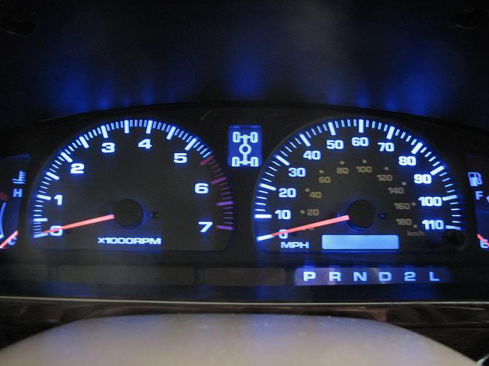

2002 LED Interior Light List
Shifter: 74
Digital Climate Control: 2 - neowedge type A (3mm), 2 - type B (4mm)
Defrost/ECT: neowedge type A
Rear window: neowedge type A
Ash Tray: 74
Key Ring: 74
Map Lights: 2 - Ba9
Domes: 2 - Festoons
Glove box: 74
Vanity: 2 - 31mm fuse bulb
Not positive on the following but pretty sure:
Gauge Illumination: 3 - 24's
4WD: 3 - neowedge Type B
All other gauge lights: 74's
Blinkers: 2 - 74
A note on the digital climate control: There are one (probably two) lights that I didn't try to get to. They are soldered. One light is the fresh/recycle air button and I believe there is another similar button on the upper right.
Power window, security, passenger seatbelt lights are all soldered.

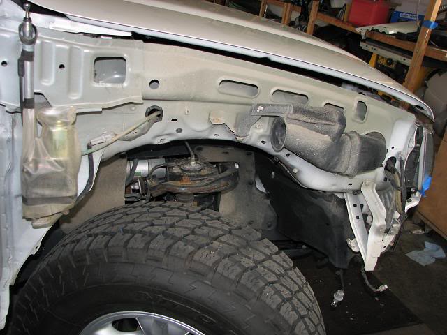

1) Remove grille, front bumper, running board, and headlight filler. If you are doing the passenger side remove the antenna nut and collar too.
2) Remove splash guard clips. Some you can access from the engine bay and push out through the fender. There is at least 1 closer to the cabin that you might as well break.
IMG_3919_25.jpg~original

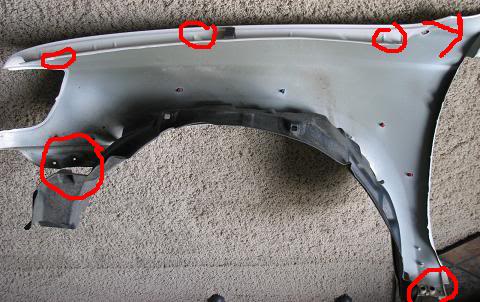

3) Remove bolts. Most, if not all, are located where the circles are in the picture below.
- 3 bolts along the top of the fender
- 1 that was hidden behind the headlight filler (not pictured)
- 1 or two somewhere down and to the left of the headlight filler bolt
- 2 that were hidden behind the running board (good luck not breaking those)
- 1 below the side mirror (you can see it if you open the front door) Special note: The tab that this bolt goes into wants to rub up against the front door when you pull it off. Wrap that area of the front door with blue painter’s tape and then duct tape over that to be safe. I also put some tape over the lower outside corner of the headlight too.

4) Carefully remove the fender

2) Remove 2 clips from the passenger side wheel well splash guard so you can access the engine drain.

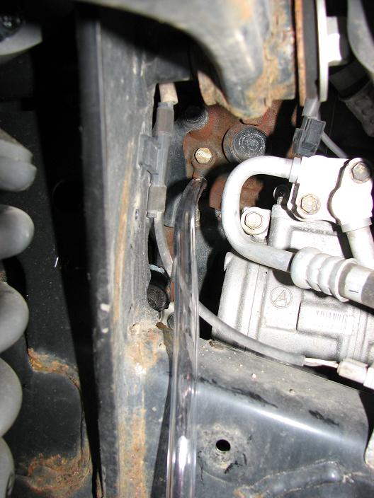

3) Directly through the opening is the drain. Slip your 5/16” I.D. tubing over the drain hole and down to a 5 gallon bucket. Place the bucket right under the radiator stopcock.
4) Use a 12mm deep socket, about 18” of extension bars and a ratchet to loosen up the drain bolt. If your socket is slipping off make sure the extensions are pretty much pushed up against the underside of the upper control arm to give you the best angle. Loosen the bolt until coolant flows through the tubing (tubing is not in place in this picture). Another option is to skip to step 5 first and the reservoir will drain itself through the radiator. Once the reservoir has been sucked dry, open up the engine drain in addition to the radiator drain.
IMG_5541_25.jpg~original

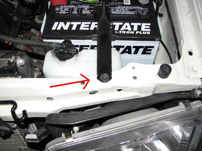

6) Time to clean out the coolant reservoir (in front of the battery). Remove the bracket holding the battery in place (12mm socket).
IMG_5542_25.jpg~original

13) Start up the car (radiator cap off) and check for any leaks. Also watch the coolant level drop in the radiator. Took me almost exactly 1 quart of the coolant/water to top off the radiator after starting the engine. Put the radiator cap back on. At this point everything should be back together unless I forgot something here.
14) After driving around recheck your reservoir and add more water/coolant if needed.
15) Put your old coolant into some closed containers and dispose of at a recycle center. Earth911.com

You can remove the cap earlier in the process like you said, but the coolant in the reservoir won't get pulled into the radiator while that's draining. If you leave the cap on, the reservoir will empty itself out through the radiator. Either way works fine, just comes down to personal preference.
Honestly, I didn't know that trick. But in your write-up as it stands the cap is never removed. The only reference is where you say to 'leave the cap off' in Step 9. At least, I've read it twice and that's all I saw. Is that what you meant? If it is supposed to stay on until then, I think you should state that earlier on just to be clear.
