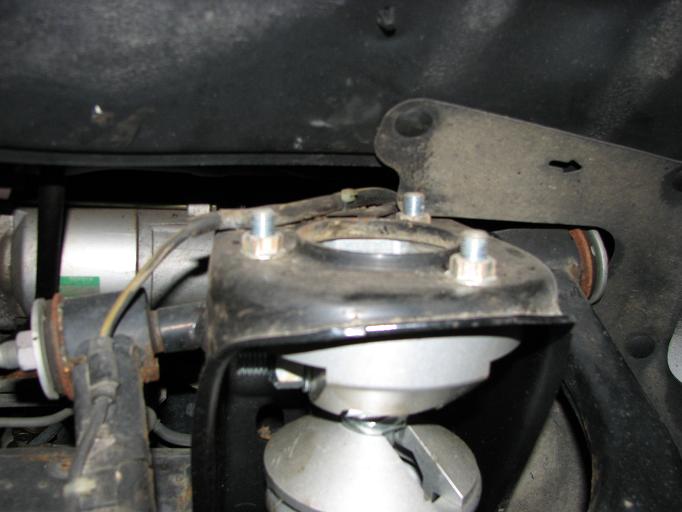

5) Remove lower shock bolt - 19mm socket and 19mm open ended wrench. Remove the three 14mm nuts at the top of the shock but do NOT remove the center nut (if you have a stock setup).
(Picture of lower bolt coming soon)
IMG_5670_30-CoiloverTopNuts.jpg~original

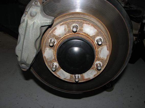

6) Remove the grease cap. I used a sharp, 1” wide chisel. Work your way around the grease cap and eventually it will pop off.
IMG_5615_25-GreaseCap.jpg~original

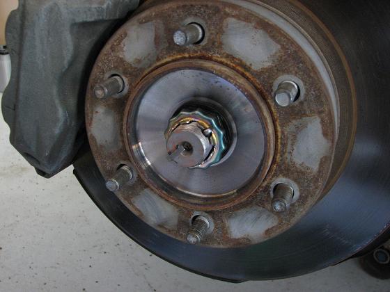

7) Remove cotter pin (needle nose pliers). Remove the lock cap (by hand). Loosen the lock nut. To loosen the lock nut, you need someone to press the brake pedal down while you loosen the nut (breaker bar, 1/2” to 3/4” adapter, 1 3/8” socket)
IMG_5624_35-AxleHub.jpg~original

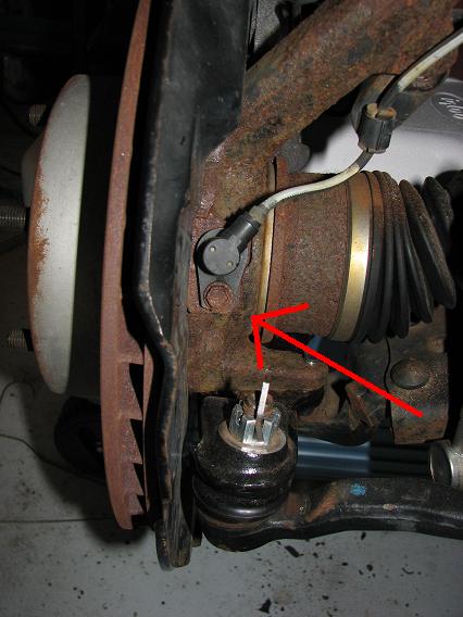

8) Remove the ABS speed sensor bracket from the knuckle (10mm socket)
IMG_5634_30-ABSBracket.jpg~original

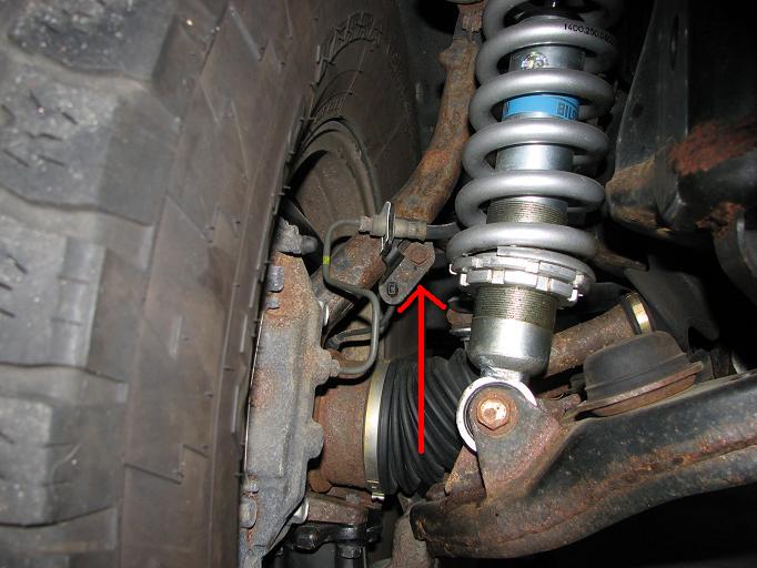

9) Remove the brake/ABS bracket from the knuckle (12mm socket). Picture is of the passenger side.
IMG_5667_30-BrakeBracket.jpg~original
10) Remove the ABS speed sensor from the knuckle (10mm socket). Once the bolt was removed I used a chisel to carefully pry the sensor out.
IMG_5640_25-ABSSensor.jpg~original

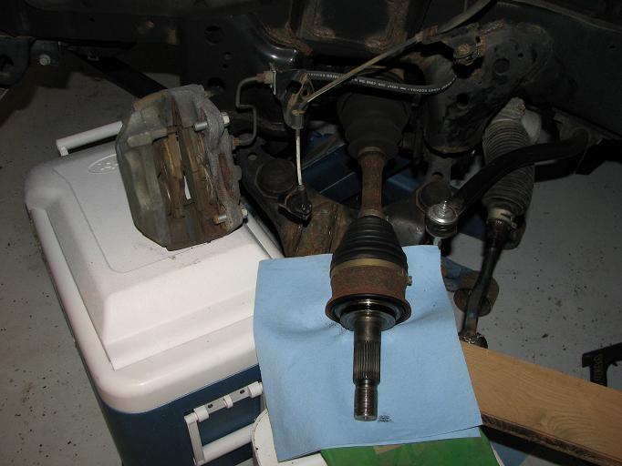

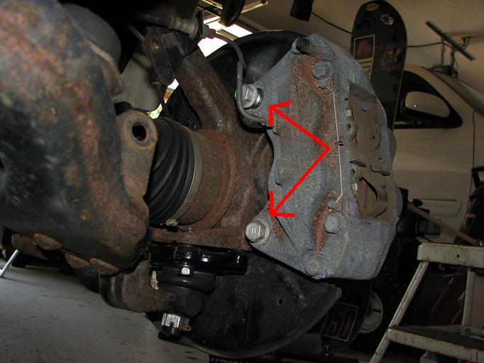

11) Remove the two caliper bolts (17mm socket). Be careful when pulling out the second bolt as the caliper is heavy and may fall on you. Mine was stuck in place pretty good so I didn’t have to worry about that. Use a metal hanger to hang the caliper (so you can avoid disconnecting the brake line) or have a box tall enough to rest the caliper on. I found my cooler did the job.
IMG_5637_30-Caliper.jpg~original
Cooler in action (picture taken after everything was removed)
IMG_5666_30-Cooler.jpg~original

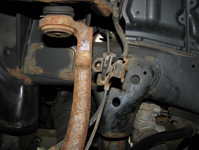

12) Remove the 4 lower ball joint bolts. Two of bolts are pictured here (leave the cotter pin and castle nut alone)
04-lowersuspensionarmcastlenut.jpg~original

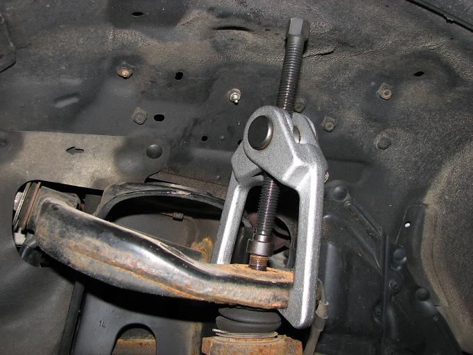

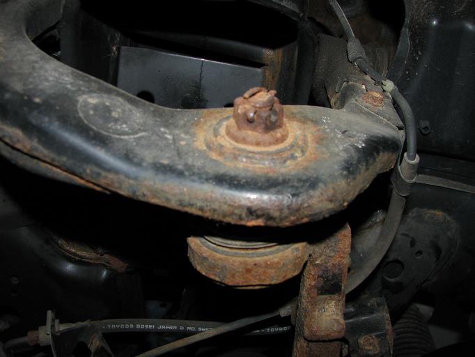

13) Separate the upper ball joint from the upper control arm. Remove the cotter pin and castle nut. Pop the upper ball joint free with a puller. I tightened the puller down some then hit the upper control arm lightly with a hammer. Get ready for a loud bang. Now the upper ball joint is separated from the upper control arm.
IMG_5651_30-UpperBallJoint.jpg~original
10-outertierodpuller.jpg~original
IMG_5657_30-UpperBallJointPuller.jpg~original

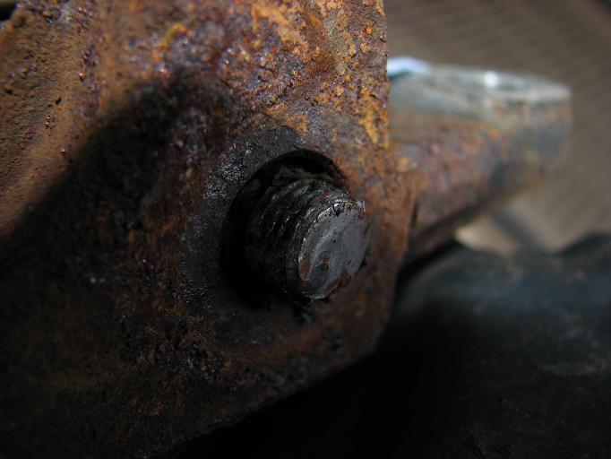

15) Finally, access to the broken ball joint bolt. Need anymore proof Toyota dealerships are no better than any other shop? I certainly don’t.
IMG_5661_30.jpg~original
