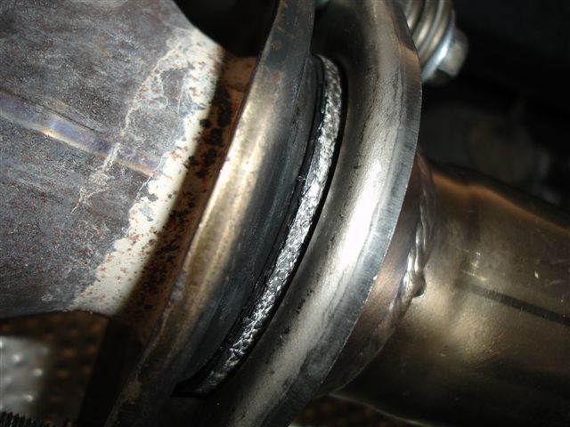

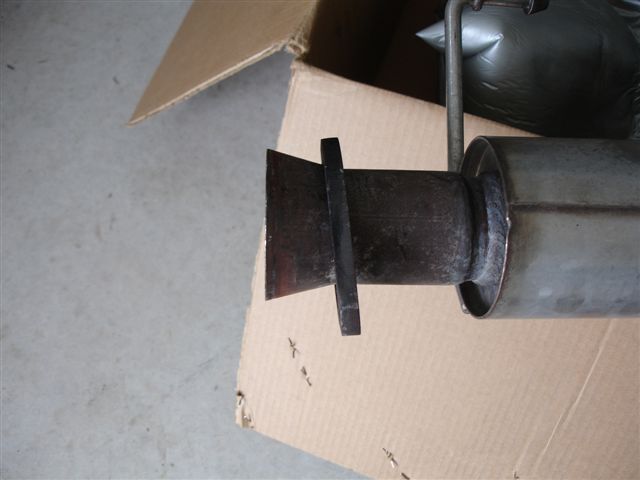

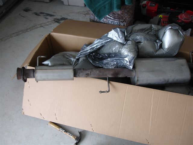

I contacted borla, they sent me a new muffler part, only thing I saw is that the clamp area was different. The old exhast had a plate (pics) that moved and would compress as you tightened it.
The new one did not have that moblie plate, it was fix top the muffler pipe.

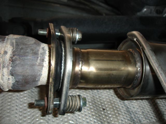

When I installed the new muffler pipe, the exhaust did not clamp fully to the Y pipe. It wouldn't even though the bolts are as tight as they will go, it still showed the gasket a bit.
Now when I turn on the truck, it smells like there is a fire. And the are area where the y pipe and muffler meet, gets really HOT, really fast.
I know that it is not sealed all the way, but that's as tight as it goes(pics).
here is the moving clamp/plate that the old muffler had.
You can see the white part is the gasket, inside.
I just tried something else. I took the gasket off and both ends of the clamp will come completely together, but when I run the 4r, I fel that there is air leaking ou through there. So even if they are flush, it really doesn't seal.
I would try to get another exhaust gasket from toyota and use 2 of them..see if that works, if not...I would have a serious chat with borla.
PS...Magnaflow Rules!
Call up Borla. Maybe they gave you the exhaust portion from the "newer" units that fit the 2005-2006 with XREAS. They may have made some slight adjustments that make the two portions incompatible...
