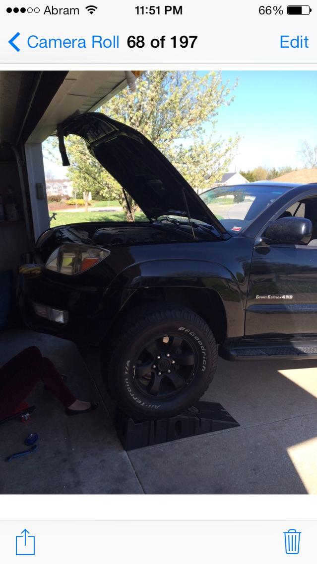

Hi all! Im a long time reader of the forum first time poster. I've searched relentlessly for answers to this problem but haven't found any threads. I have a 2005 4runner v6. I had a friend of mine who is a mechanic installed the cornfed 3/2 lift on it with no problems, and had it aligned right after by a reputable shop. Both of my front tires are wearing badly on the inside. Even with regular rotation. I'm told the camber can't be adjusted anymore. Could the xreas be bad and just replacing the shocks fix the problem. Anyone else had this problem? Also I have 285/70/17 bf Goodrich all terrains on it if that helps. Thank you all for the help. I'll post some crappy pics i have of it and get some better ones on when its light out.
Best photo I have at the moment.
