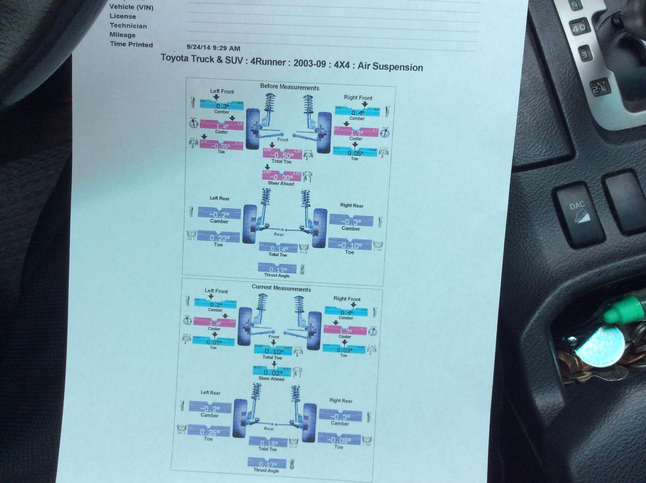

Here's the spec sheet
Yikes!!!!!!! That was some serious negative toe! No wonder they were wearing on the inside edge. How many miles since you installed the lift? Caster looks a little low, but I am guessing it is probably maxed out from your lift.
Lift was put on a little over a year ago. I guess i didnt post a very specific timeline. Probably 15k miles. Started noticing the inside tire wear 4months ago but ive been working 6 days per week only off Sundays and barely any time to deal with it.
