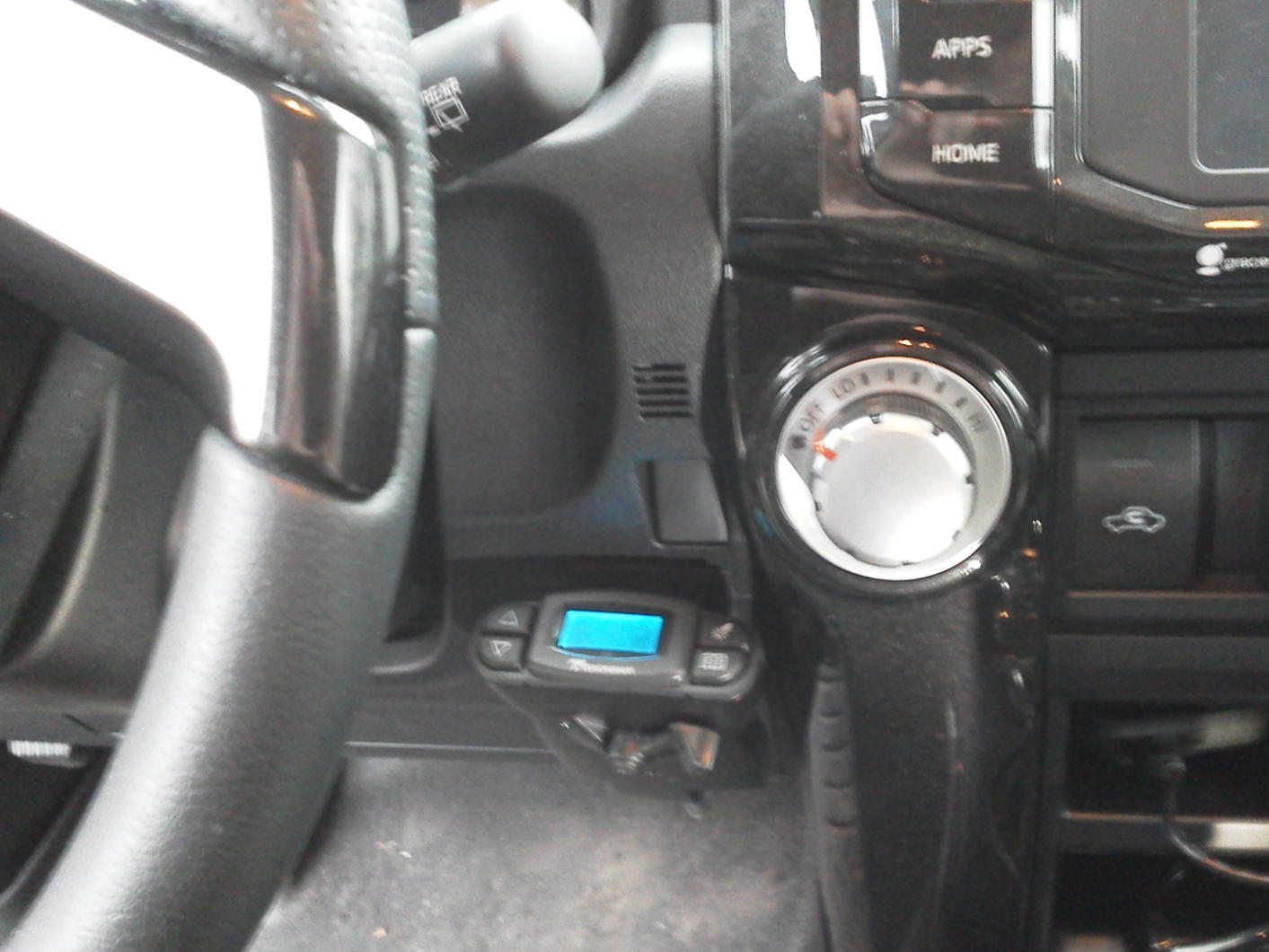

When I got the new truck, I also got a new P3...wiring was simple, and I mounted it this time so visibility was a bit better.
If you are using a Prodigy 2 or 3 they do not have to be mounted horizontal. I use Velcro and mount it to the area just to the right of the steering wheel.

Well I got the P3 installed this evg. Hung it near right knee under the steering area. Kinda tough, took some thinking.
But it worked straight up with my 2007 Chalet Arrowhead aframe camper. I pulled one hub to see what kind of condition the bearings and brake system looked like. Foresee changing the entire hub abd brake assemblies for new set soon. About 150 for all new gear, pretty cheap. After following directions I controller set at 9 power. Definitely helps and gives me confidence I can stop reasonably now.
